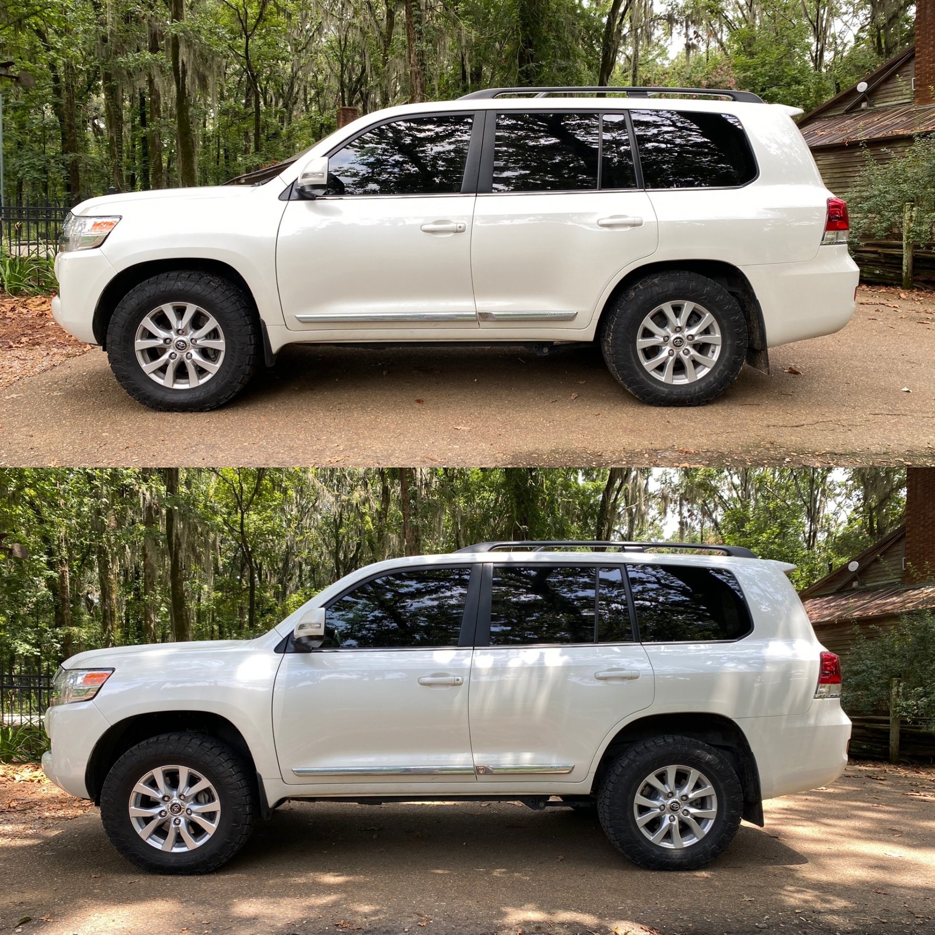

Dobinsons MRR install today.
Before measurement to the bottom center of the fenders
2” coil overs in the front to keep stock control arms.
1” springs in the rear.
Truck came up an even 3” all around. Really sits perfect now. 3/4” rake with mostly loaded drawers in the back and the hidden winch in the front.
I set the rebound dials to the recommended setting for the unloaded 200 and the ride is super nice. The little bit of wash I was getting on the front on big jumps (railroad tracks) is gone. Thanks @Ozark cruiser for nailing this setup for me.
Alignment and tires tomorrow.

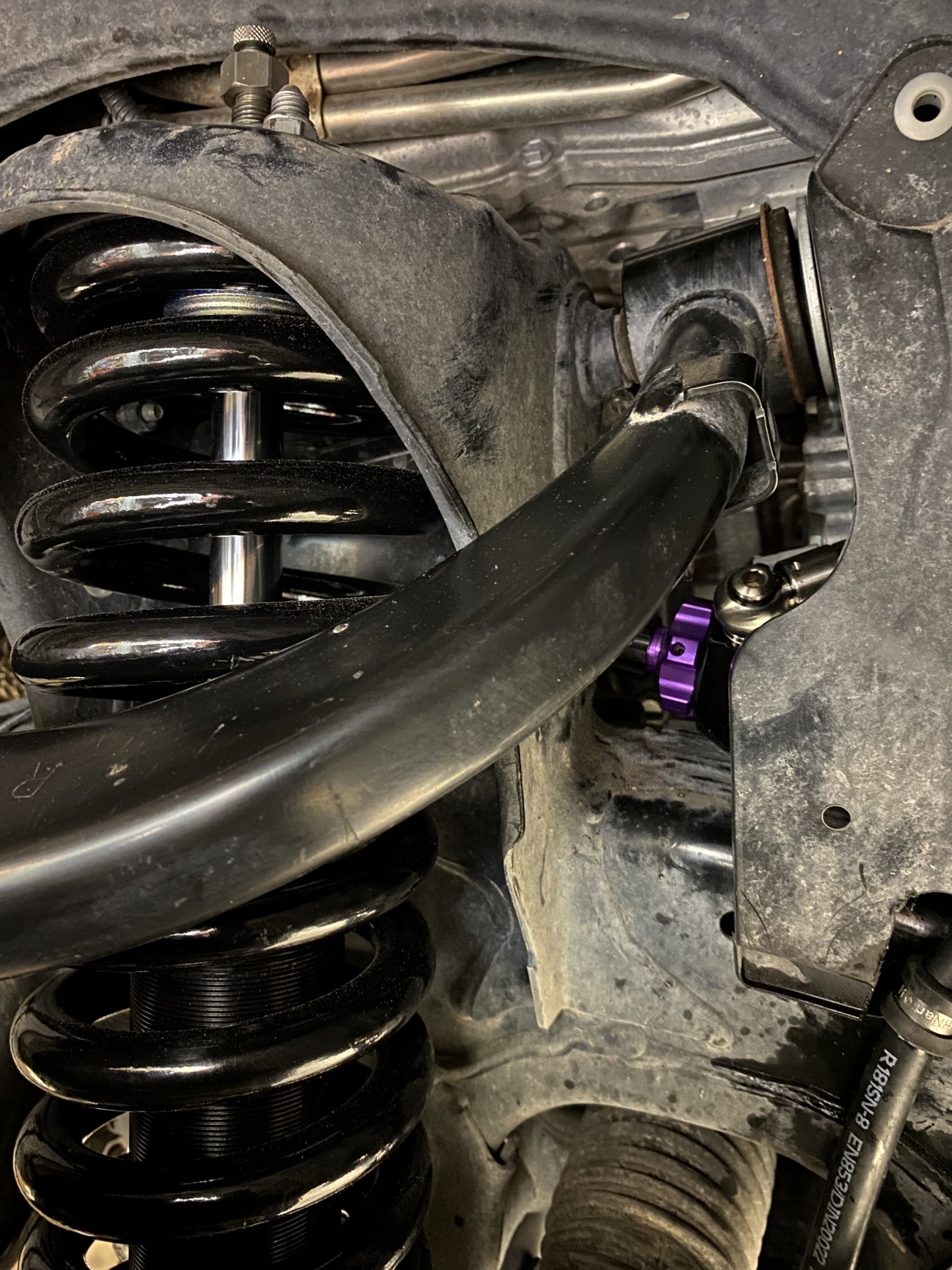

They are not as silent as they are on my 100 series but the tone is low growl versus a more high whine the Toyos had.
They rub on the passenger KDSS round bar at full turn in reverse both ways but not going forward.
