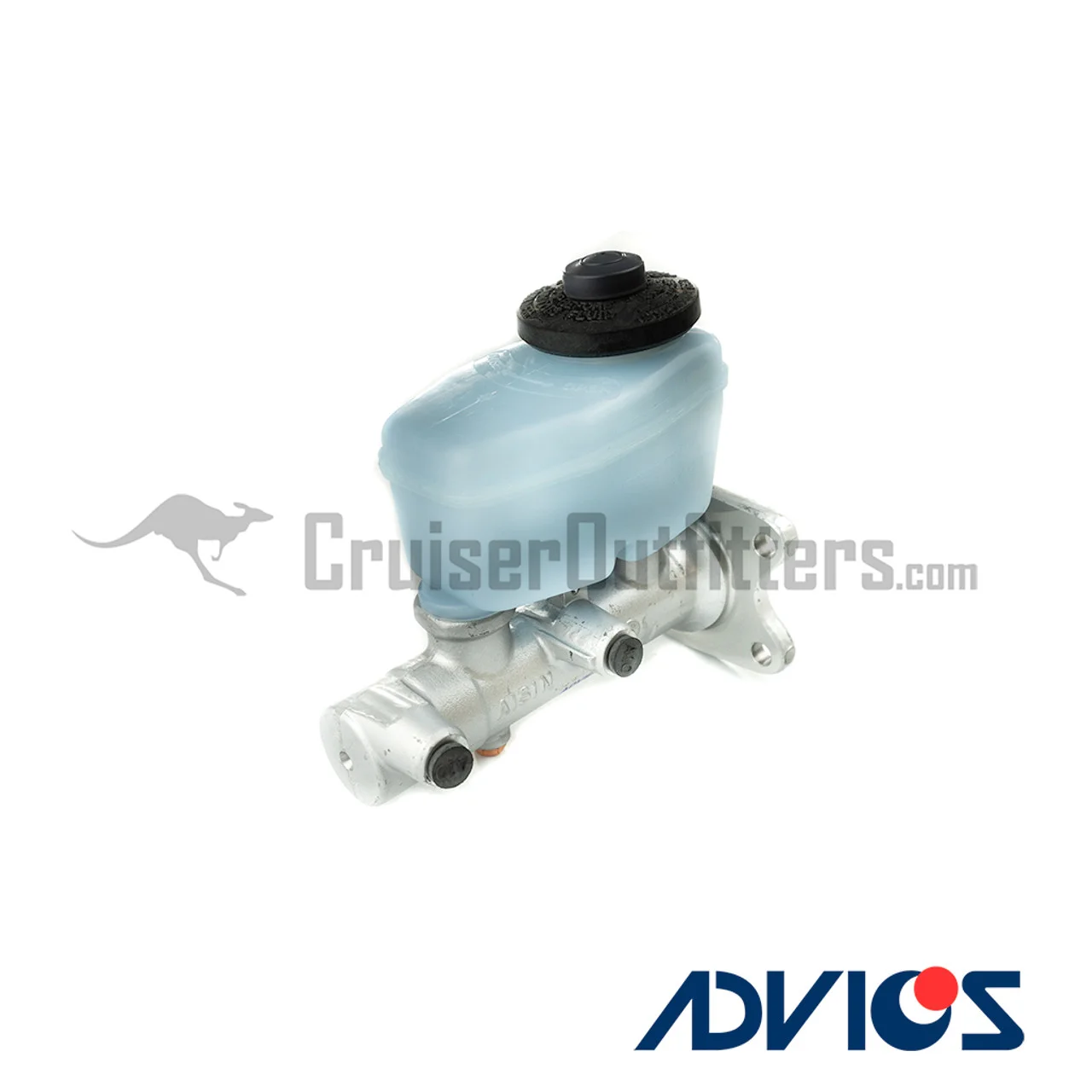

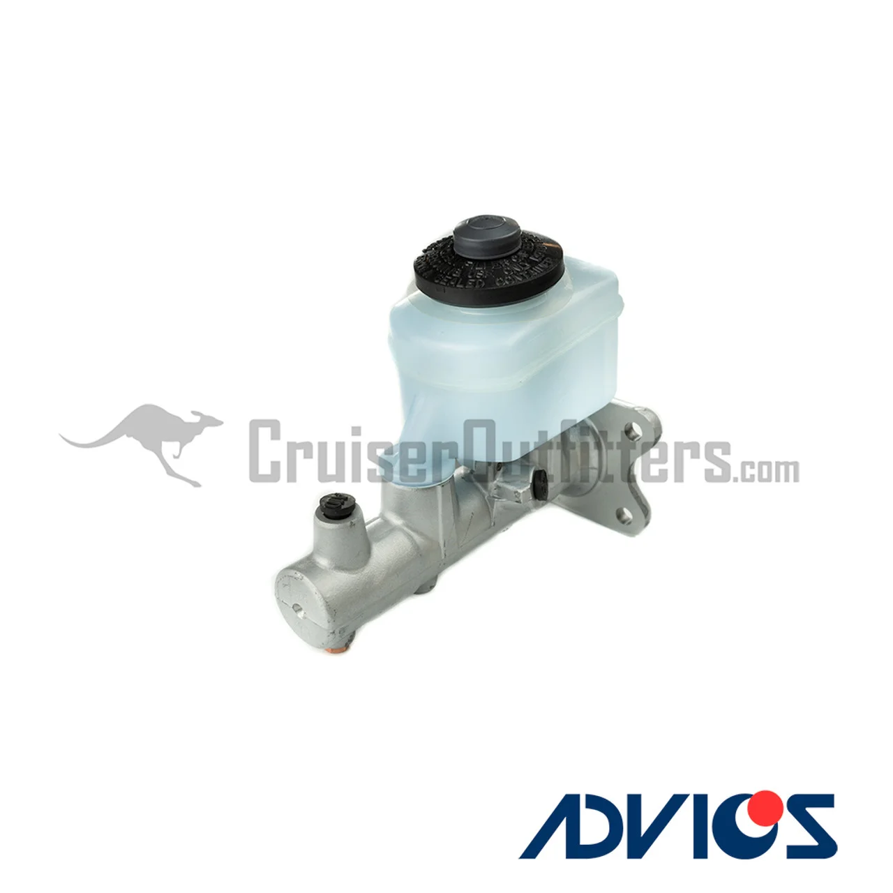

Nice, thanks Kurt!Sorry, still a ways down my list. Pretty crazy busy these days. Best I can offer is the photos on CruiserTeq.com, it's going to show you line orientation AND you should be able to see bore on most. For example 1-1/16" on the BKN34031N
DISCONTINUED - Brake Master Cylinder - Fits T-100 w/ 1-1/16" Bore Applications (BKN34031N) DISCONTINUED
DISCONTINUED - Brake Master Cylinder - Fits T-100 w/ 1-1/16" Bore Applications (BKN34031N) DISCONTINUEDcruiserteq.com
If there is a line orientation that would work for your custom application. Let me know our part# and I can quickly have the guys pull one and check diameter.

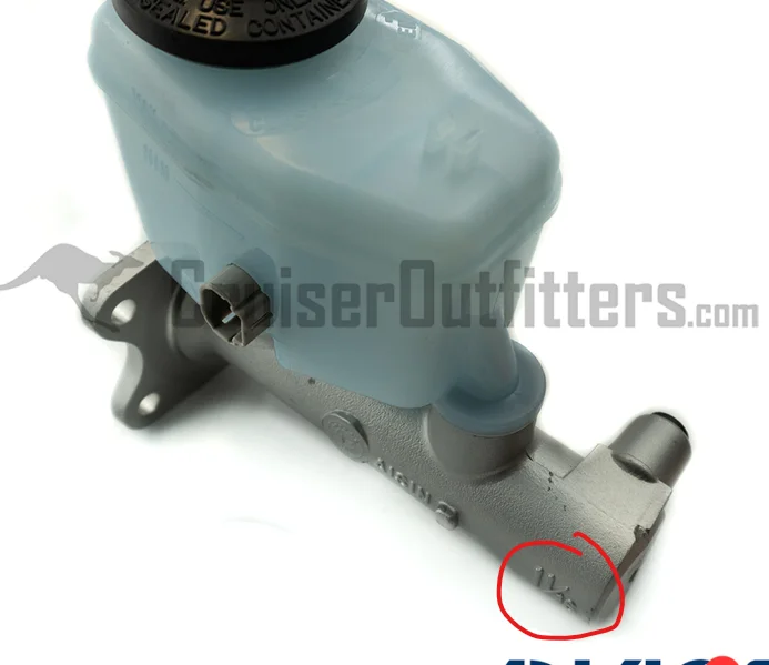

I don't remember the application, but I am sure I have the box at home I will check in the next day or two.
It should have a part #, it was an Aisin so probably BMT-###
Dyno
Thank you! I would love to have a p/n to look up and see what specs I can find on the unit...
Aisin Brake Master Cylinder Hilux Pickup - Hilux Surf
Level sensor in side of reservoir, manufactured by Aisin for Toyota, 15/16" borewww.roughtrax4x4.com
I think I used one from a 1984 HJ41 the link above shows some Hilux and Surf compatibility too. fit is indicated for 8/94-8/97 Hilux (non USA)
Brand: TOYOTA Part Number(s): 47201-3D161 ProductName: Master Cylinder Brakes
Cross Interchange Parts
Factory Number TRW PMK886 NIPPARTS N3102160 ASHUKI 0930-0612 AISIN BMT-145 BLUE PRINT ADT35114 PBR JB1956

Thanks, Kurt - you just made my decision to delete ABS much easier. (I do like that larger reservoir, however)View attachment 4007339
Handful of things including port configuration and sensor wiring/plug layout. Both are 1" bore
