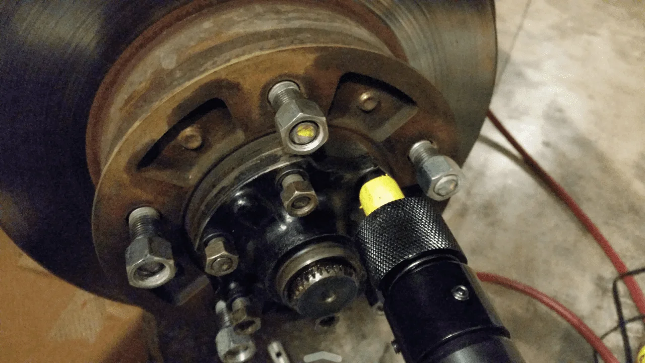

Hub flange removal writeup
Cone washer removal tool 10 sec. per side
No beating on the flange
No beating on the side of the flange
No need to remove the tire.
No worries on damaging the threads or anything else associated with cone washer removal.
Tool cost from HFT $10 with coupon.
Never have a cone washer problem ever again. View attachment 882121
Ok...I'll bite: Taken off my hub flanges more often than I have fingers and toes to count. So, if you don't mind, can you please expound on how you loosen the cone washers without a BFH, brass drift and repeated blows to the studs and/or flange?
Remove the nuts:doh:put the tool on the end of the stud and a quick trigger pull and you are done, used by master techs everywhere. Personally done 100's cone washer over the past 25years, never denied never any repercussions. Included my repair tools I carry in my Land Cruiser. ;)

What is this tool called at HFT?
Ok, so the new site mucked up my writeup...is there a chance this will still make it into the FAQ? I haven't seen it there...
tool> http://www.harborfreight.com/medium-barrel-air-hammer-with-chisel-61244.html
Cut the end of the chisel off slide on a piece hose and you are go to go
Phil is a genius. After the better part of Sunday afternoon tapping, both on flange and on stud with a 3 lbs hammer and brass bar, this took 30 seconds for both sides! And it's a 13.99 gun! They weren't rusted, just hadn't seen daylight in 15 years and weren't interested in changing that.
I cut the hose just long enough that it requires some pressure to compress it slightly and contact the stud. Phil's idea should be a FAQ.

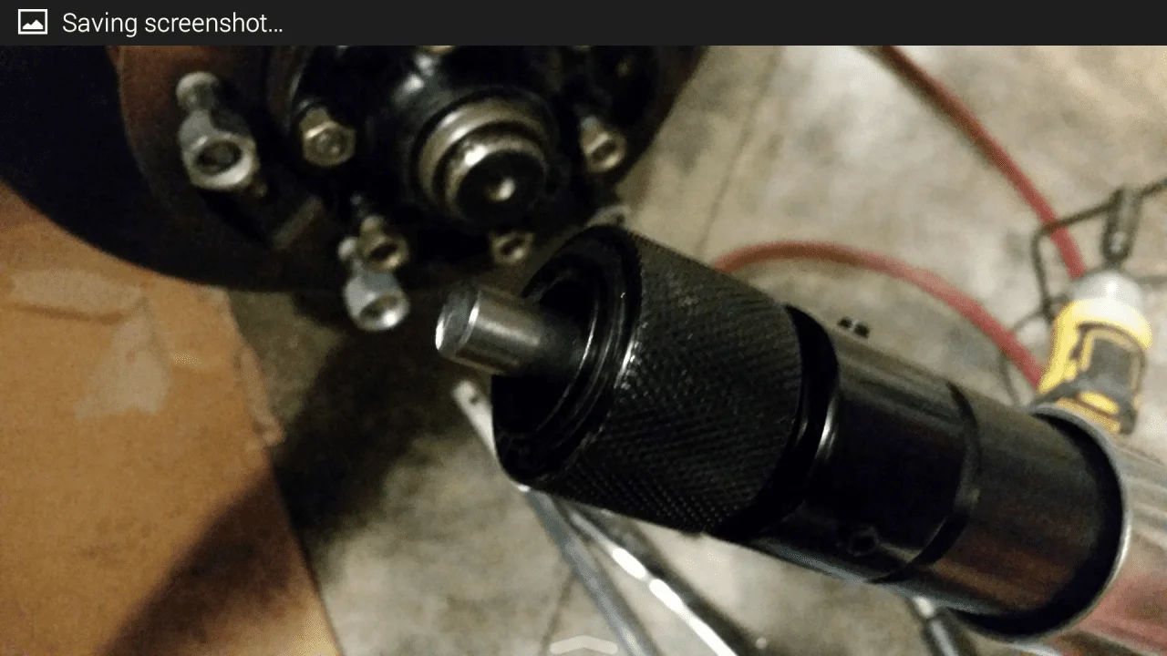

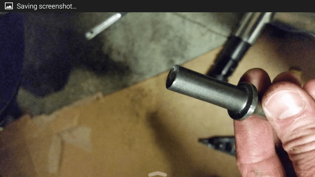

Sacrificed bit:
In tool:
With rubber hose to keep on stud:
In action:
