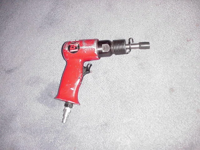

Cone washer removal tool 10 sec. per side
No beating on the flange
No beating on the side of the flange
No need to remove the tire.
No worries on damaging the threads or anything else associated with cone washer removal.
Tool cost from HFT $10 with coupon.
Never have a cone washer problem ever again.
