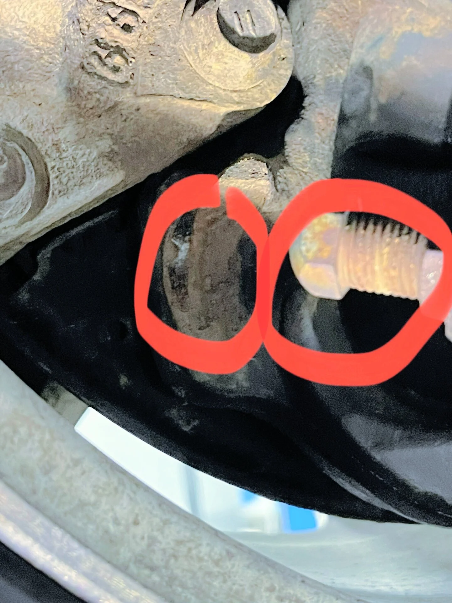

They sent me this pic and said this is where it's contacting. Any idea of how to fix this issue other than slapping some grease on it ? Is that normal procedure ?
I believe those adjusters are as far out as possible.
It was suggested that we tighten them down enough so it doesn't contact anymore but Toyota warned me the rack might over extend . Is that possible ? When I first bought that truck it didn't even have those stoppers installed , I put them in and just kept the at their max adjustment ..
I've never had an issue until the steering rack swap. They assure me the rack is centered and everything was torqued down properly, which I agree now that I've seen the issue.
I'm not sure what to do. any ideas ? If we just snug that stopper down enough to not contact could that stress the rack out for any reason ?

The pic they sent me does look like it's got some contact marks that didn't exist before so I suppose thats the culprit. But idk how to fix the problem

In my case , I can see the wear marks on the stopper and can see where it is contacting.
Now to figure out how to solve it. My guess is rack not centered or torsion bar cross level not set right .

Anyone out there have a pic of where the stoppers are set on your rig / proper procedure to set those ? I'm wondering if maybe I can get away with just sucking them in another inch or so with the hopes it clears whatever it's hitting .
The intent of the limiters (stoppers) is to limit how far the steering assembly is able to turn. At full lock with the limiters either removed or fulling screwed in, you will get a straining pump noise. I believe the FSM has a procedure for adjusting the limiters out to a point where at full lock the straining noise is not occurring. While it is possible that these could cause a noise when you are at full lock, they should not be engaged at any other time.

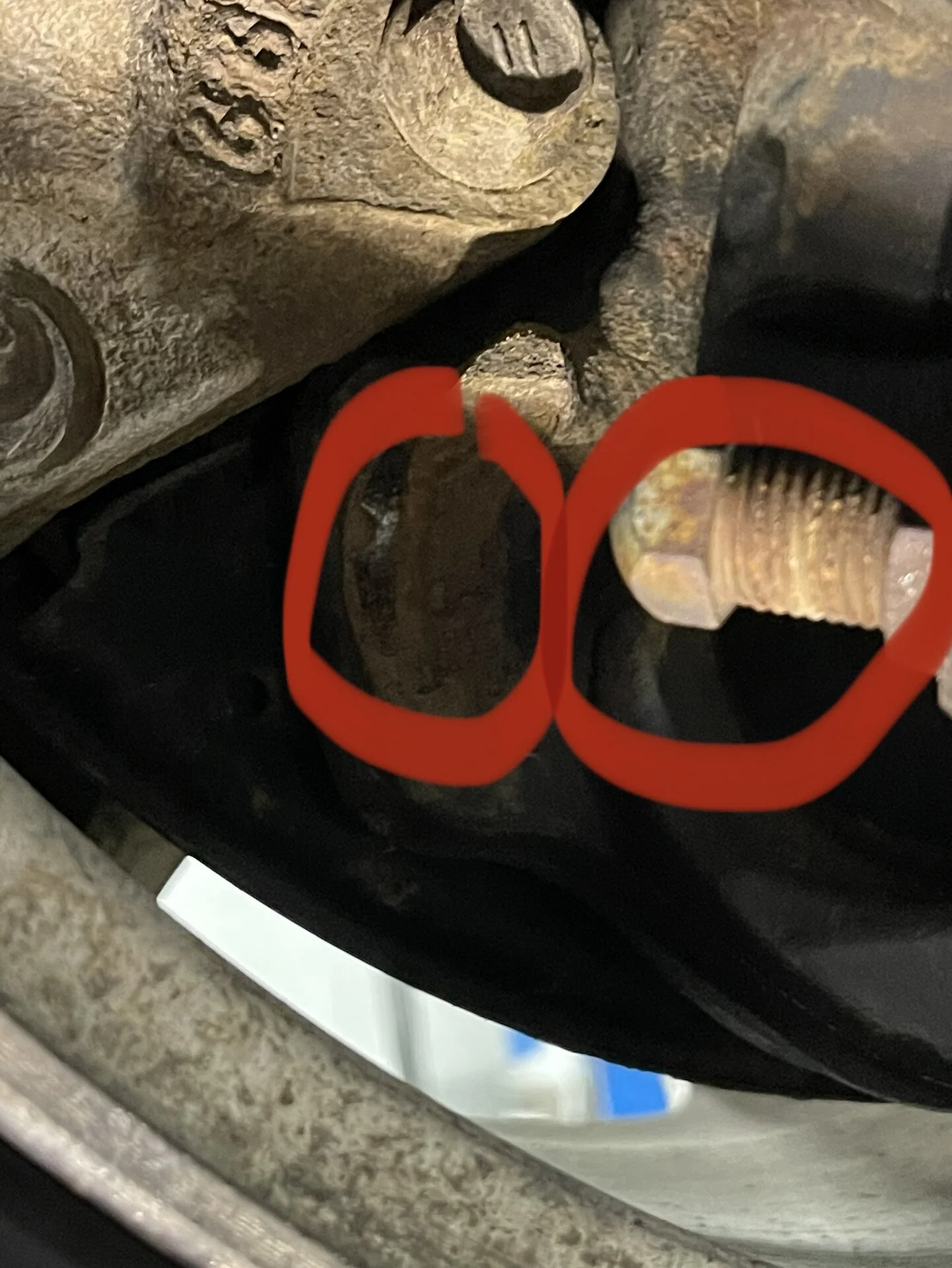

Maybe this will help, I tweaked the color a bit and you can see it better. It supposed to contact flush and kind of hit that flat part of the metal. But for some reason you can see to the left of that circle it's getting snagged up and starting to chip away at the metal only after a few turns.
Something is seemingly a few degrees off and it's not lining up right , it's like an inch or two off from where it should contact. Hard to accept " just grease it " as a solution . Any ideas ? I begged the alignment guy today to take another look .....
