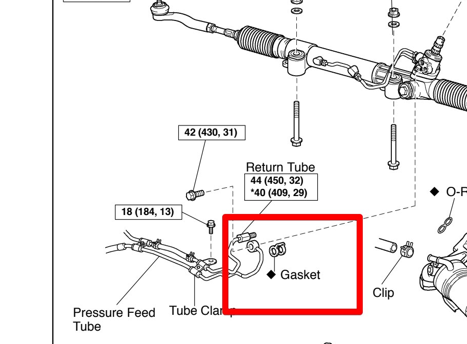

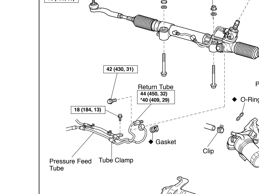

Amazing thread! Thank you all. Looking at jumping into this shortly but cannot find the part number for the below. Does anyone have the PN handy?
