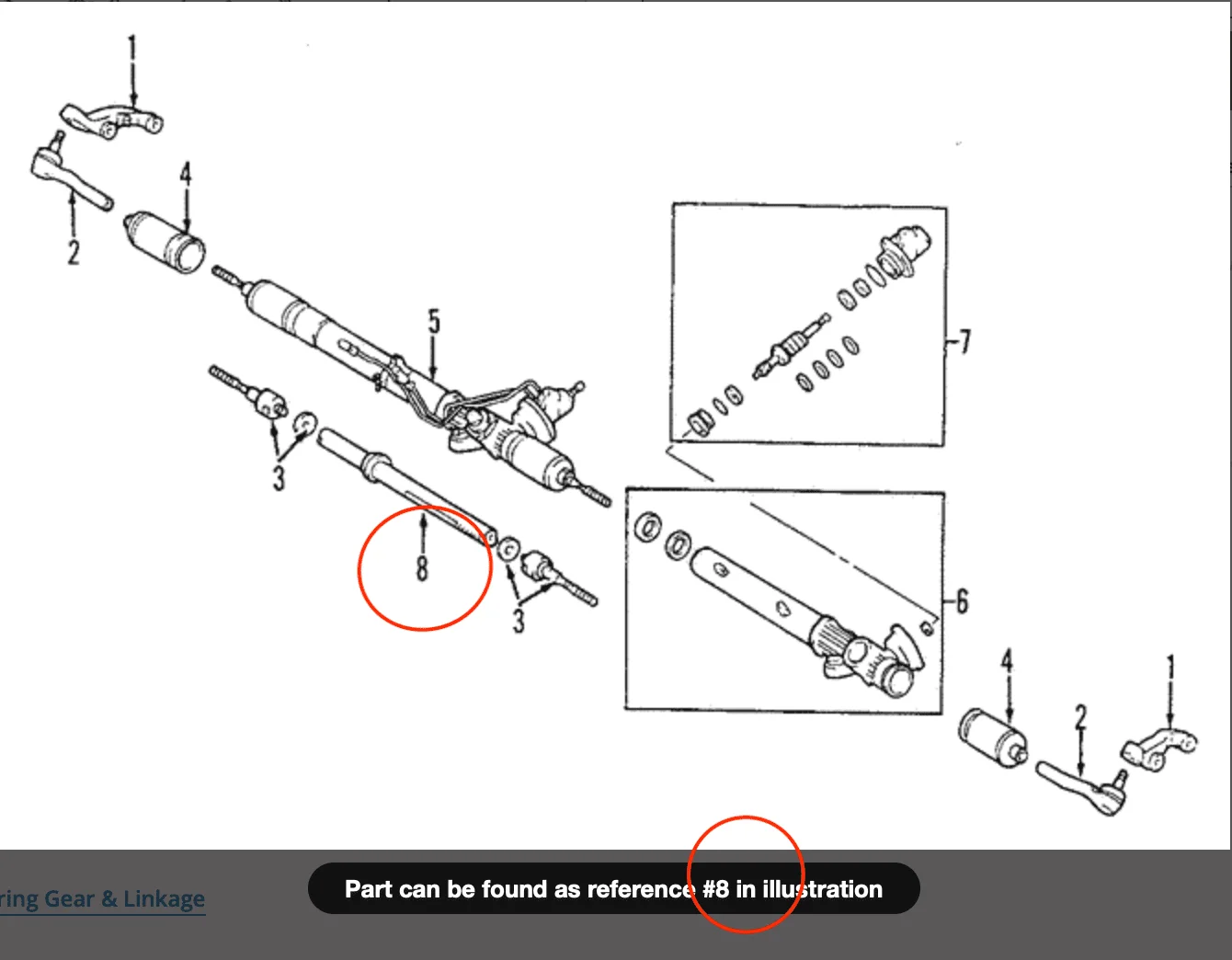

Also, it looks like the R&P is on sale for $312...I just paid $475 😥
Don't feel bad.... you would certainly feel worse if you ordered that part...

Too much play on driver side linkage of rack, could not align wheels.
I have a 2000 LC and think these numbers are good thru 2002
44250-60050 - new rack
90178-14003 - need 2 lock nuts
90105-14121 - need 2 lock bolts
44327-30030 – 1 gasket for banjo fitting PS fluid line.
Super Pro urethane rack mounting bushings - SPF2470K
