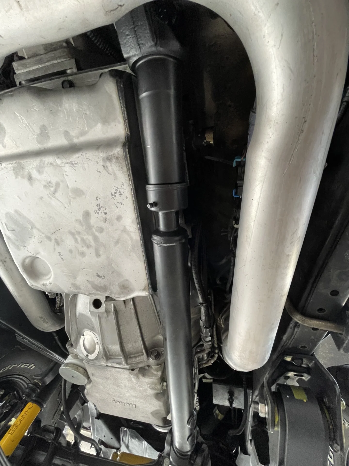

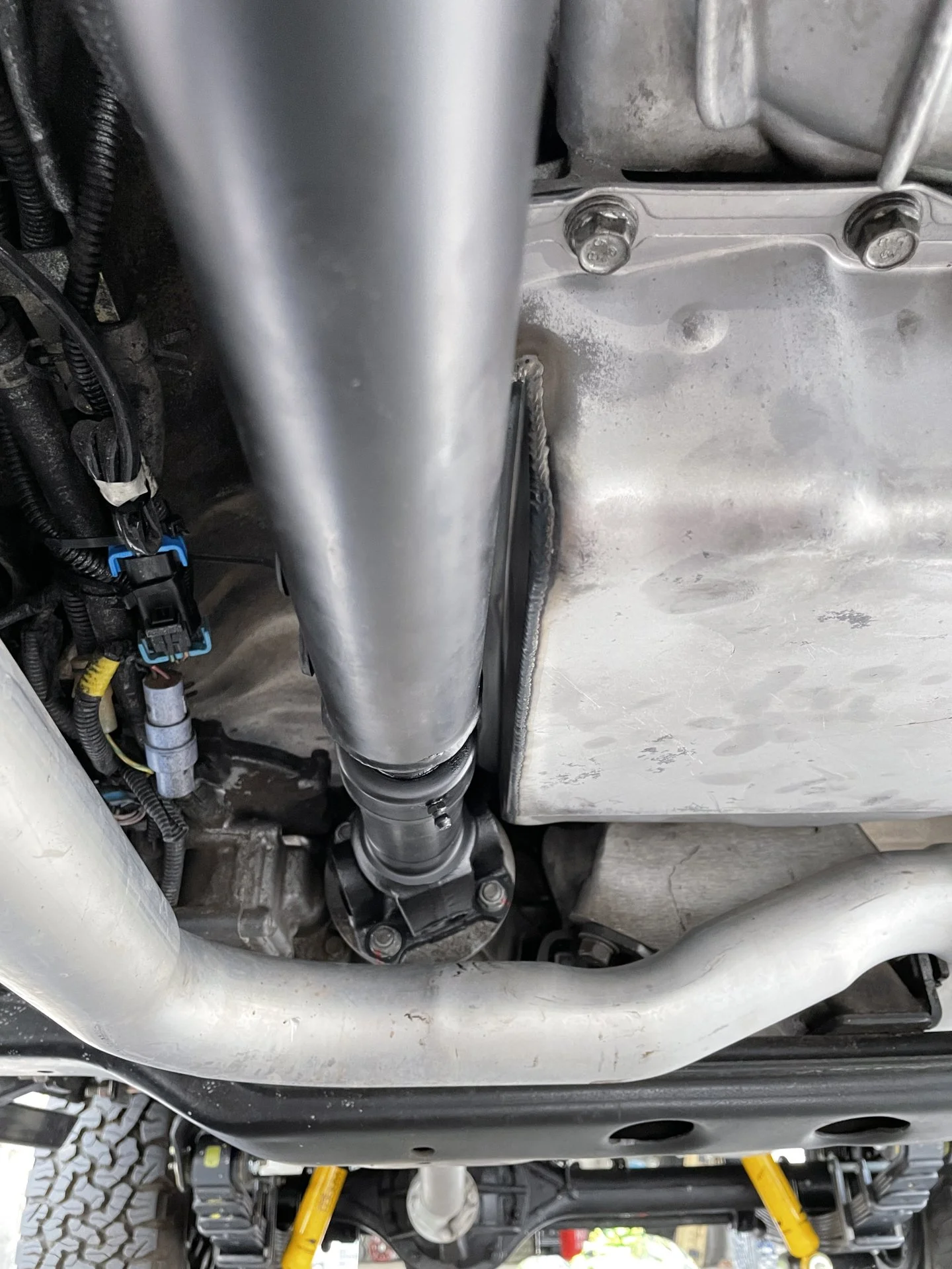

If you used a 4l60e or similar, the transmission oil pan is pretty wide. Youll notice pretty quick if you tried to put your stock front driveshaft on there its not going to fit. Theres two things you need to do to fix this.
First is driveshafts. You can either re use your yokes and ends of your current driveshafts, or just have new ones made. If you are not doing the driveshaft rebuild locally, shipping 2 ways on driveshafts makes the price creep up to getting new ones, but choose whichever you want.
Either way your front driveshaft needs to be longer and your rear needs to be shorter.
For the front you will need to use 2 inch thickwall tubing for your new driveshaft tube. The fj60 yokes will fit barely. If you want even more clearance you can use the smaller spicer yokes.
I used a company called JE REEL out of california and they built me some great new driveshafts that were pretty affordable for what they are. My front is OEM FJ60 driveshaft ends with matsuba ujoints, with 2 inch thickwall tubing. The rear shaft is standard size tubing but also thickwall and uses superduty ujoints and fabricated flanges. These ujoints are much larger than the factory toyota ones.
When you call them, they can tell you what you need to measure for length, and make sure you measure your output flange holes. There are a few different types of spacing for these output flanges and you want to make sure they get them right and they match up to whichever output flanges you have. This is super important. Also theyll balance your rear driveshaft, but spend the extra money to get your front driveshaft balanced.
You dont have to use JE Reel, but they make good stuff and were recommended to me by woody here and compared to my old shafts these are much stouter. They got me these driveshafts in like 4 days in the peak of covid shipping delays.
Now even if you are using the stock pan, these driveshafts will work and give you clearance, barely. You put your motor spaced over to the drivers side with your motor mounts for this very reason. I had to take the grease zerk off of the front driveshaft yoke and put a flat plug on there to get a little extra clearance for the zerk on the corner. Its tight.
This is my trans pan with the Dorman steel trans pan replacement with the better drain plug:
A lot of people will dent in the actual pan for the transmission to gain more clearance. I would recommend against doing this because you have no real way of controlling how far you dent the pan in. Plus you are dropping all this dough on a swap and want it to look nice right? The other thing is if you dent the pan in too far, the transmission wont operate right. For example, the corner of the pan that is closest to the front driveshaft that you would probably hammer, if you dent it in too far it wont shift into 2nd gear.
So if you dont want to dent your trans pan you can just notch your trans pan..... or just buy one already notched here. The jeep folks have already figured this issue out adapting Dana 300 transfer cases for their LS Swaps. This is really the best possible option for trans pan. It also has a drain plug thats lower than the bottom of the trans pan, unlike the stock drain plug so it actually drains all the fluid out. Im almost positive that this pan is the same dorman pan i have thats been notched.
Here are photos of @wester11 's 4l60e pan with a driveshaft made with 1310 yokes and the Novak notched trans pan I linked above. It pretty much is perfect. This would work with 60 yokes too...
