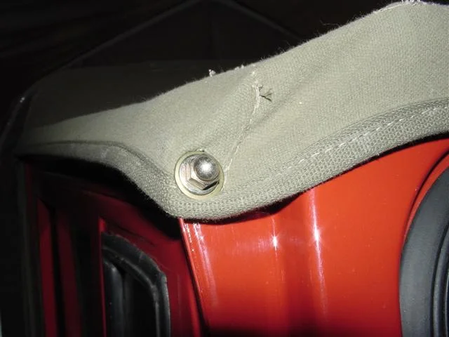

I've noticed that some OEM tops have a brass grommet in the front corners (grommet like a tarp grommet). All connected with a bolt with a dome head nut.
Any one got a picture of tarp grommet/ domehead nut configuration?
like this :) an acorn nut

Thanks,
Now that is clear is there a threaded scew hole up there on the windshield frame that the acorn nut screws into? If so what size acorn bolt do I need?
There is a hole there for attaching the hard top on mine. Regular 6mm bolt and nut I'd guess.
It has been a long time but I believe the hard top installed from the factory with a tapered phillips screw that went thru the top barcket and then thru the windshield with a acorn nut on it. At least that is how I remember my 68 was when I bought it in the seventies. Could probably check my 76. I don't believe that top has ever been off.
This way makes the most sense. That way the same hole as the hard top would be used with the soft top. Starting in the mid sixties FJ40s were set up to have either or. My after market tops all had the snap up by the glass just below where the hard top fits. But these were all aftermarket.
Yes, there is a tapered hole for the phillips screw on the back side and an acorn nut on the front. I know because I need to stop at the hardware store on my way home and pick up a pair. Putting the lid back on and didn't have any when I bought it.
