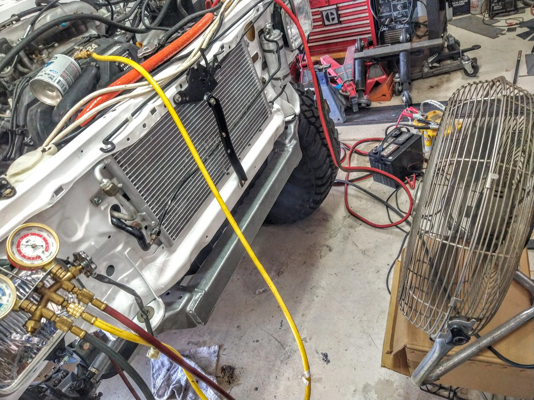

I also installed a parallel flow condenser this time and it did drop my high side pressure about 35 PSI from what I'm used to seeing when I'm charging the system.

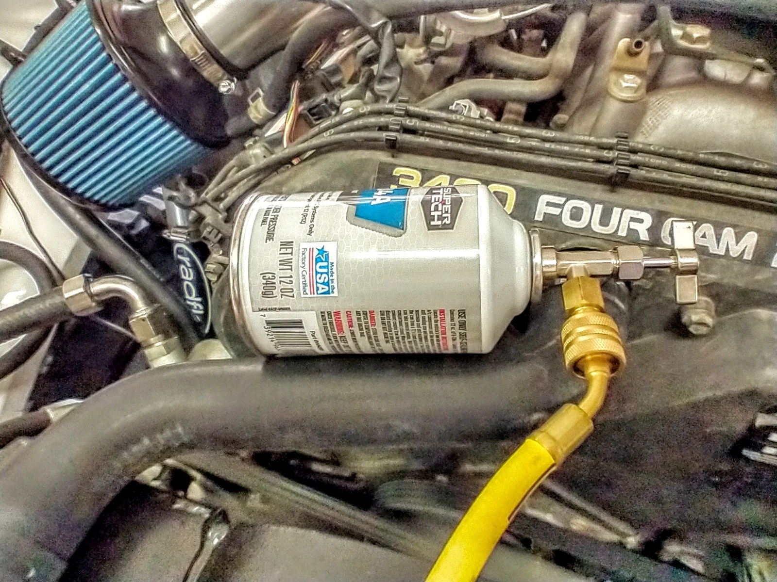

I only put in one 12 oz can of R134A and it's blowing cold. Based on my pressures, I could probably add a bit more but I don't bother since its cold enough to cycle off occasionally. It just bumps the pressure up for no noticable gain. (To me)
Since it's over 100 and I'm in my garage I put a fan in front of my radiator.
I didn't have to spray water on my condenser to get all the refrigerant in. I just set the can on the top hose to heat it up.

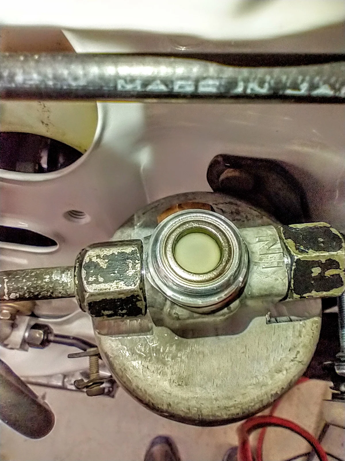

I took a pic of the sight glass. If this was R12 I'd add more until it flowed clear liquid. I don't even look at it with R134. Just my personal method for what it's worth. I hope it helps.

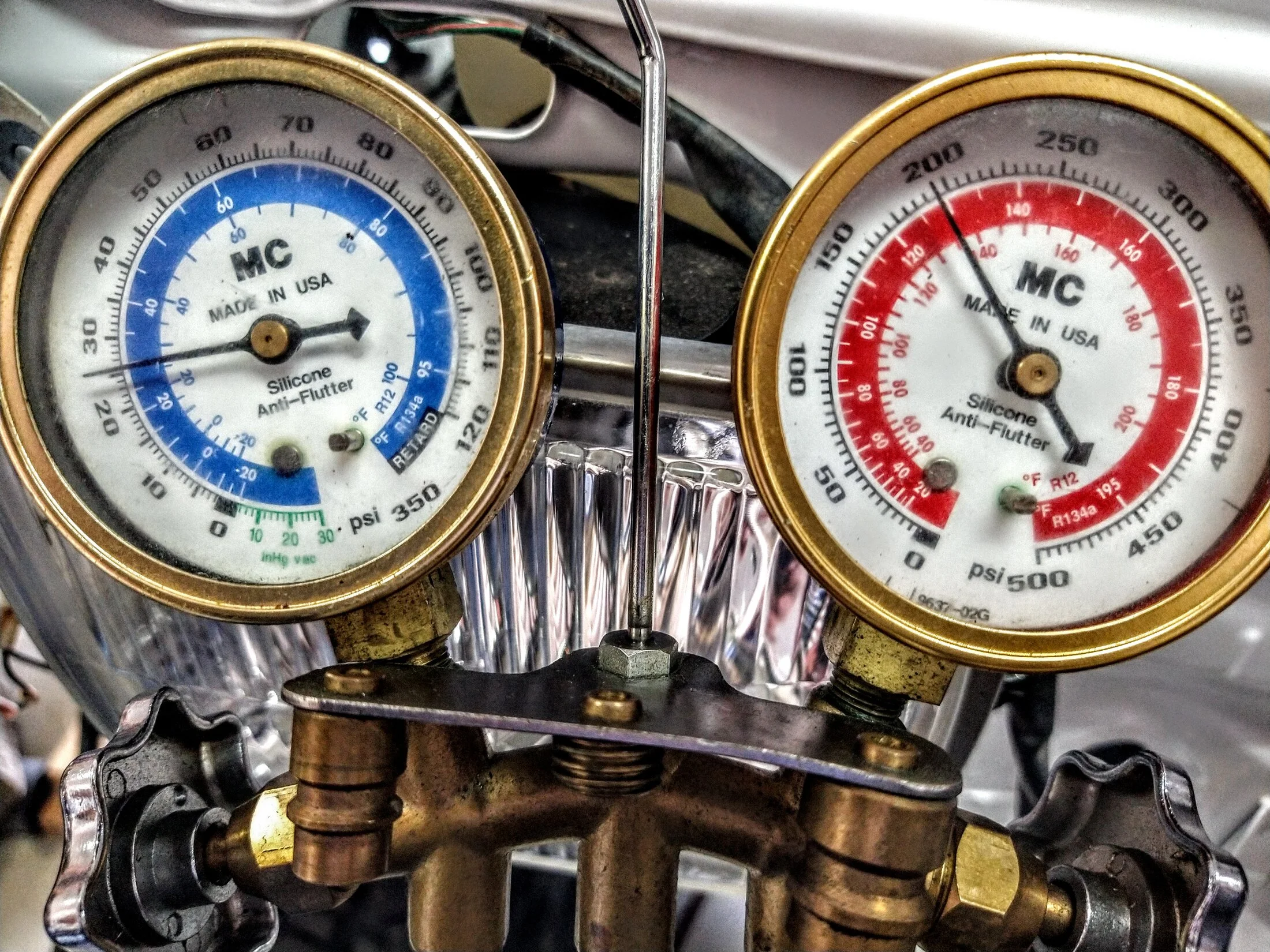

I decided to experiment with a little more refrigerant since I have another can in my toolbox.
Sorry I don't have more concrete data. I don't have a scale to use and I can't find my pocket thermometer.

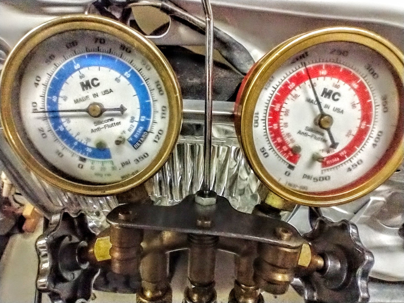

I added a "shot" that was just enough to raise the low side to 30 and the high side is steady at 200.
It feels colder for sure. The hose end that attaches to the evaporator is colder and sweating. I can see the needle on the low side gauge sweeping up and down a few PSI. The expansion is metering the flow.
I'm going to leave it here. If I had to guess at the charge volume, I'd say 14-16 oz. The second 12 oz can still feels pretty full.

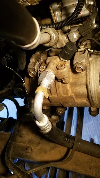

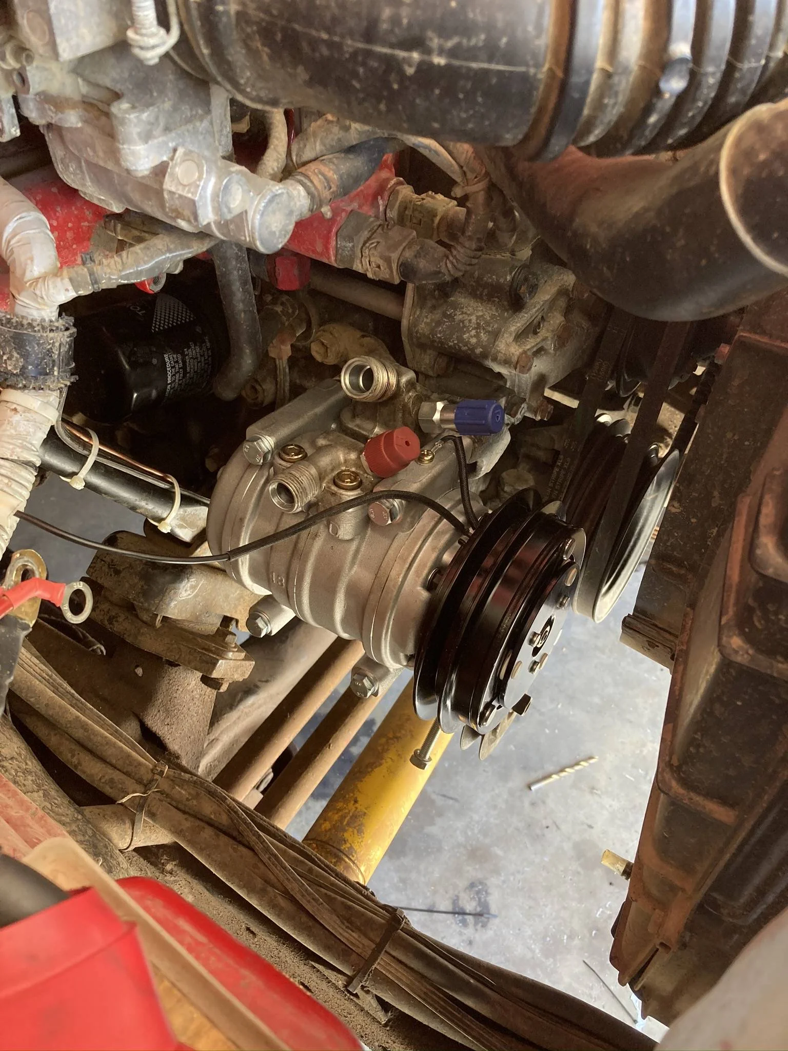

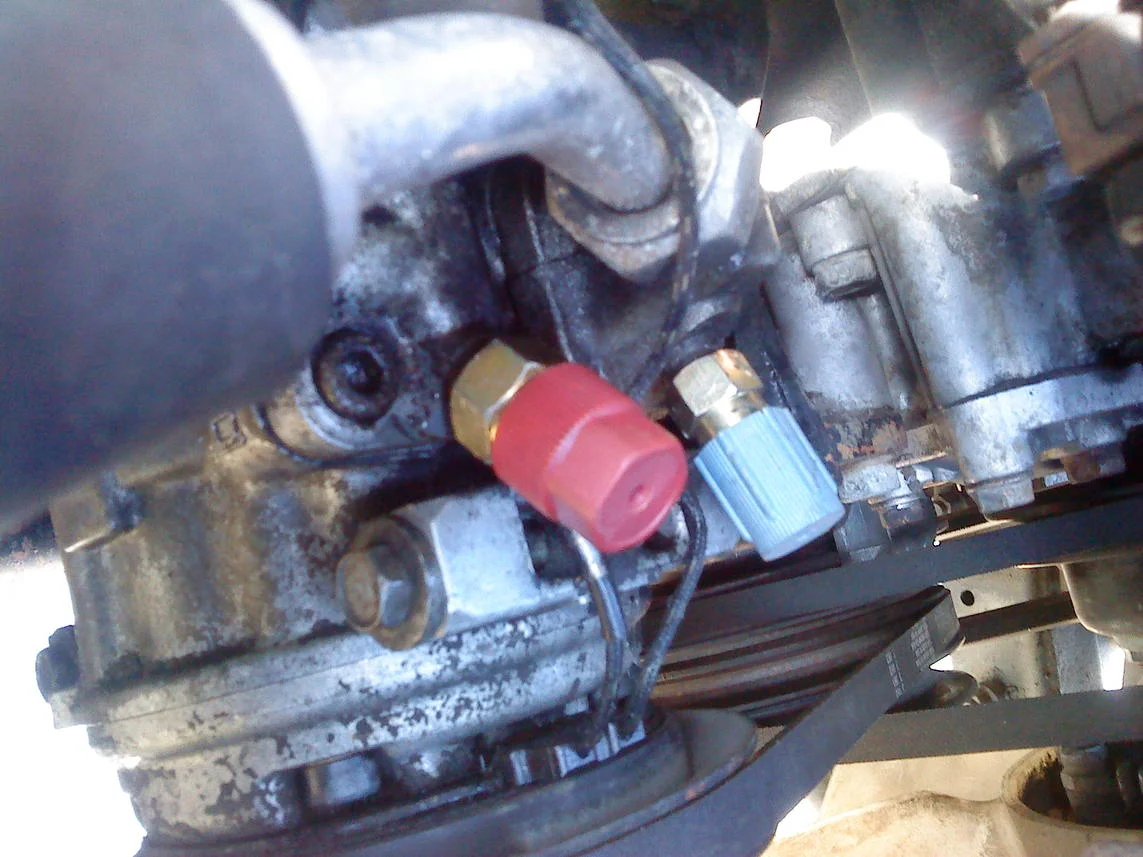

Can you take a photo of your compressor? Specifically your hookups? Just saw this post elsewhere https://www.toyota-4runner.org/classic-t4rs/68641-ac-conversion.html
Their connection look backwards to what I have seen others install as for the high and low sides. If this is correct I feel very stupid. Please confirm.
The larger diameter hose going to the evaporator is the low side. The high side is usually smaller diameter and goes forward to your condenser.
My 3.4 compressor does not have any charge ports so I had to have them in the hoses.

Was this with engine and ac running?
@braddamarlon , yes. I had it running to charge it. I add the charge a little at a time and let things stabilize. I don't just dump in what I expect the charge to be. My truck is not factory. It's been converted to 134, has a 3.4 swap, a parallel flow condenser and different length hoses. I charge to the point that it cools well and make sure the pressures are in acceptable ranges.
