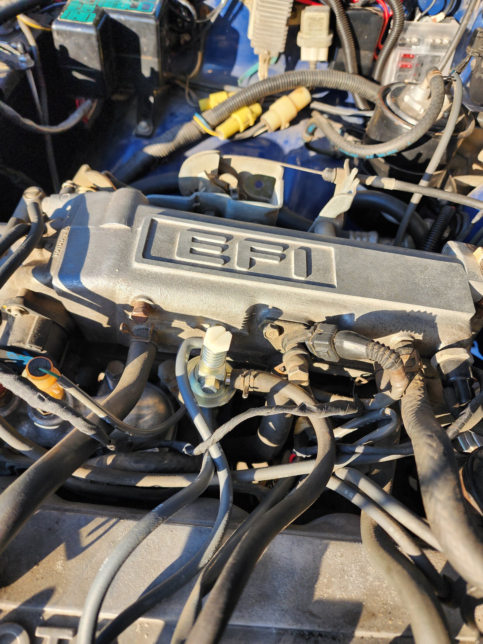

Can you give us a picture of the two vacuum hoses from the VSV to the diaphragm? Something tells me they might be backwards.
It was backwards before I believe and when ac was off it would hiss so I switched them. But I will take a pic. Also both vsv and diaphragm are oem new

Could someone please post what diaphragm you used part number and how you have it plugged in with the power steering because I can't seem to get my engine to idle up when the ac kicks on.
So this is how I have it set up. No matter how down or up I set the diaphragm it doesn't idle up. Am I doing it wrong? These are the parts I have on the truck. What could be my issue.

The hose going to the throttle body should have vacuum when the A/C idle up solenoid OR the P/S switch activates the valve, (If I'm remembering correctly) Try putting vacuum directly to the port on the throttle body. Bypass the valve and see if the idle speeds up.
I dont follow. Can you please explain as if I'm 5.
