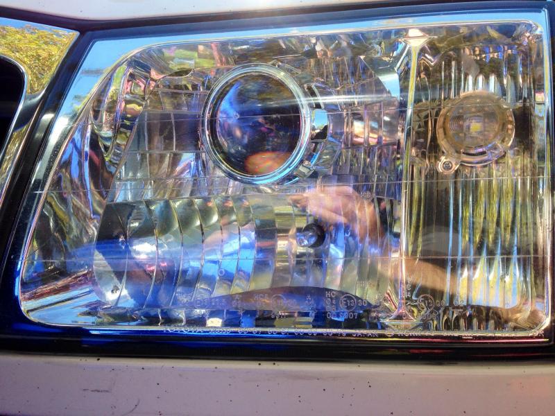

Great write up I just finished mine last night. I did a couple things differently, I didn't need to cut any of the original light socket, I had enough thread sticking out to put the nut on. I also used a slightly different and much less expensive retro kit I got off eBay. Either way the results are awesome, I will get some beam shots up tonight.

Looks good. So there is zero cutting the housing to fit these projectors? Thanks

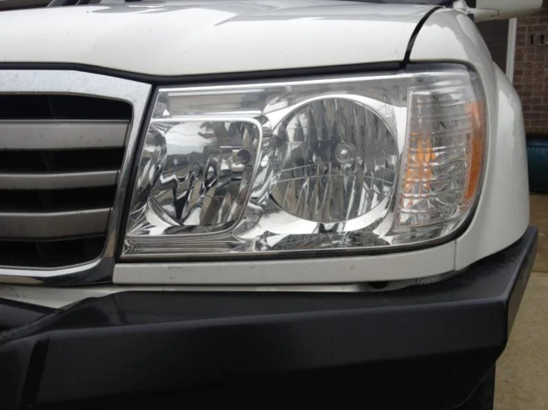

Some more pics:
Do you have plans (where you sourced which items, etc) to do any type of write up on this mod yet, CK? If you don't, I'm sure lots of us would appreciate one. Nothing like true HID. That pic of the projection and cut off looks solid! Great work! :-)
No I did not need to cut the housing, I did trim the bezel inside the lens to make sure there was enough vertical adjustment.
