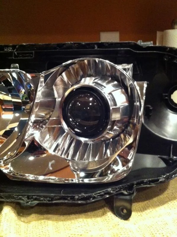

Well, I've got a OEM 98-02 headlight coming in the mail. I'm going to stuff this in there :) I will be making a vacuum table and making a totally custom shroud and one of a kind headlight for my truck.

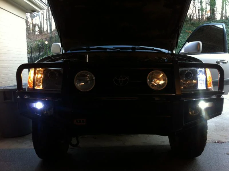

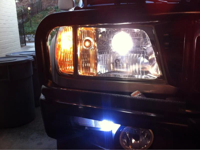

Did you upgrade yours to LED? I'd like it to either match the 4500k HID color or the color of the orange turn signal.
No, I replaced my LED's with halogens due to looks. It looked great with HID in factory housing. But my projectors are fully sealed it looks funny. I can take pictures if you want.
Use a warm white t10 led in that location
I've got a cheap $3 ebay set coming in. For some reason, that bulb on the passenger side keeps blowing out ever since I installed the relay harness two weeks ago. The harness nor any other wires are coming in contact with it.:hhmm: I've replaced the bulb twice only to have it immediately blow out. :confused: If the LEDs burn up, then I'll just unplugged the bulbs on both sides.

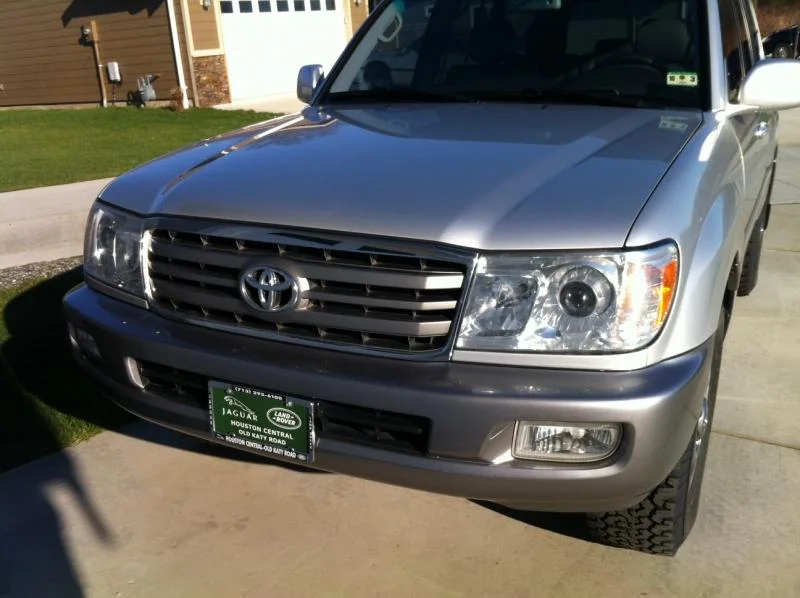

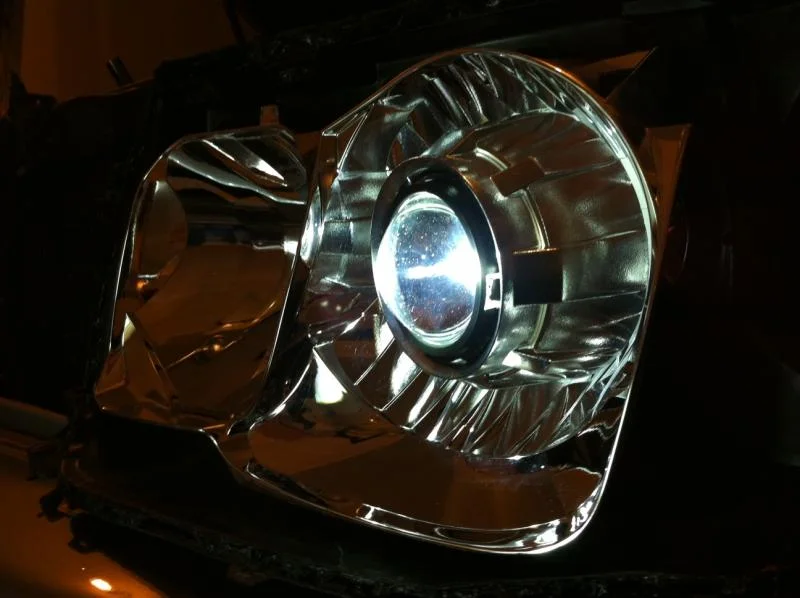

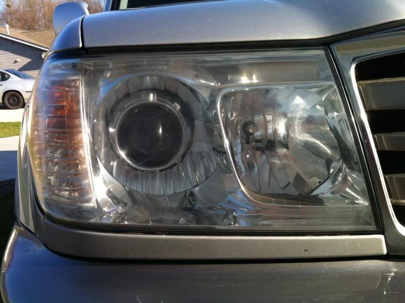

Finished my retro on my '06 LC
Had time on Monday to start my retro and she's all finished and aimed now. This is my third retro using TRS parts (Mini Morimoto projector kit) so I know where everything goes and what to modify. My first was on my '05 4runner and the '06 LC headlights are very similar in design to the 4runner. I helped my fellow LC owner Wanderlust install his kit last weekend. He has a '99 LC and we had to do a lot more modifying to make everything fit and adjust correct.
Here are a few pics of the finished product. I didn't do a full write up because it's pretty much on here already. I did something a little different to the Gatlin Gun shroud and cut the inner tabs down so that it sits further back in the headlight and on the projector. That also allows for a much smaller gap between the shroud and the reflector, they're basically touching each other. If I didn't trim them back there was about a 1/2" gap between the two. Enjoy :grinpimp:

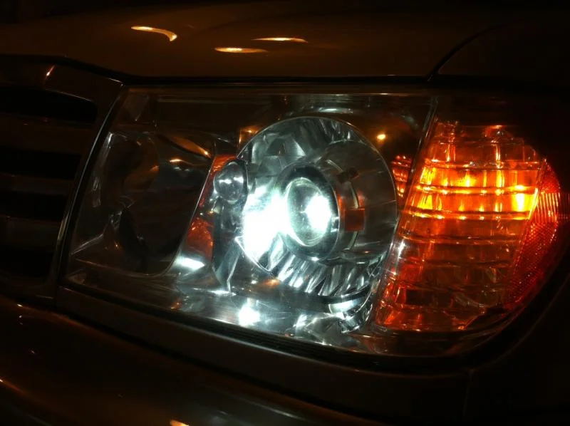

Final product
Finished shot. I'll try and snap a few more at night to show you the output. I love these little projectors, such wide beam patterns and really good light. I also paid a little more for the XB35 bulbs and they are bright.
