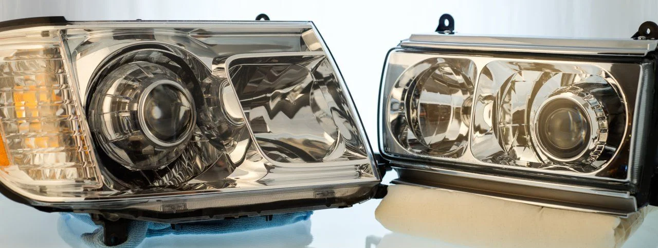

Hey guys, I'll bump this with the completion of my quad-projector retro for my '06. D2S's in the high/low beam spot, Mini H1's in the highs. LED strip along the outside of the high beam reflector housing that also function as indicators. LED bulbs in the signals (not 100% sold on those but happy for now). Overall, incredibly happy with how much light these things put out.
Low's only:
High and low both:
DRL's only (on whenever ignition is on, OEM setting)
Before you ask, no I did not attempt this myself, I had it done by Dan at RIHIDS in Woonsocket Rhode Island. Nice guy, does great work and would recommend to anyone in the area (or elsewhere for that matter) looking to have more light.

Light output is pretty incredible, definitely worth the money if you ask me. I wasn't so much worried about the baking/dremeling etc, it was more the wiring that I was scared to tackle. In the end I'm glad I left it up to a professional, I don't think it would have turned out well if I had done it myself without practicing on something else first.
