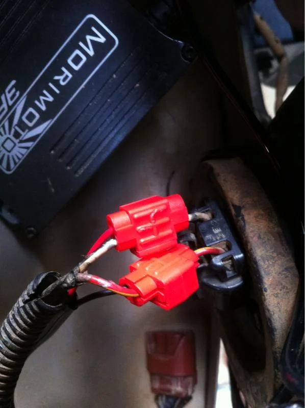

Tried to do highbeams and it didn't like the idea.
Issue- can't get lights to come on at all.
When lights are on, i plug in the solenoids, and high beams work and solenoid triggers fine. Once I turn off lights I can't get them back on until I unplug the solenoid wires. If I unplug DS, it will light up but not PS, vise versa. I removed the 9005 Highbeam LC bulbs and running it stock harness straight to bi-xenon solenoid wires.
Ideas?

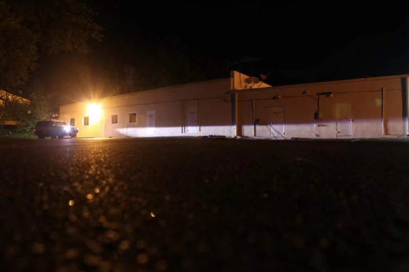

Up'd the output a bit and did some tweaking.
Added a foreground limited, adjusted the shield to give a full color spectrum on cutoff and 55W 4300K high beams.
Completely eliminated my needs/wants to other aux lights. I will be adding some stuff in the near future inside the headlights for more output, low beams need some more output. Look at the first picture with low beams only, you can barely see the street light ahead and the little mailbox reflector. When high beams are engaged the solenoid flap goes down and the high beams flip on. Now look at the street light, you didn't see there was a sharp downhill curve coming did ya? Even with the halogen highs and Bi-xenon it did not cast that far.
I have and they look great even with two cutoff lines. I need to properly aim them and then wire up the high beam solenoid in the projector. I had the passenger light turned down with the old setup and I need bring it back up and align the lights sideways to match the upturn in the cutoff.
