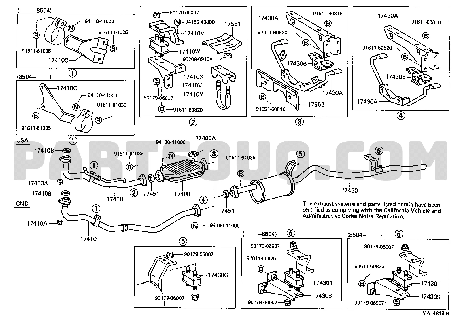

For reference ....check out this schematic,

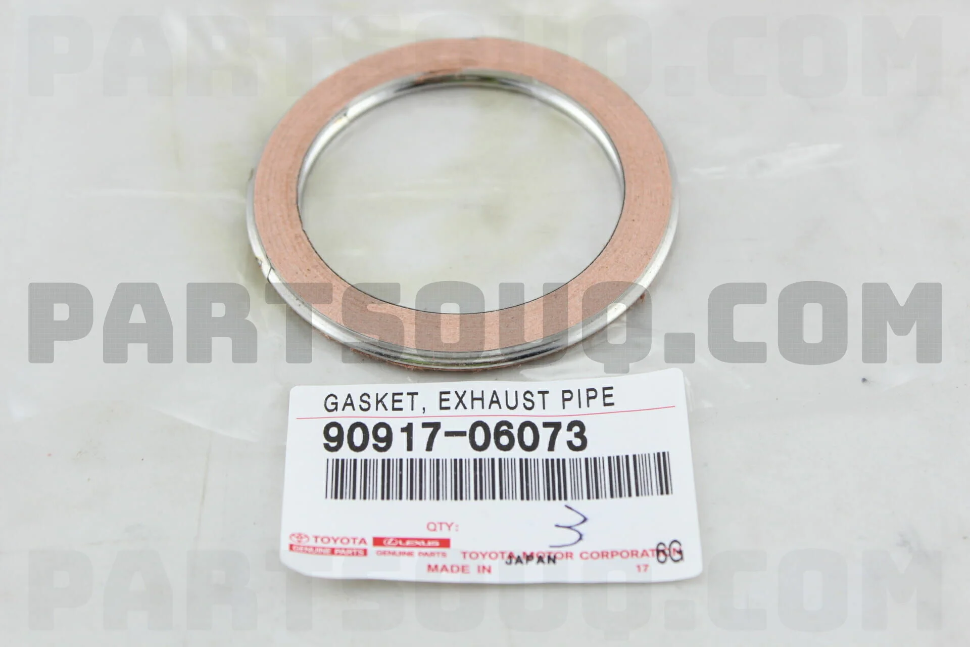

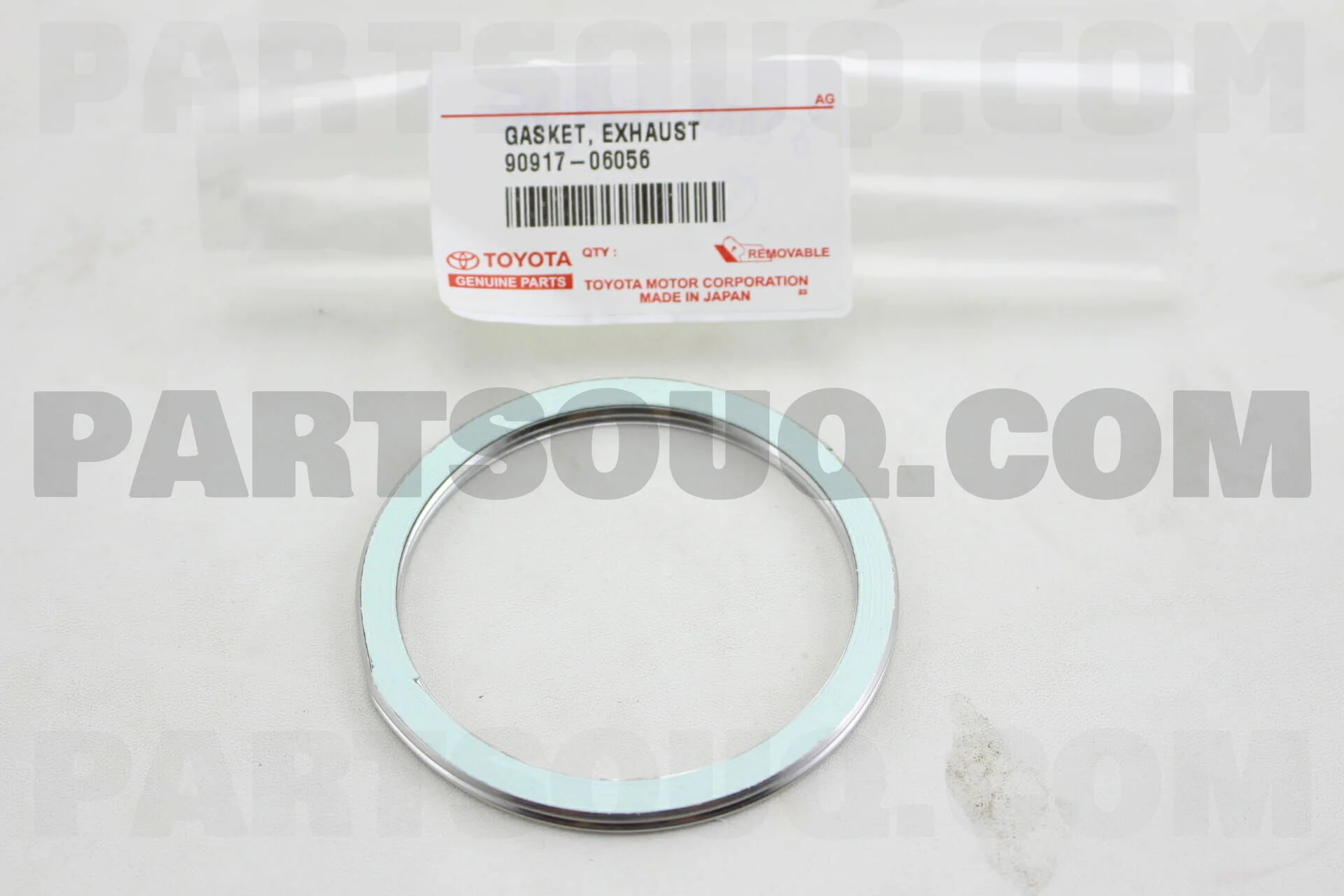

call out the part numbers for the gaskets you are talking about. FYI, the front pipe (17410) is informally called the "downpipe". Their are two types of gaskets...the one between the exhaust manifold and the downpipe pictured here:
and the one between the exhaust pipe and the cat flanges:
where does the bottom gasket go to? I've got the top one.
There are flanges at the factory CAT thats where they go. Most vehicles by now have replaced their toasted factory cat ....if you're like mine the newer cat is welded on or clamped onto the exhaust pipe and there is NO gassket.

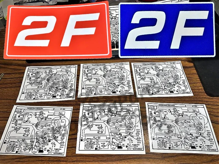

Here , details that matter most FJ60 2F 8/80-9/87 SMOG Emissions Vacuum and System Circuits Routing Diagram Reproduktion Decal Sticker .....
- 3-M heat press vinyl , glossy glossy gets for long term goodness & on-board , in-hand without having to use either hands
- comes as a 2pc set / pair of 2 decals so one is affixed under the hood , and then the other gets applied directly to the inside last page of your factory owners manual , exactly like TOYOTA intended , this decal is OEM size spec'd to fit perfectly Length and Width same as the owner's manual minus a border of free-space in single millimeters all around .....
- this is one of the 2 roadmaps , needed to de-smog a FJ40 / FJ40 2F , in addition to the other one 1981 & or 1985 RED 2F Emissions stand alone FSM

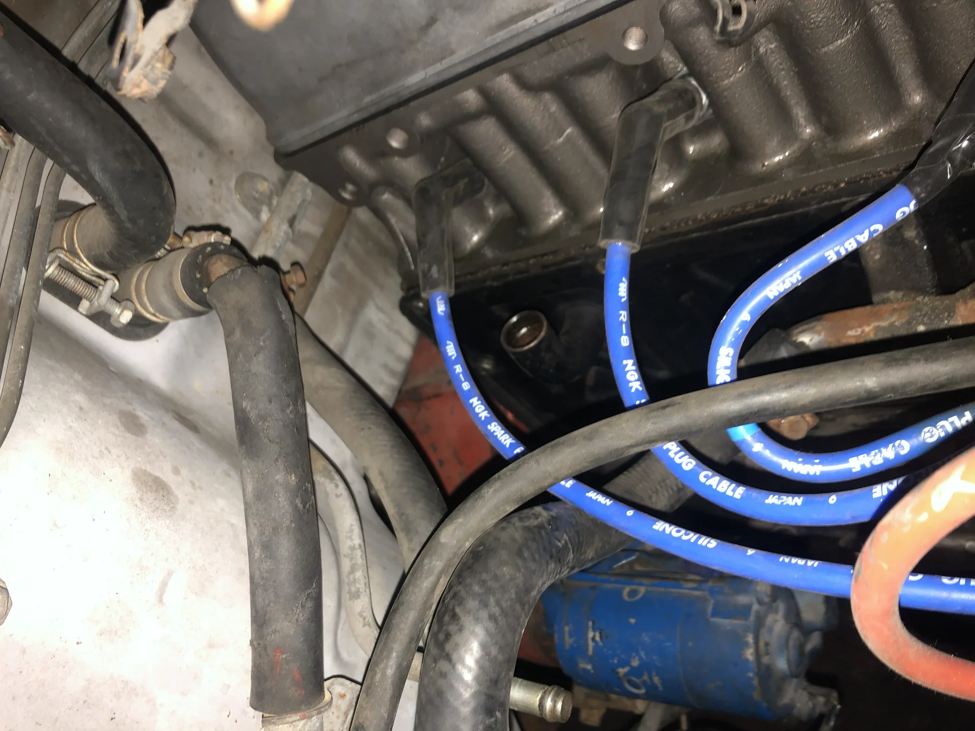

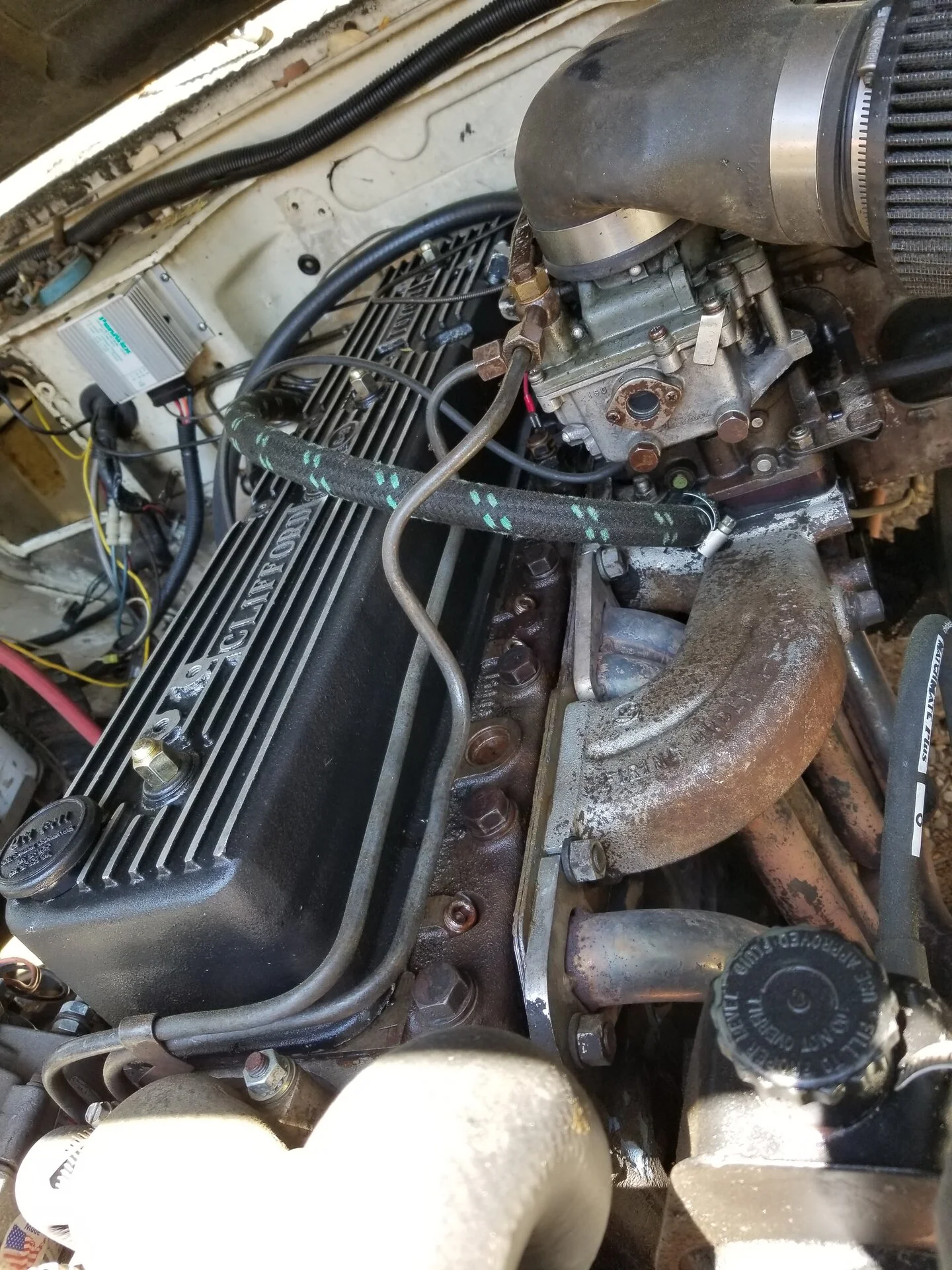

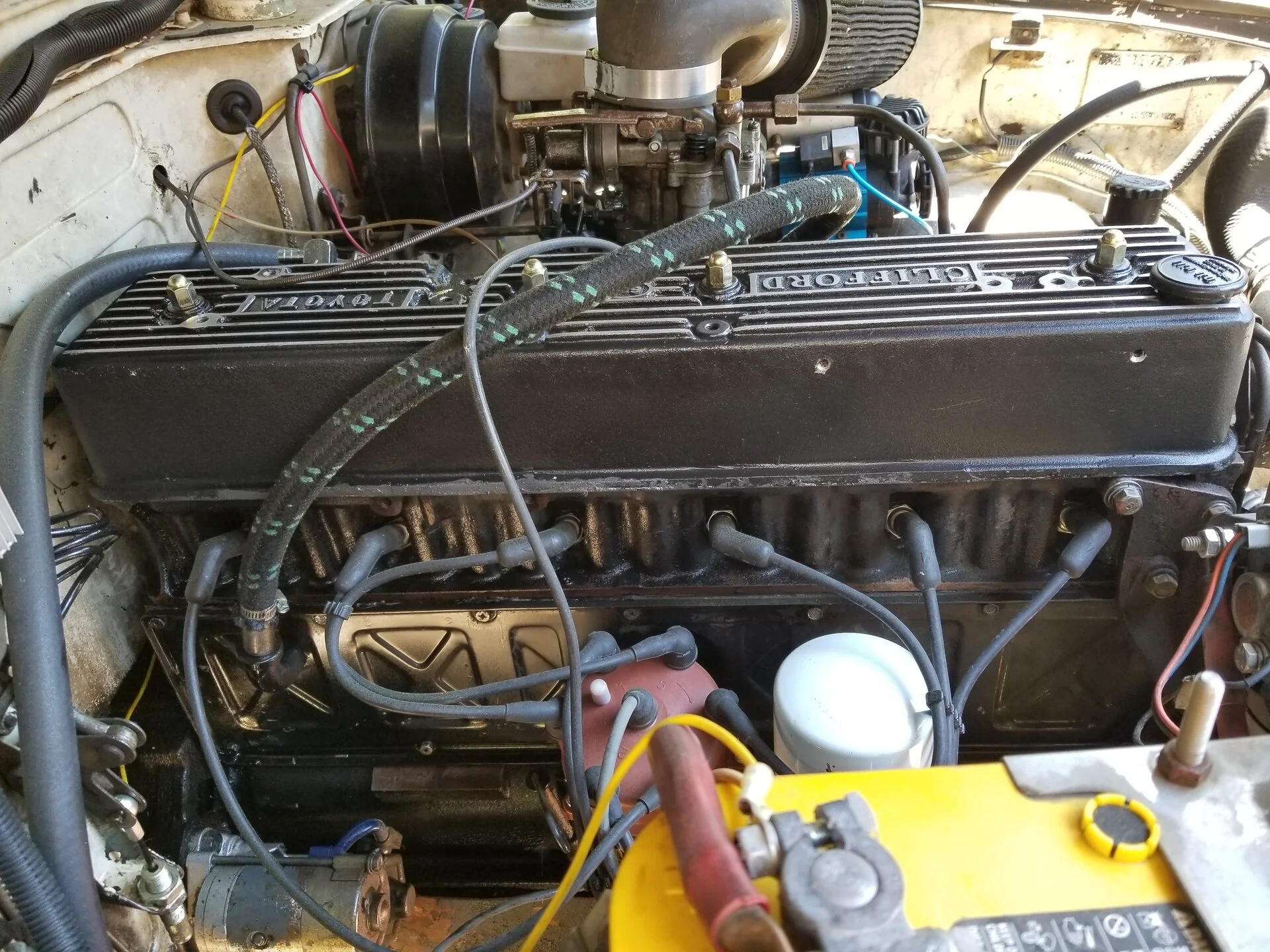

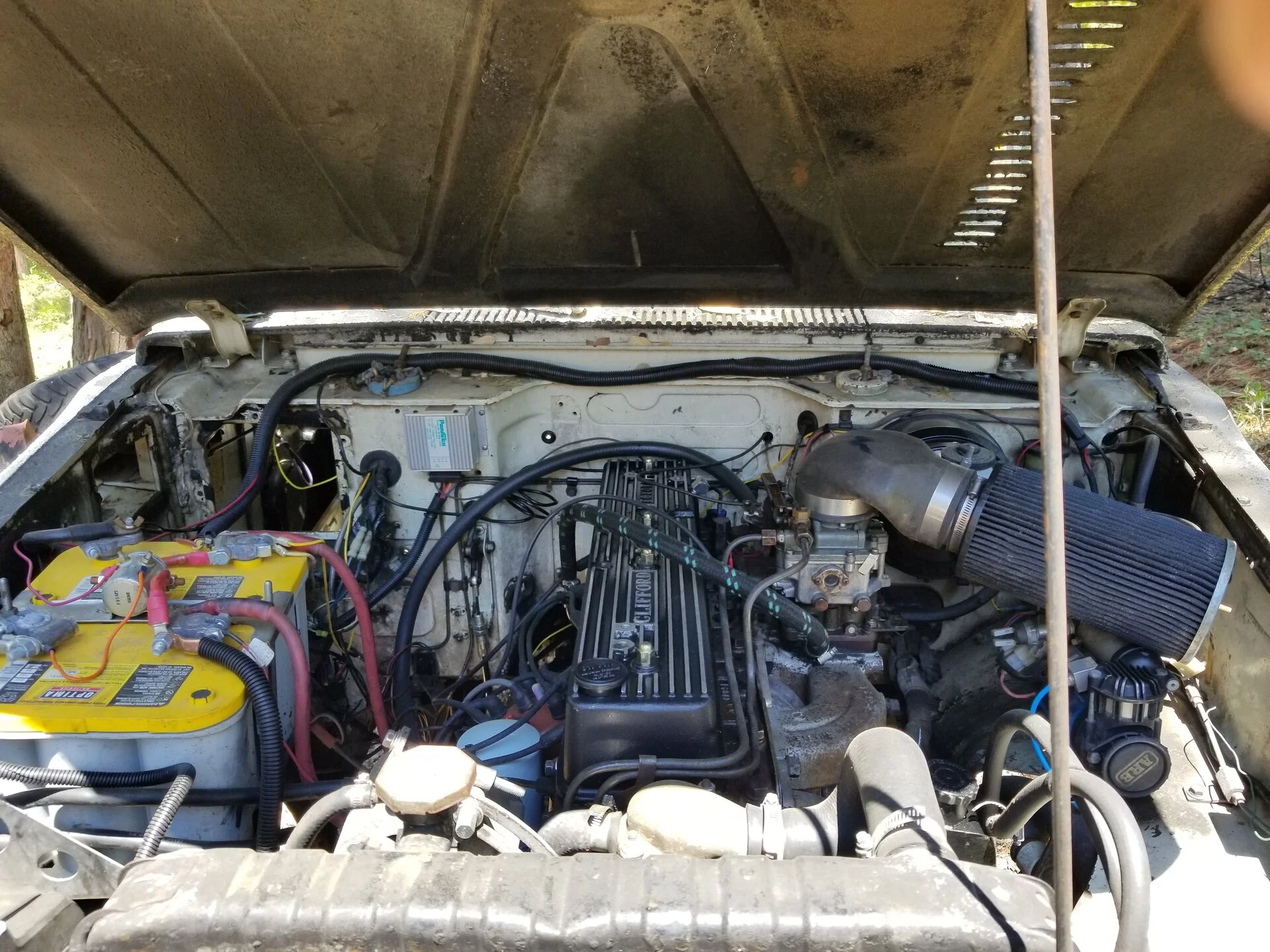

Does anyone know where the tube on the side of the engine cover engine attatches to, with typical desmog?
Final Push today-- forgive me for hijacking this thread..

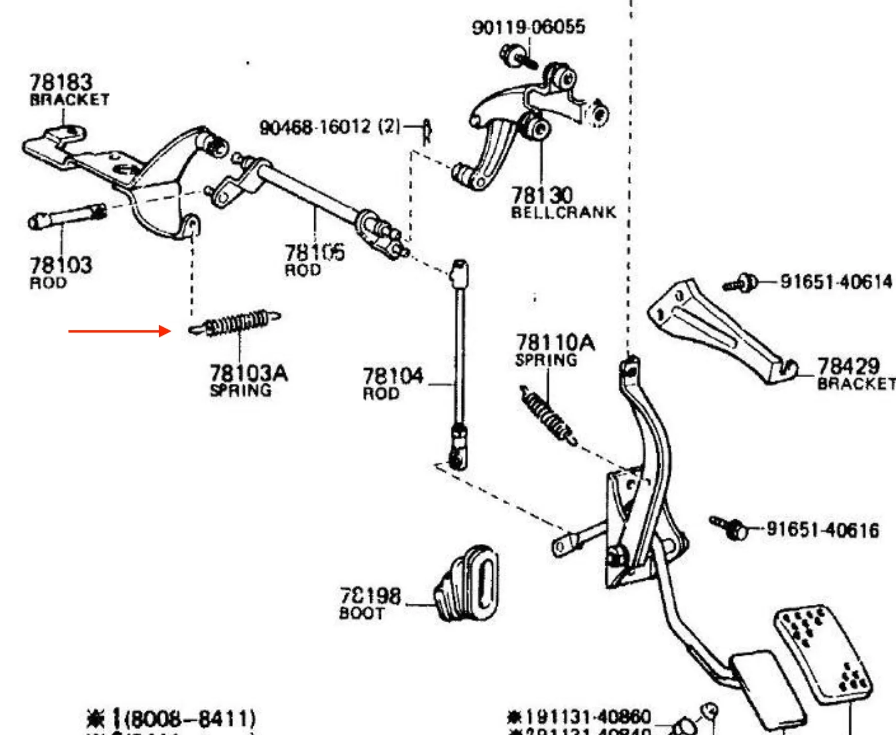

Im missing this spring, is there anyhting else I can use tempporarily?
Where does it end tho? on the pipe under the carb? if so, i thought this was deleted?
I plumbed mine the intake manifold. It can go to the breather but better on a strong vacuum. Blowby can create pressure in the crankcase robbing you of power while pushing oil through old gaskets. Make sure your oil dip stick is sealing or you will have a vacuum leak.
I T'd mine into the purge on the charcoal canister then to one of the brass fittings on the intake.
