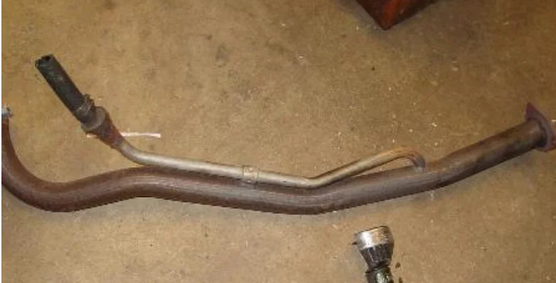

Do you have to cut the air pipe per the doc or can you just leave it? "The metal pipe off the pump can be removed, then there's a decision to make about how to deal with the rubber hose and the metal pipe that connects to the cat. The choice is as follows (from JimC):o The proper fix is to drop the front exhaust pipe, cut the air pipe off, then weld the hole shut:o The hillbilly fix is to cut the rubber hose under the master cylinder, then stuff a big bolt or a rock or a stick in it (secure the bolt with a hose clamp to keep it in place)"
What is the drawback to leaving it?
Do you have to cut the air pipe per the doc or can you just leave it? "The metal pipe off the pump can be removed, then there's a decision to make about how to deal with the rubber hose and the metal pipe that connects to the cat. The choice is as follows (from JimC):eek: The proper fix is to drop the front exhaust pipe, cut the air pipe off, then weld the hole shut:eek: The hillbilly fix is to cut the rubber hose under the master cylinder, then stuff a big bolt or a rock or a stick in it (secure the bolt with a hose clamp to keep it in place)"
Any rubber hose that touches the cat will melt. Not sure what you’re talking about…. The thermosensor?
The pipe you have pictured is part of the EGR/smog pump system. You can leave it and block it. Leaving it makes it easier to go back to stock if you ever decide to do so.

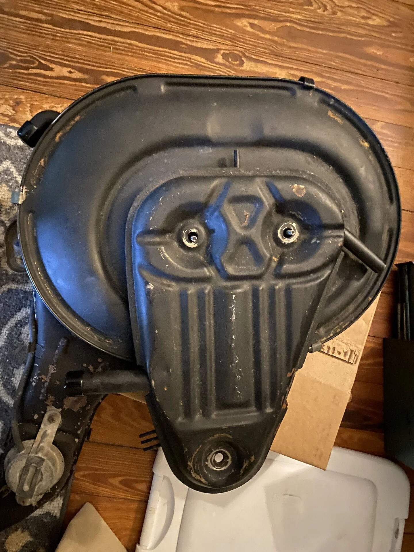

Desmog question regarding the Air Cleaner: I had the Jim C 2F Cap and Plug kit and put the caps on the Air Cleaner that fit however, there was a third tube (angled tube on the right) that I do not see referenced in the kit or Desmog doc. Any idea what this connects to or does it get capped as well?
Desmog question regarding the Air Cleaner: I had the Jim C 2F Cap and Plug kit and put the caps on the Air Cleaner that fit however, there was a third tube (angled tube on the right) that I do not see referenced in the kit or Desmog doc. Any idea what this connects to or does it get capped as well?View attachment 3404542
that 45' angled metal tube u DO NEED ....
