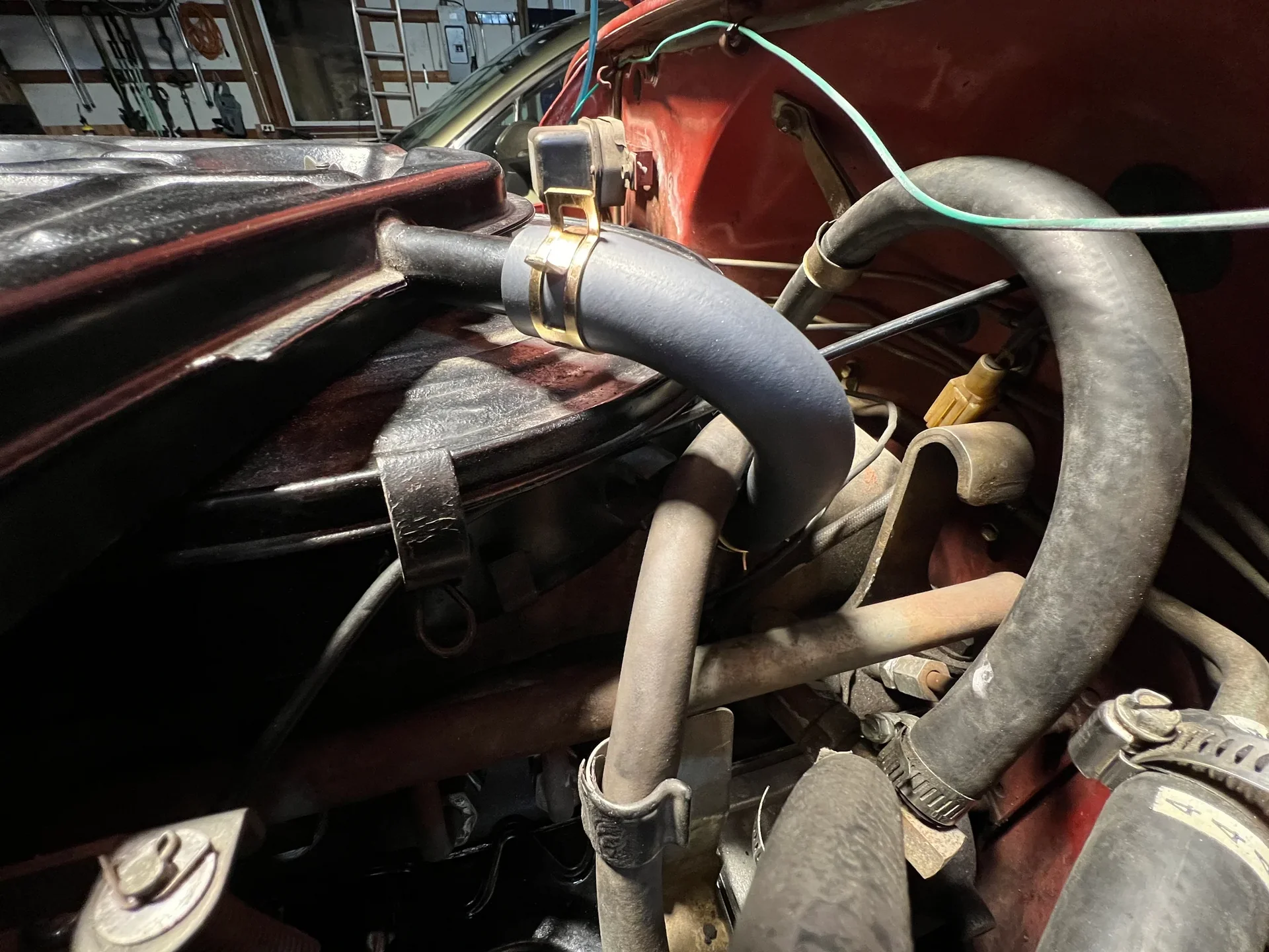

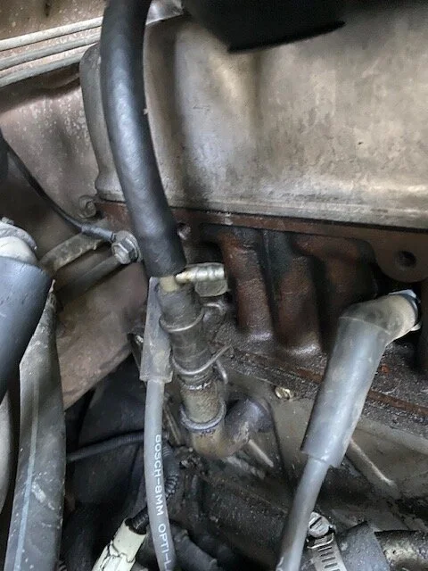

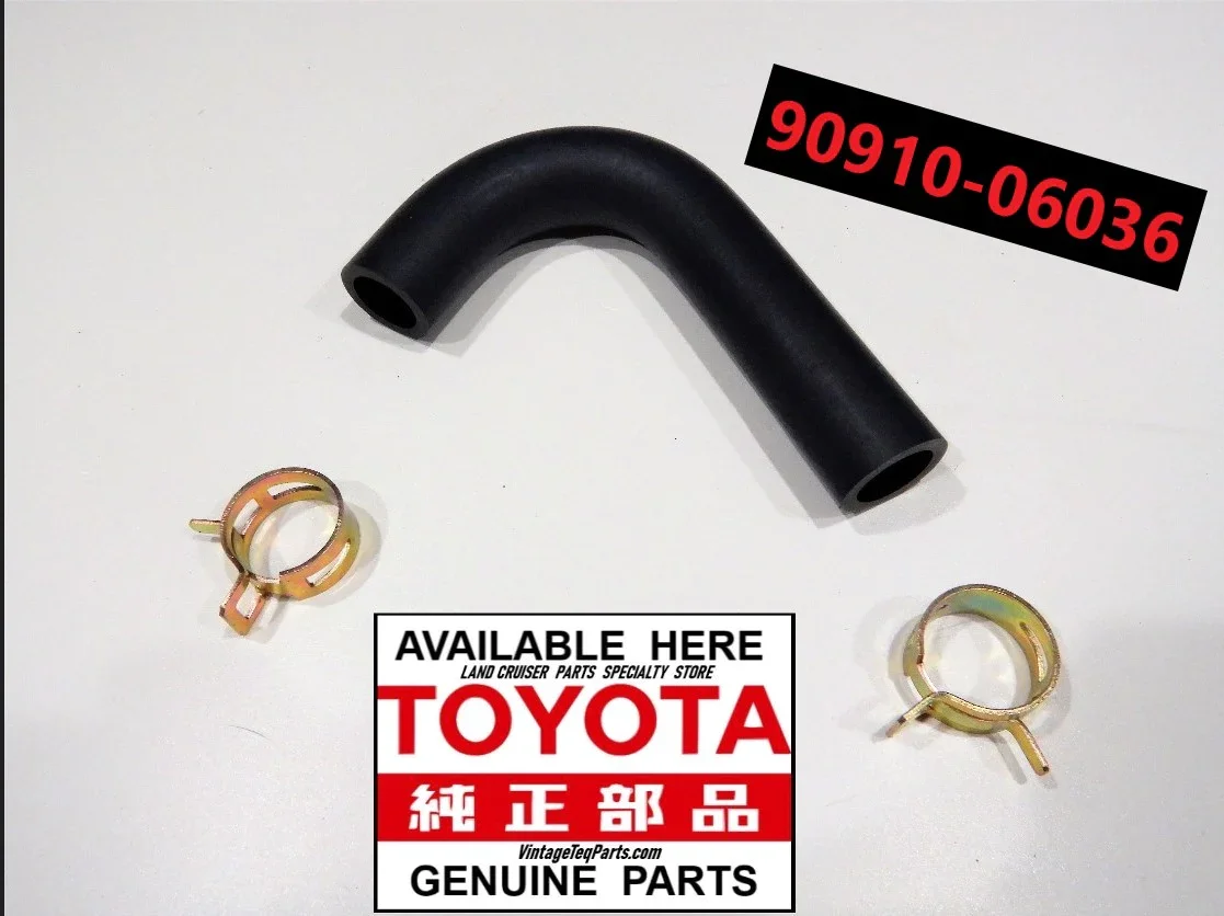

that 45' angled metal tube u DO NEED ....
per The MUD SMOG CAZAR ...
Thanks!... I had a Weber on my vehicle and just went back to stock. The PO had a tube sticking out of the valve cover. Is that where this tube would connect to? { NEVERMIND - I just saw the other pics}

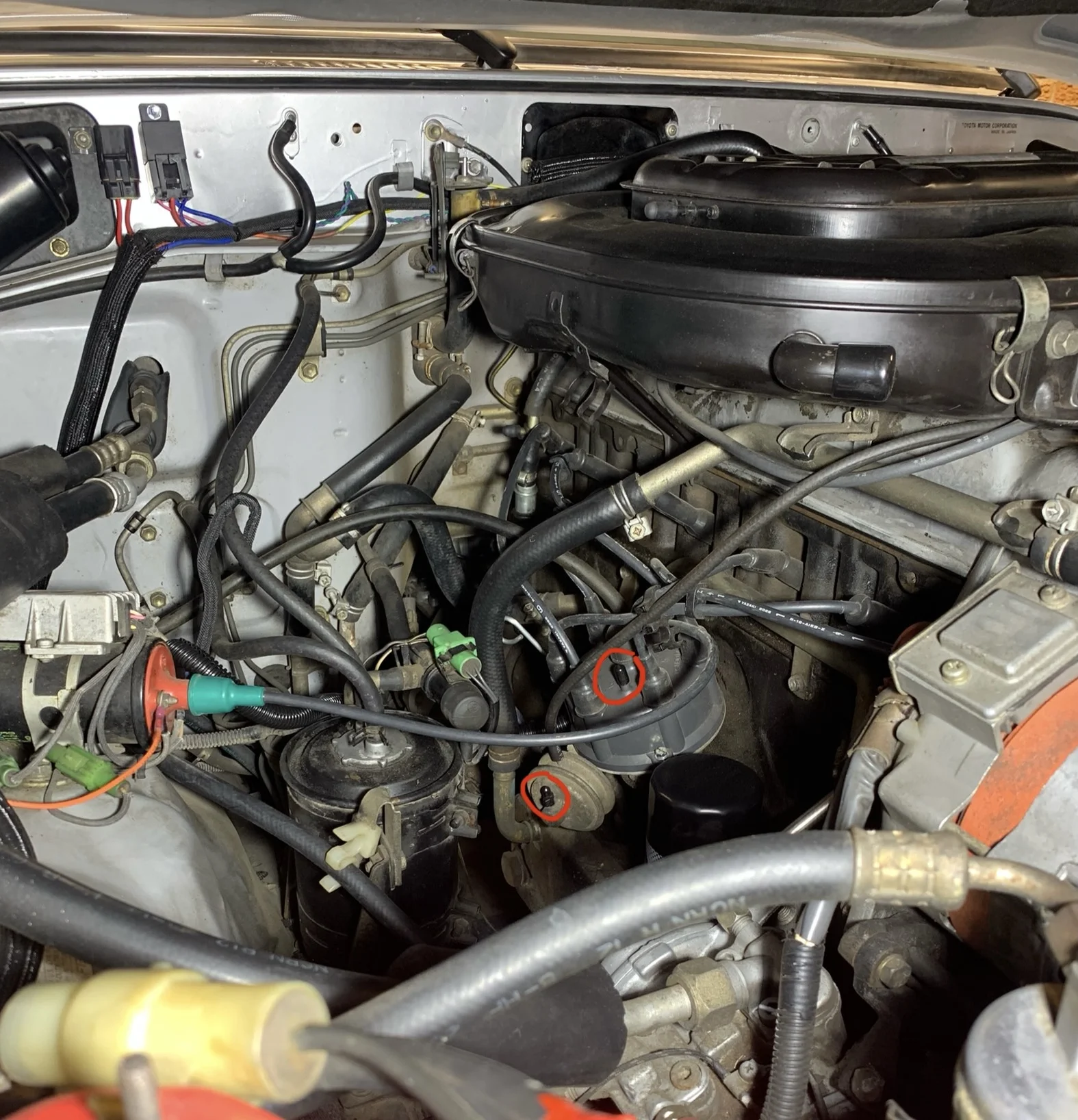

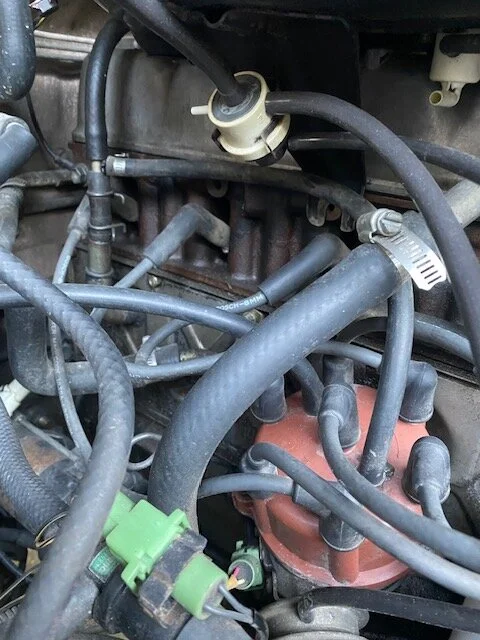

For a proper desmog…..Can anyone clarify if the two circled ports should be capped? Open to atmosphere? Or connected to each other?
the one on the distributor cap should be hooked up, it needs to vent the distributor
line should come from the firewall breather into the cap then into the bottom of the air cleaner assembly
For a proper desmog…..Can anyone clarify if the two circled ports should be capped? Open to atmosphere? Or connected to each other? View attachment 3626581

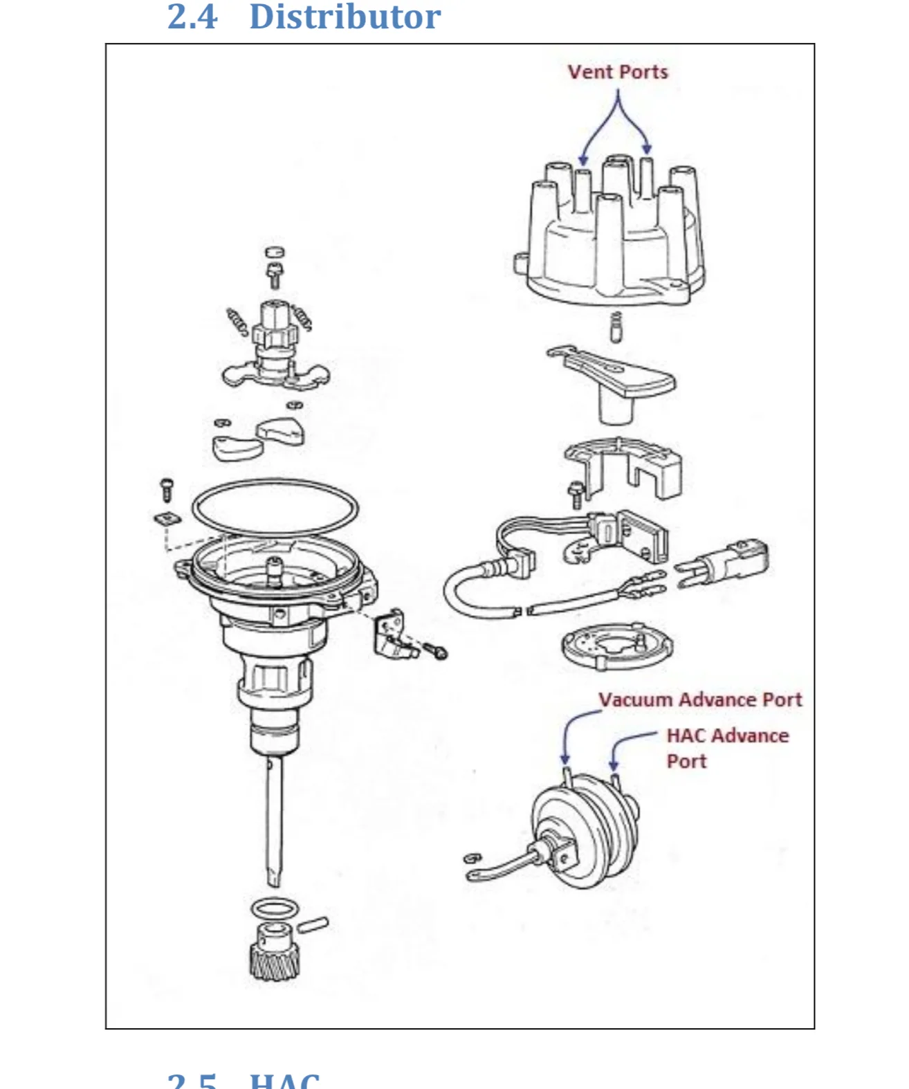

Not sure if you have this document but explains it all and we’re each port should go if you are desmoged. This pic I pulled from document. Hope this helps.
A desmog isn’t a binary thing. Read the Emissions Manual. What equipment do you want to keep for your application? What’s your goal? “Desmog” doesn’t mean ripping out every vacuum line willy-nilly. Think about it.
Yes you want your dizzy to vent or it will corrode inside. As for the HAC, what elevation do you live at? Will you ever cross the 4000’ threshold going up or down from where you live? And further, do you want the HAC to inject air in the carb to compensate for lower oxygen levels at altitude, or do you want it to advance the static timing a few degrees to help with the burn with less oxygen in the charge? Or both? Because all three scenarios require plumbing the vac lines different. And I’ll go back to: what’s your goal? Learn what the systems do first and think about it.
What he said......I am at sea level and chose to not run the HAC. One of my distributor advance ports is capped. Decide which one to cap after test driving a bit on each port with the other capped. The mentioned document is key to understanding a desmog and all the different variations.

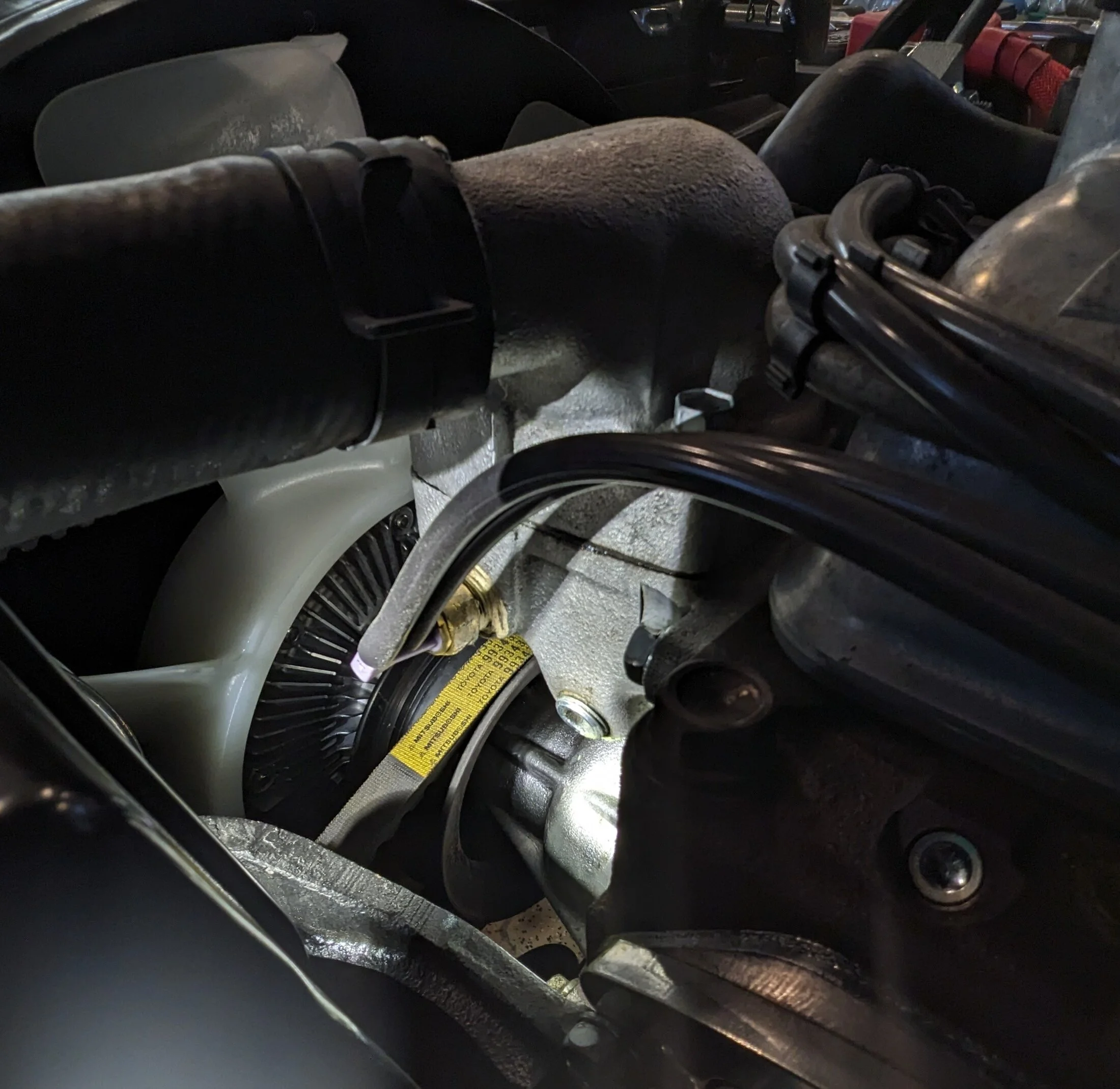

Got another desmog question. On the lower BVSV on the thermostat housing, can I just cap that off or do I need to remove and plug it? I have the Allen plugs.
I’m using the upper (purple I believe) one for EVAP and something else per the “How to desmog an FJ60” instructions. I know it says to remove and plug the lower (pink I believe) one but I was wondering if plugging it with silicone caps would be ok as well? It’s the one with the orange caps, I was just checking to see if the caps fit, if I need to remove it I will. Was hoping to avoid removing it if I can just cap it. Thanks everyone!
Got another desmog question. On the lower BVSV on the thermostat housing, can I just cap that off or do I need to remove and plug it? I have the Allen plugs. View attachment 3636275I’m using the upper (purple I believe) one for EVAP and something else per the “How to desmog an FJ60” instructions. I know it says to remove and plug the lower (pink I believe) one but I was wondering if plugging it with silicone caps would be ok as well? It’s the one with the orange caps, I was just checking to see if the caps fit, if I need to remove it I will. Was hoping to avoid removing it if I can just cap it. Thanks everyone!
This will answer your question....
This just looks nicer.....
No need to cap at all. It opens a valve when it gets to the right temperature to let vacuum pressure go thru the hoses. No coolant will leak out.
Makes sense, thanks again. Nice to know I don’t have to address it immediately
When I desmogged my 60 I found both had broken nipples. So just removed vacuum lines. Like you are going to do just plugged both when I pulled housing off and cleaned everything up. Got my plugs from @ToyotaMatt.
Thanks guys for the quick responses! I have the correct plugs, I was just hoping I could hold off removing that until I did the cooling system refresh. All of these responses to my OP have answered my questions. Thanks to this community of helpful folks

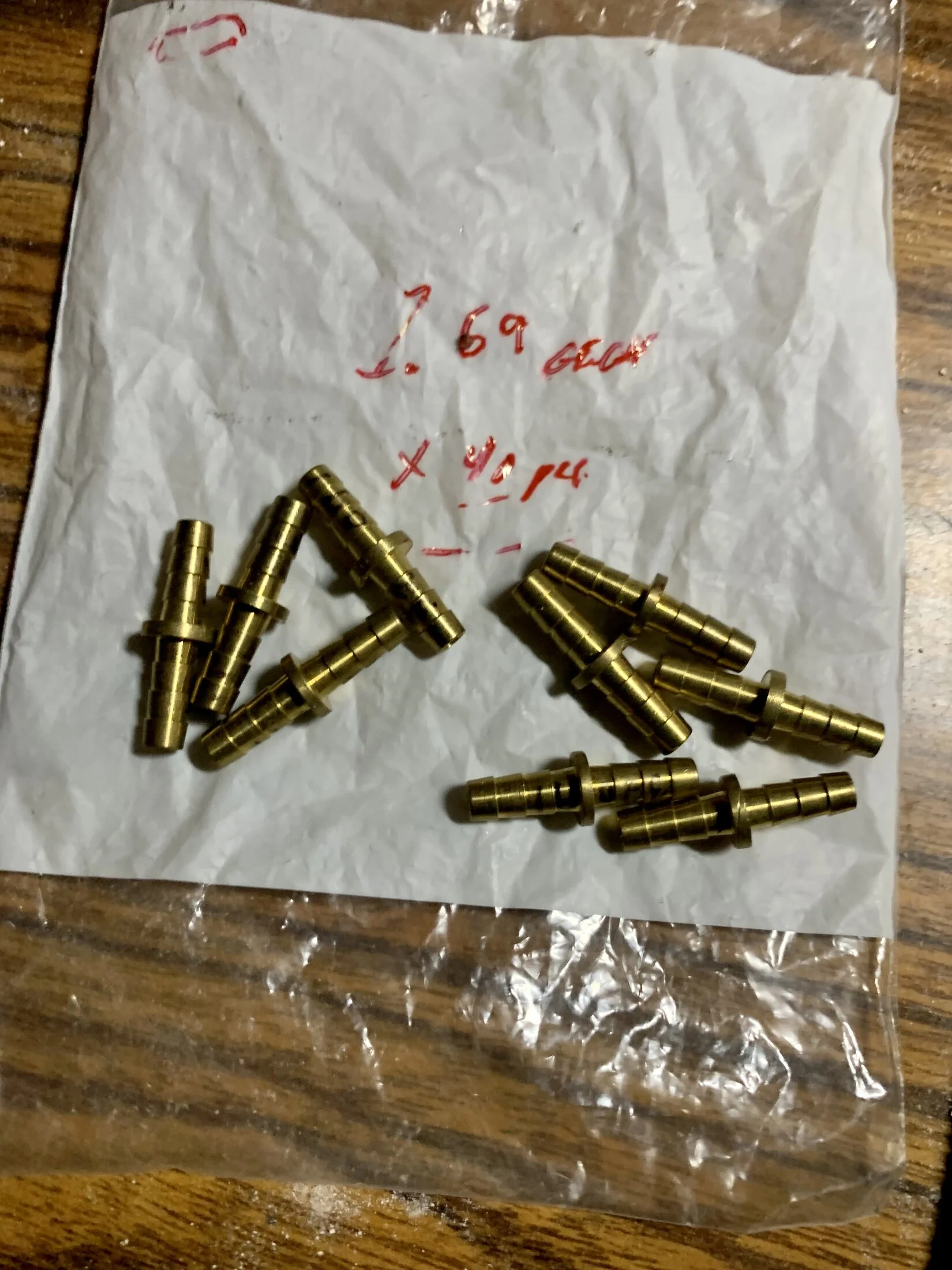

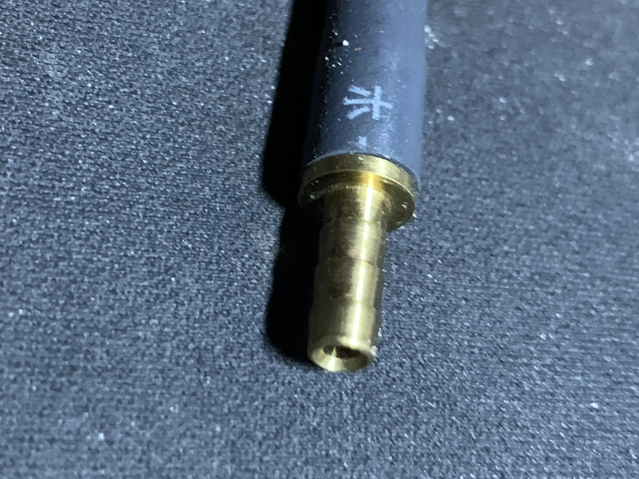

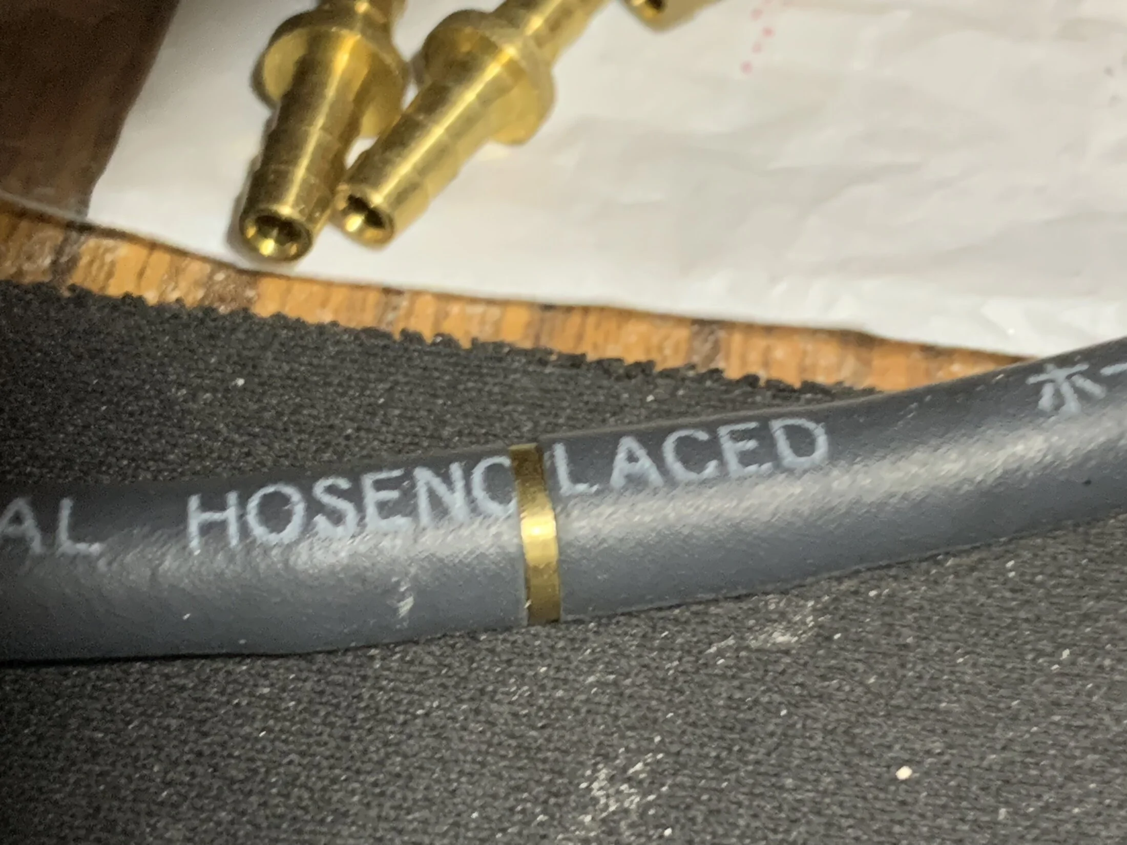

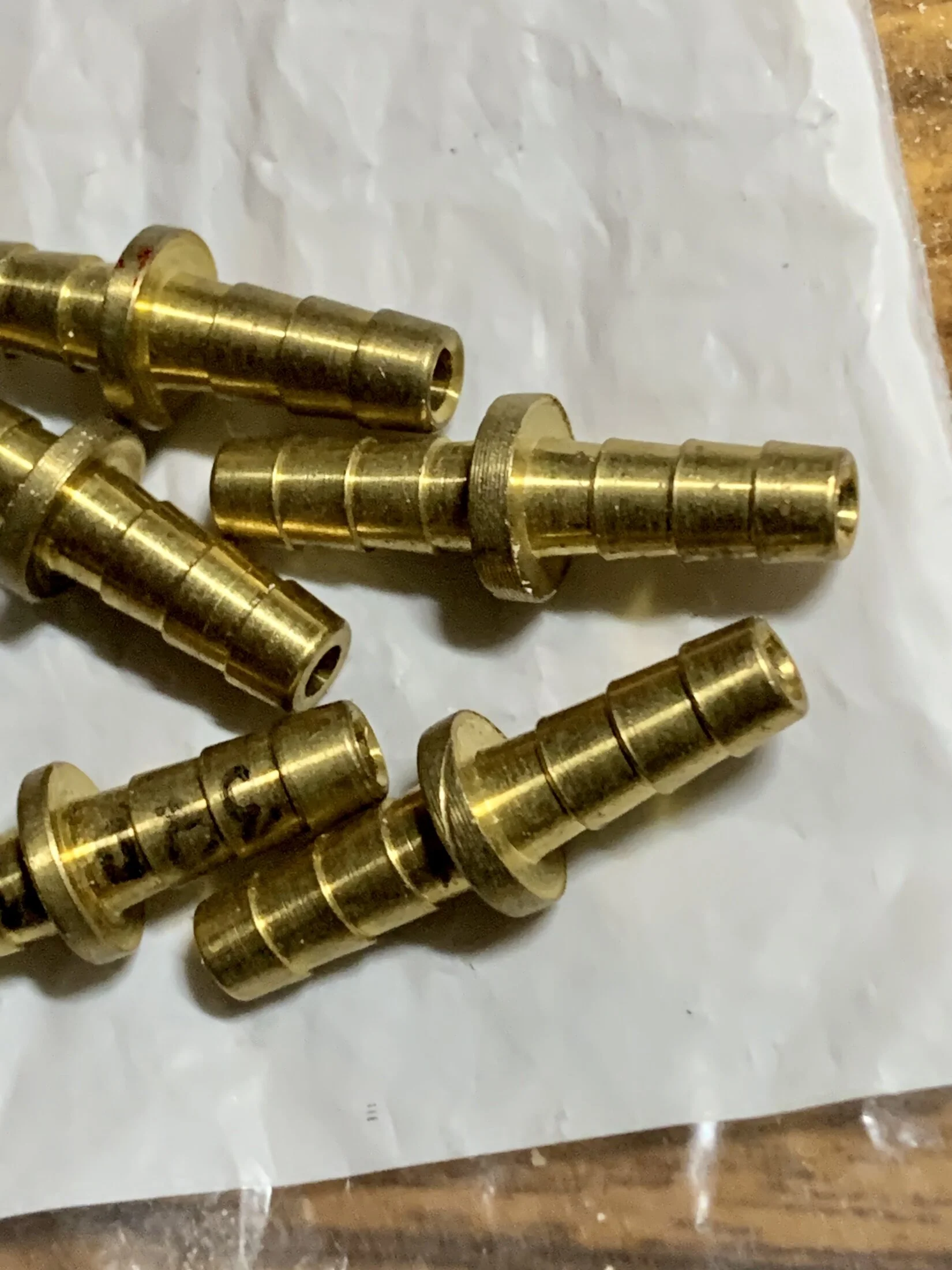

- i found these little rascals below at my local ACE / TRUE Value store , in the plastic pull out parts drawers / self bag & tag type problem solvers , plumbing aisle , years ago , they still keep stock of them there too .....
Note : the OEM 3mm vacuum hose has the normal
interference-feature hose bib tad-wee bit bulge normal …,
and no more ….
This is the highest BAR parts use topic I have ever come across as it relates on-topic here , as Toyota does not make a straight 3mm Vac. Hose through-butt service part like this ….
solid brass = life-time service part ....
