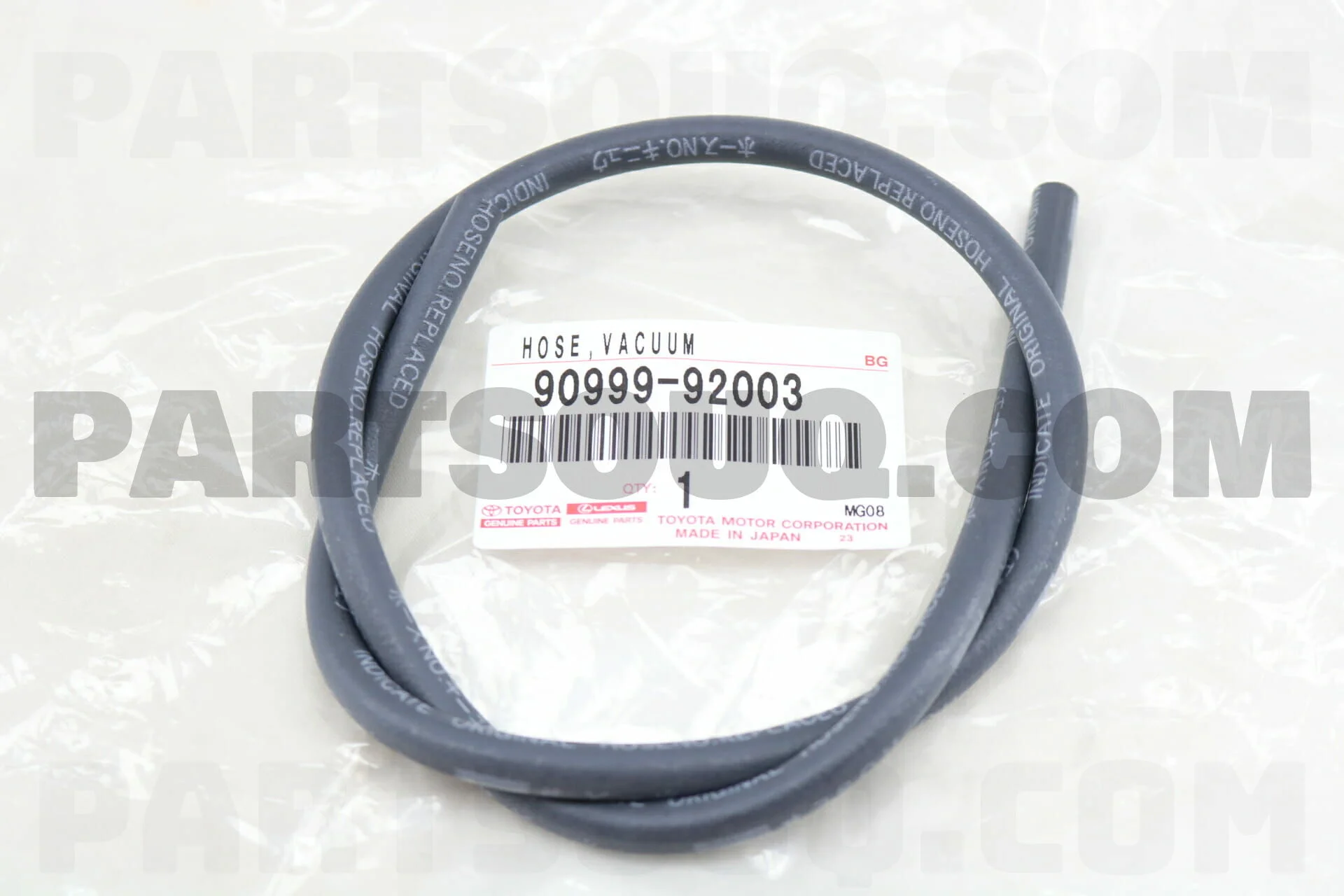

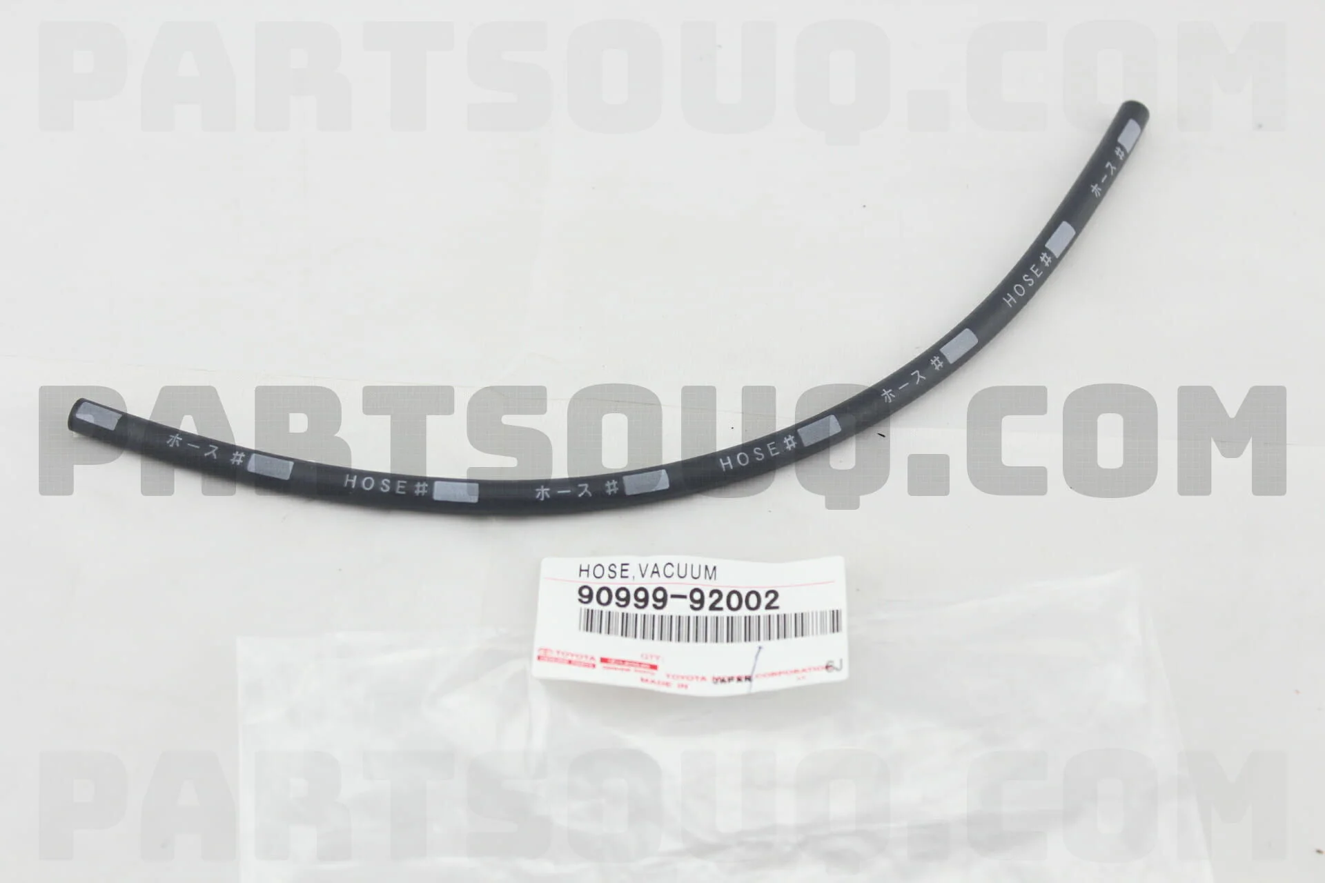

FYI, toyota still offers replacement vacuum hose. Just another option. Looks and feels more like the original. Probably a bit more expensive than buying a spool of silicone but maybe not that much more.
