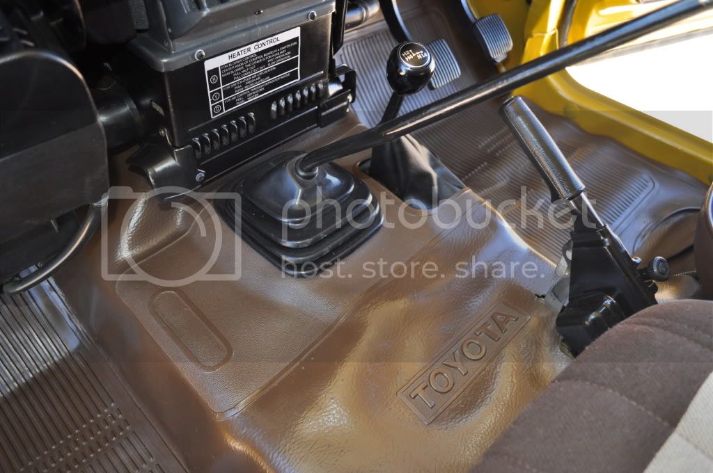

Let's compare the Australian replica to the OEM floor mat. I think the visual differences are minor:
1) The handbrake cutout pattern is on the opposite side, but it does not appear to be pre-cut
2) Logo and the cosmetic circle to the left of the shifter hole are a little different because it's based on the '84 final iteration that was not sold in the U.S.
2) Logo and the cosmetic circle to the left of the shifter hole are a little different because it's based on the '84 final iteration that was not sold in the U.S.......

Here's some photos of my original mat in my 1979 BJ40:
Notice how the "place-your-feet lined-pattern" is the same width (which is around 340mm at the point shown) on both sides but where I am (as the driver on the right hand side) it has an extra width (of approx 60mm) of relatively flat floor beside it to give me a wider floor-width than my passenger has.
In taking these photos, I've only now realised that they've deliberately kept this "place your feet pattern" the same width on each side ... so perhaps this means RHD and LHD mats are indeed interchangeable except for the handbrake cut-out markings? :meh:
PS. I find this very interesting. In this part of the world the centre passenger has always had a hell of a time working out where to put their legs. It looks like LHD vehicles make this easier for passengers by giving them the larger floor-space!
The size of the logo would bother me the most. The late transmission boot ring not as much. Not sure if the extra height on the inspection cover would make a loose fit. I have the late boot but to use it on a LHD would require straightening the shifter where it bend towards the right. This shifter bends towards the back sooner and the boot reflects this.
The logo is correct for late model cars. Take a look at this photo of a '83 BJ42 LX from Australia:
I did not know that as the 84 troopy had no mat but rather bedliner covering the entire floor. That picture does highlight the raised section around the T/T shifters. It also does not have a PTO section cutout that matches what was used on the 84.:meh: That wasn't shaped like that at all. It is a inner boot and flat upper rubber boot which would work I guess. Does make a nice option if they aren't cutting out the hand brake opening and leaving that to the buyer.
Forgot to mention the transfer boot is shaped different also. Not sure how that opening would match up.
