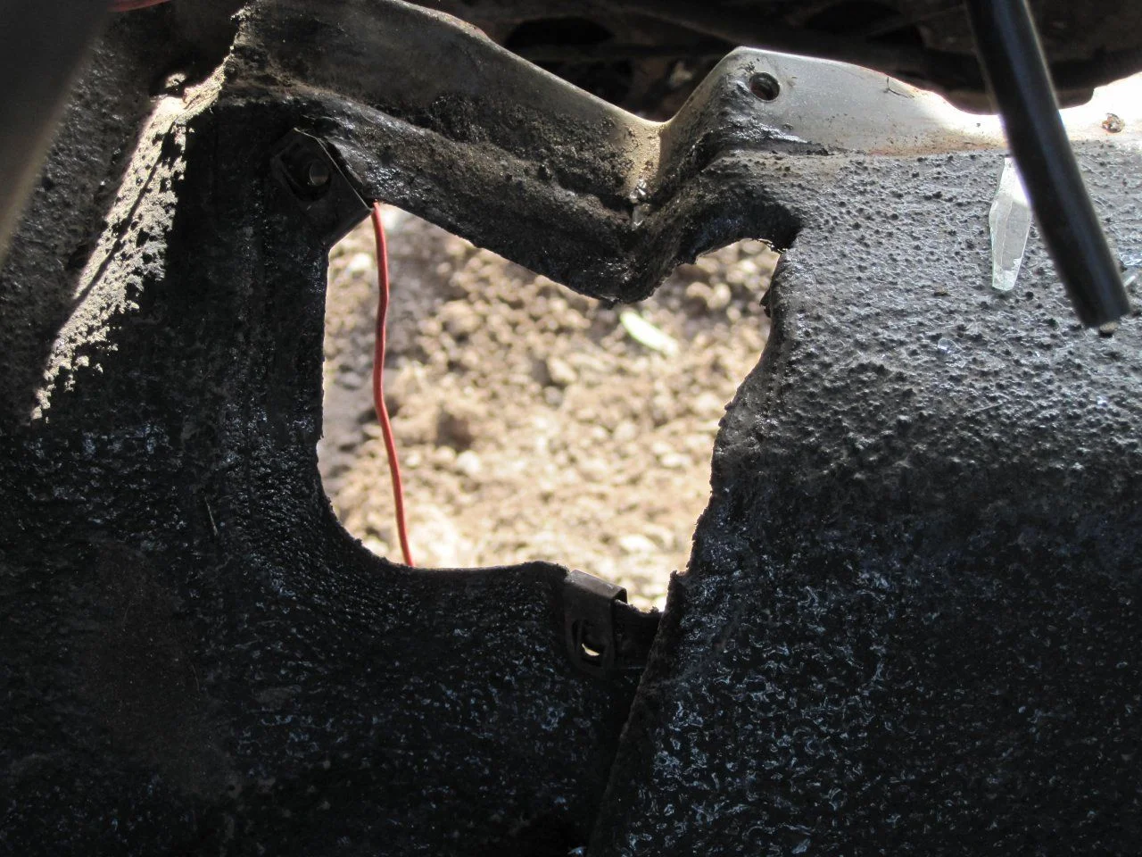

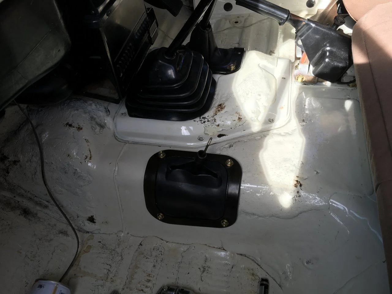

Here is the transmission with the shifter mounted. The Australian plaque was dated 6/84. Transmission is a H41 plus split T case with hand brake.

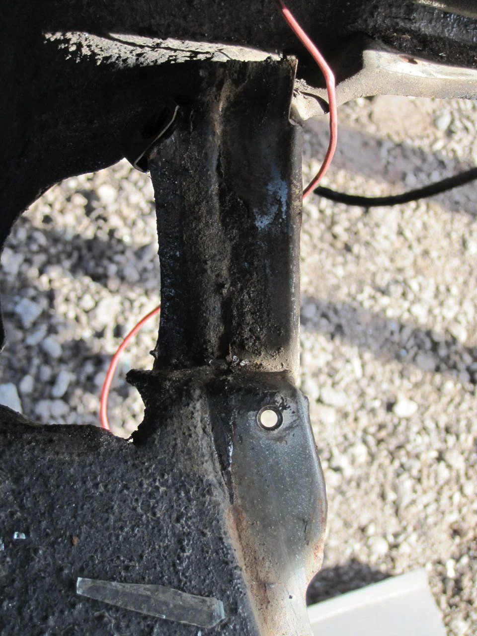

Floor was crushed in the accident. Looking from the left side this is the PTO shifter hole with T/T inspection cover above it.
This looking down. PTO hole on the left and inspection cover on the right.
Need to do some part number search but wondering if the shifter isn't for a 6X or 7X series. That would line the shifter up with transmission shifter.
Did some checking. Found a bunch of different bracket part numbers. Both the 6X and 7X series show the shifter angled back. 4X series with a five speed are straight up. The column with the buttons is the same on both four and five speeds in the 4X series. The bracket that bolts to the transmission is different between the four and five speeds in the 4X series.
I feel I was really lucky to have found a correct late model 4X series PTO end up in a wrecking yard about ten miles away. I picked up all the running gear except the 2H. The idea of having to ship it even across the US would have killed the deal.
I would gladly sell the PTO to get the correct H55F top cover for the 4X series with the shifting cane. I got the inspection cover with the T/T boots. It looks just the the boot on yours even thought it's only a four speed.
