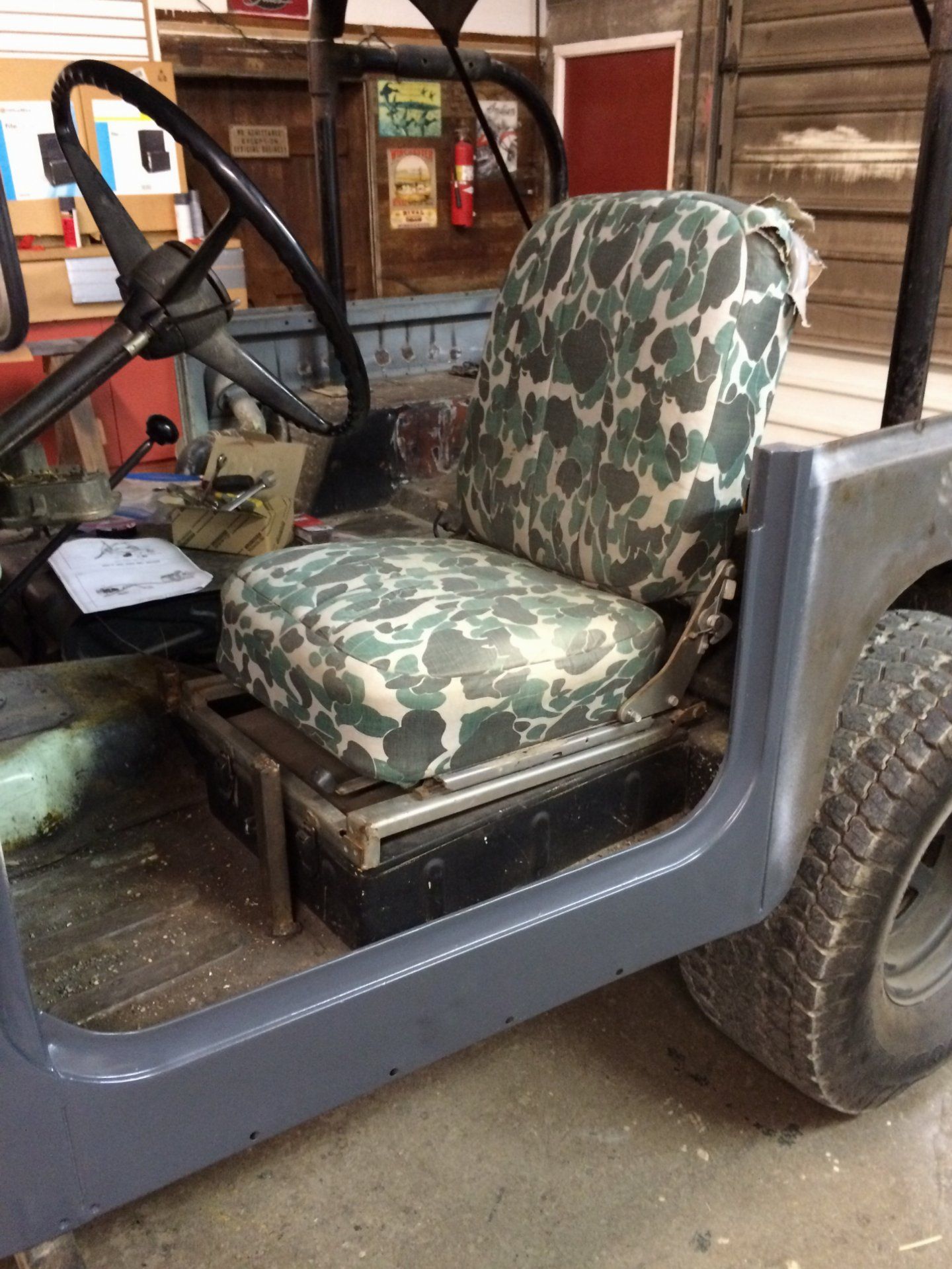

I don't know what you guys think, but I think this driver's seat really classes it up...
I'll cover the passengers seat to match!!!
Looking good it's coming togeather!!!

Thanks again Chris, that seat is awesome! Hope those Audi seats fit nicely for you.

I think the seats will work good. So much better than what I have now. I'm making brackets to fit my sliders. Should have something together by the end of the week.

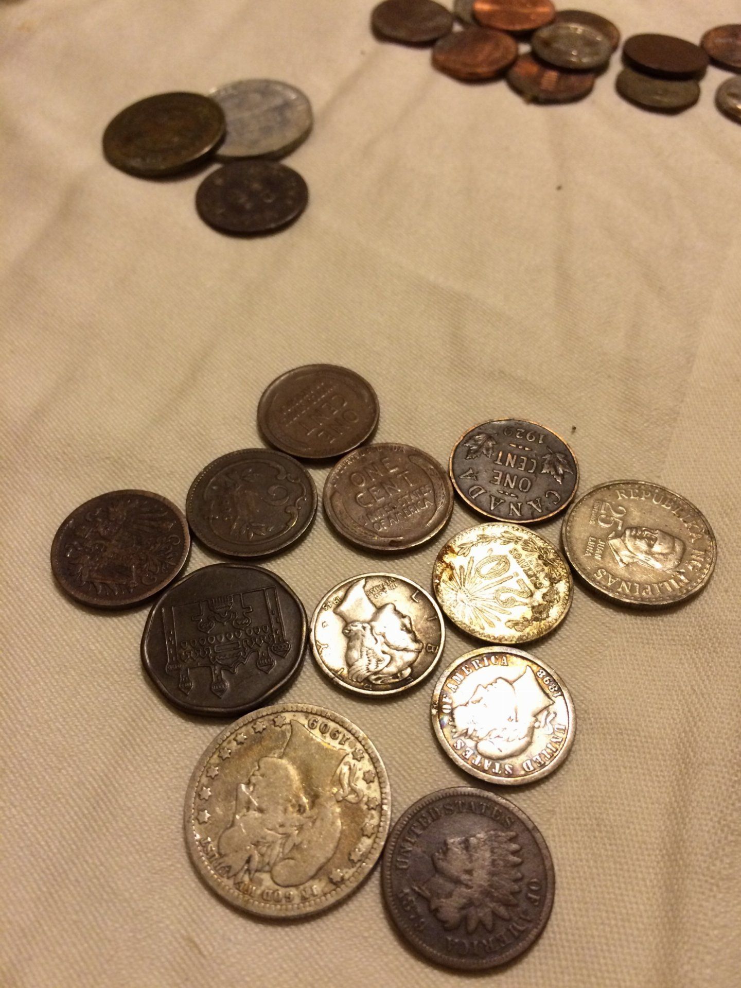

Oh well, pulled the gas tank out to drain the 2 year old "ethanol enhanced" gas and to paint the tub. Found a hand full of coins from late 1800's early 1900's and a bunch of foreign stuff, some casino tokens from Las Vegas etc.... I think I'll just put those back under there after I'm done painting for whatever reason, maybe it'll keep the 'old gal' running in my favor.
@TrapperHunt I wouldn't toss them back under there too hastily. Some of the coins in that picture may have enough value to pay for some parts. If not, certainly a case of good beer or a couple of nice steaks for you and the Mrs.
I'm no expert, but have gathered a few coins over the years. Here's a link to a quick market value guide (one guy's opinion):
Coin Values Discovery
The Barber dime and quarter alone could be worth $15 to $520, and the Indian penny upwards of $50. All of it depends on condition and mint location of course, either way it is a cool story to tell when talking about your 40!
Good luck!
Dave you made a good choice for speed of installation not to us those bucket seats. It is taking a lot of modification work to get them to fit right. But that's what I enjoy doing! I'm on the 3rd rendition to get the feel and slides just right.
