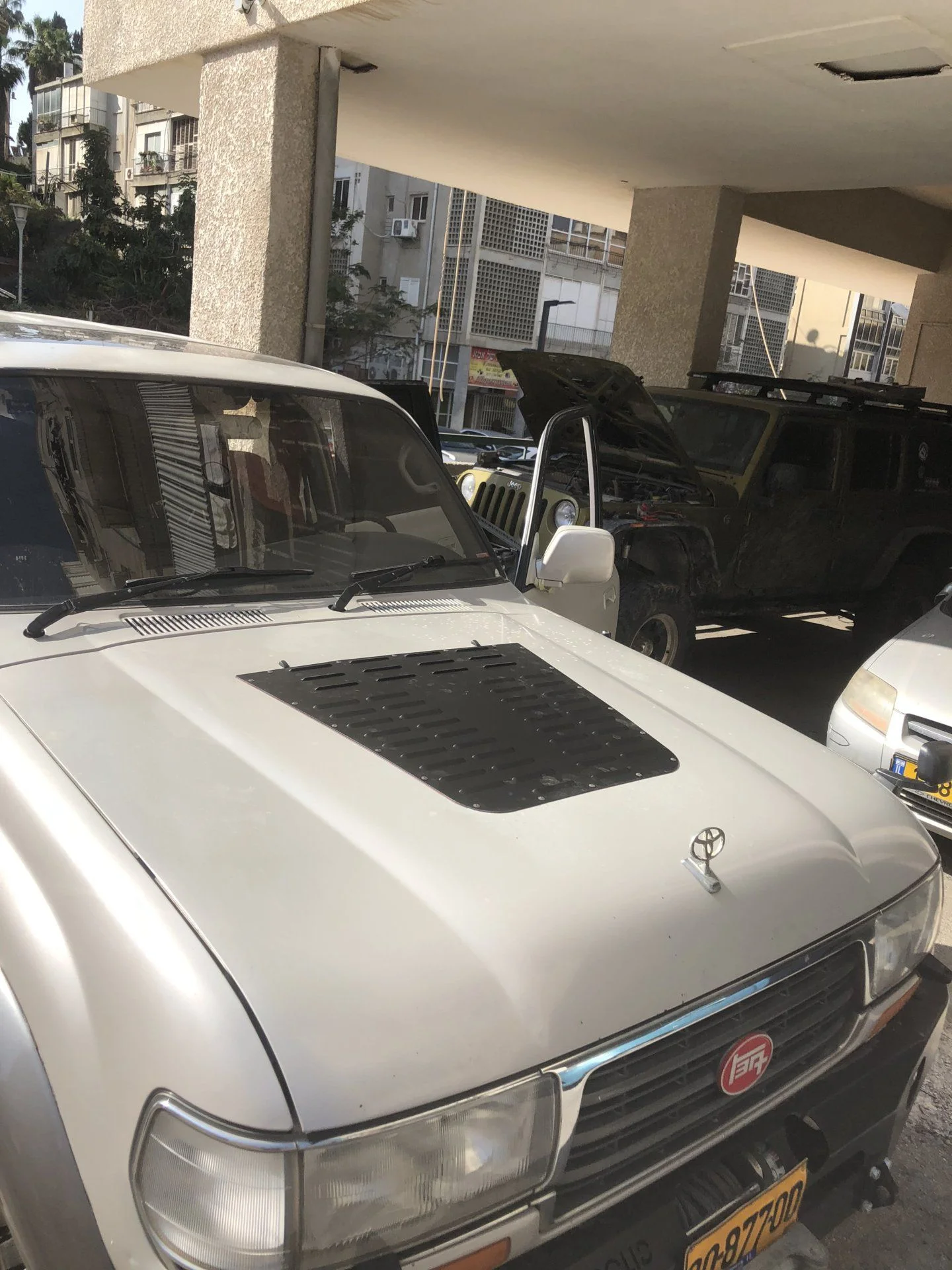

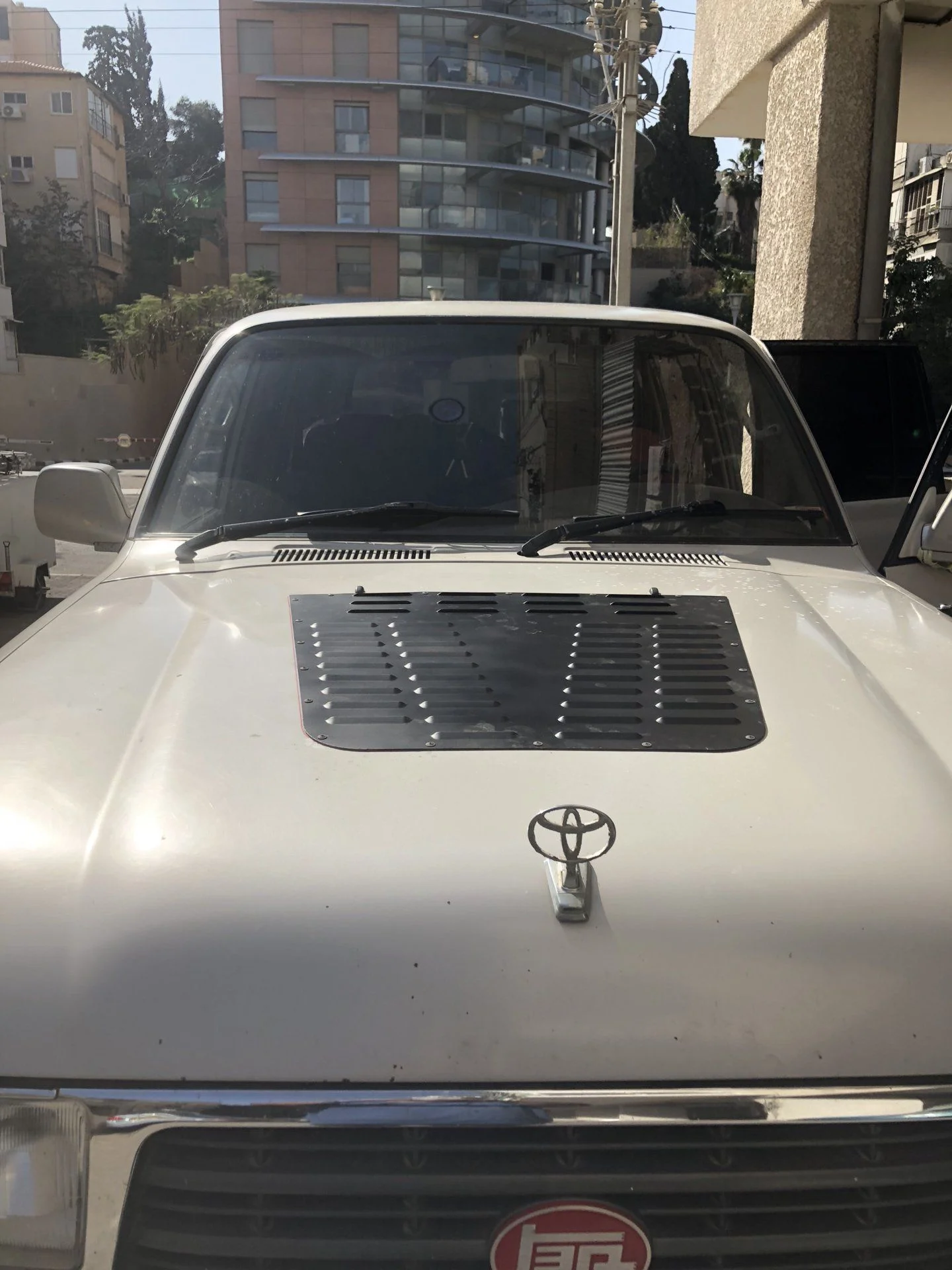

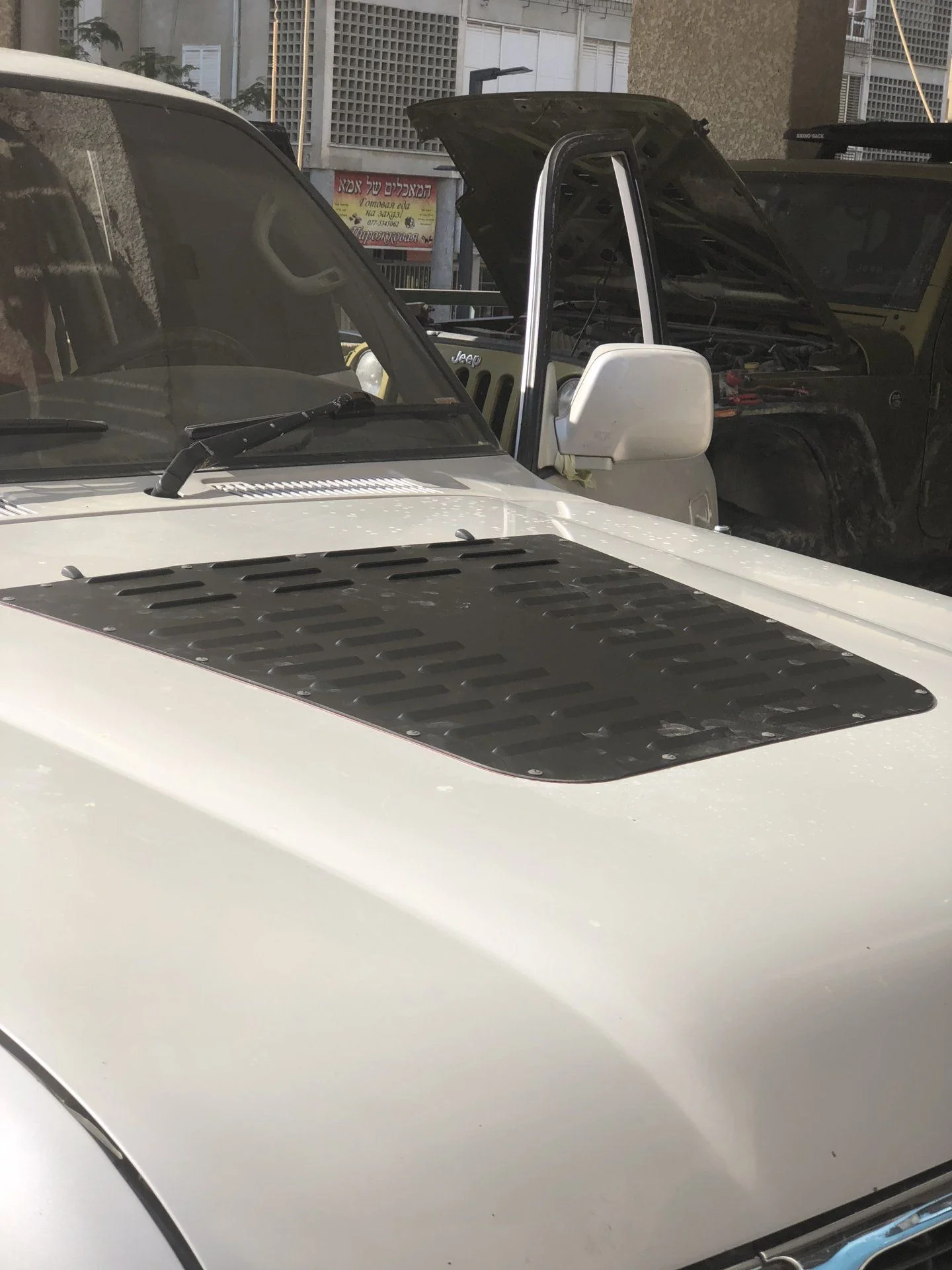

reduce the heat in the drivers cabin
That looks pretty cool
same one as the jeep in the background, I'm guessing :hillbilly:
So... Why are your windshield wipers backwards? I don't recall mention of that in your build thread.

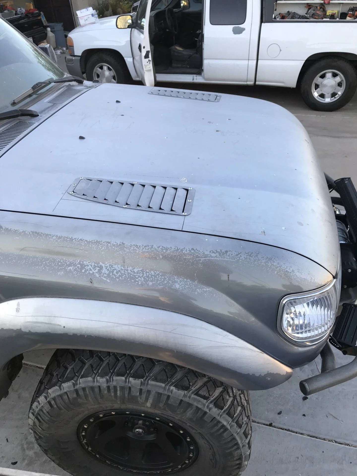

I installed smaller vents, used to get needle climb when going up a certain grade dragging my gear, didnt do it the last time i went up with the vents on, same temps out. Also, engine bay doesn't hold the heat in like it used to, but i live in az and heat is the killer here, not the cold. If i lived in a cold climate, i wouldnt run them. This summer will tell me if the ac doesnt “warm” at stop lights. My prediction is it will, but not as fast and get cooler faster.
The only difference between no vent and vent was i added a rack and an awning, so extra drag. Im happy for my $90 purchase.
