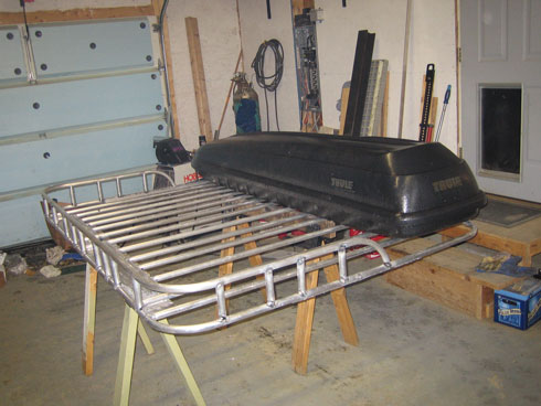

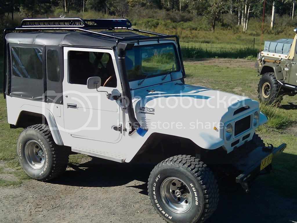

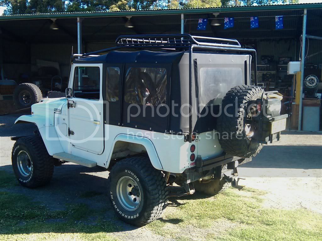

homemade aluminum rack
The rack for my BJ42 was the first time I ever welded aluminum. It was a little bit of a learning curve. It's light, about 78 pounds. Made of 5356 1" Al tubing.
If you're curious about it I documented the build on my personal blog at Custom Land Cruiser Roof Rack Build (Part 2) | Rufus The Doofus, Custom Land Cruiser Roof Rack Build (Part 3) | Rufus The Doofus, Custom Land Cruiser Roof Rack Build (Part 4) | Rufus The Doofus, Only One More Day, Maybe | Rufus The Doofus.

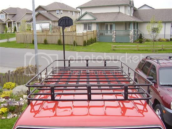

Just finished my roof rack. File it under basic design. Used gutter mounts from tallowpot.com Don't have any great off road pictures yet. Just parked in front of my house. Maybe next weekend...
