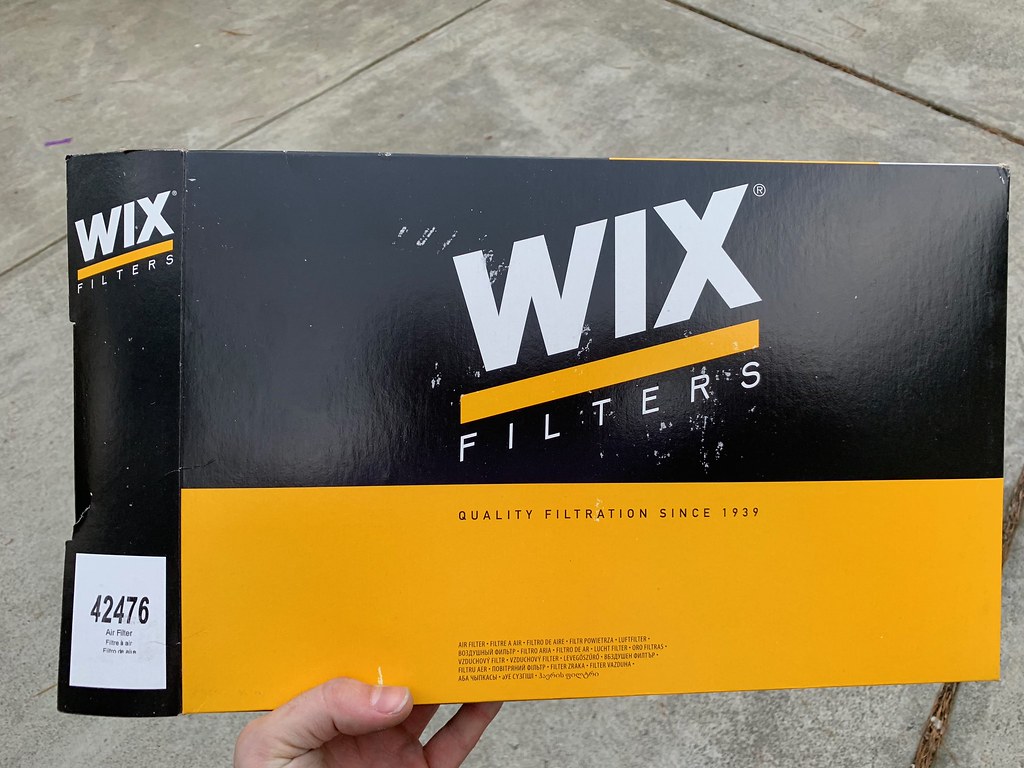

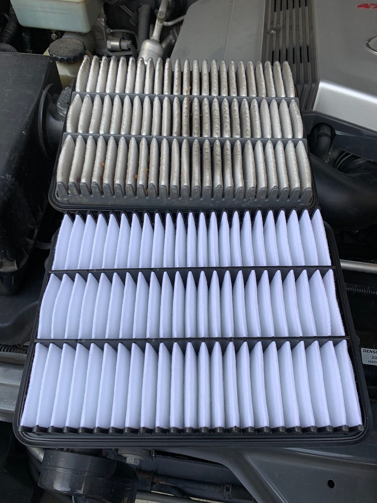

Did a common maintenance item today. Replaced the air filter with a Wix unit.
