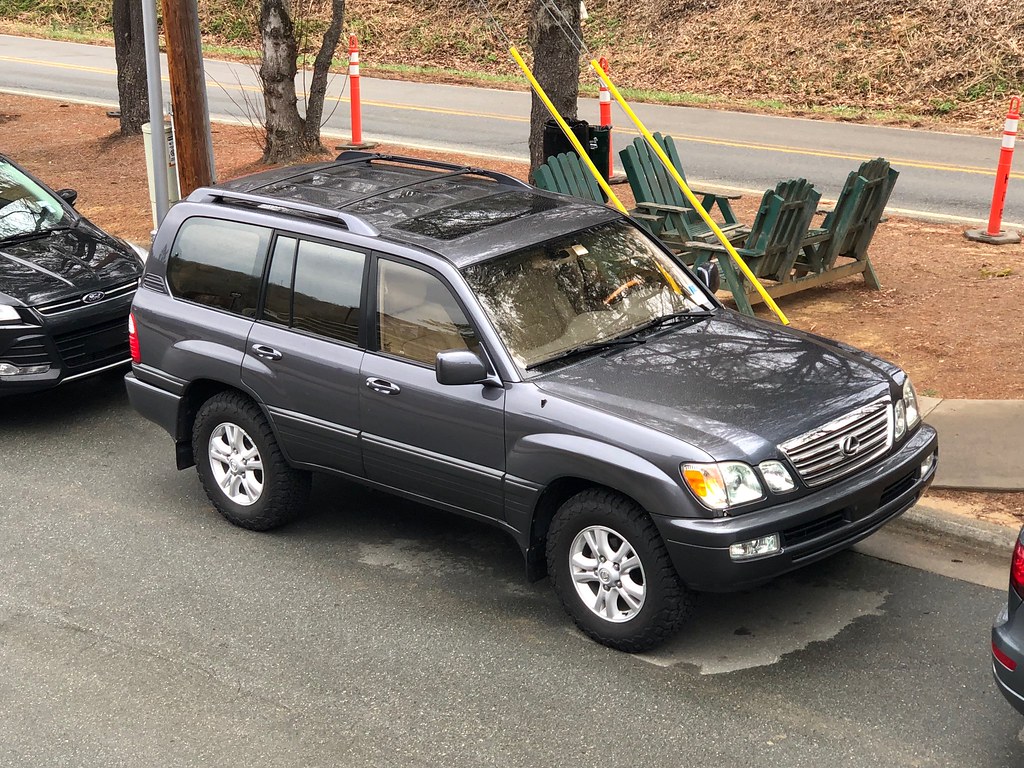

Gave her a bath yesterday.

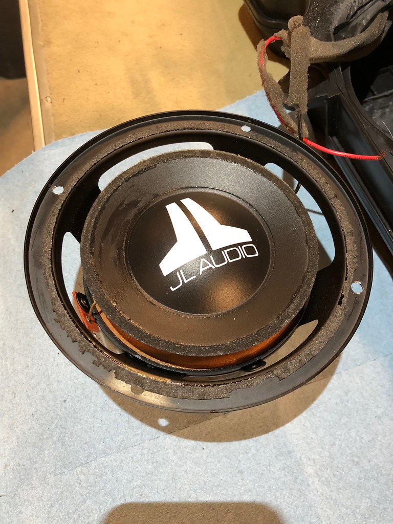

Ever since I've bought my truck in 2016 the sub has been blown and the front passenger lower door speaker has rattled. I recently got the motivation to order the re-foam kits from simplyspeakers and installed them tonight.

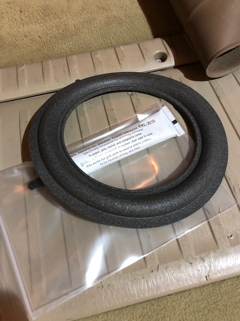

I ordered the 6" kit for the sub and 1 front door speaker. $22 shipped from their eBay store.
I also ordered a 4" kit for the rear door speakers and may do them this weekend.

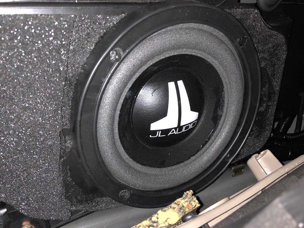

When I bought the truck, I got it home and realized the sub was actually the upgraded JL sub that the PO had had installed. It was blown though so I just unplugged it.
Here it was torn down:
And the foam piece that was used:
After removing the old adhesive and foam bits with a razor blade, I installed the new foam and whallah! New speaker foam! I used a little too much adhesive so it dripped down into the cone a bit...whoops.

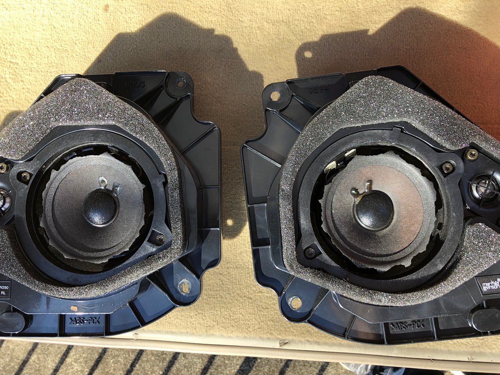

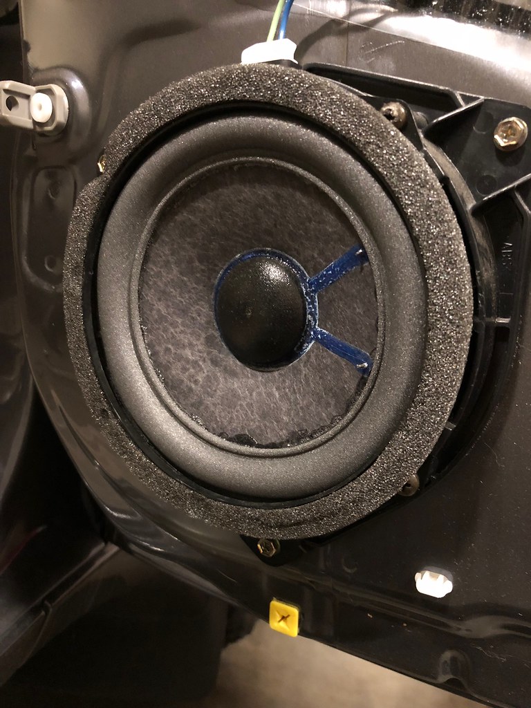

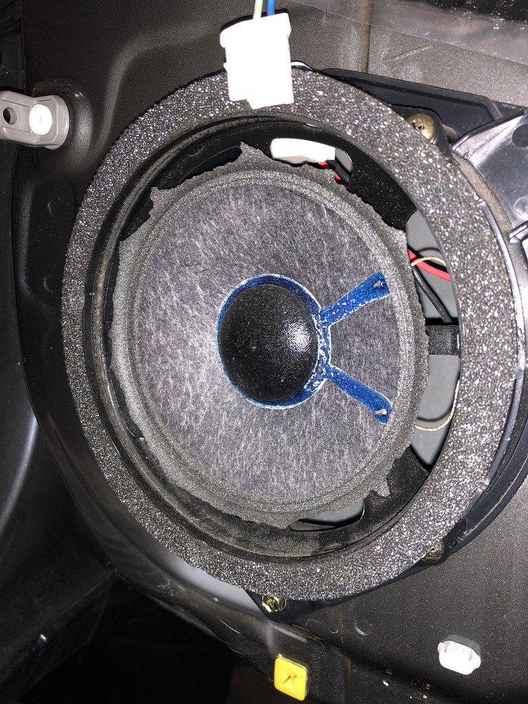

Next up was the front door speaker. I had already checked the driver side one for another project shortly after buying the truck and it looked like the PO had replaced that speaker already with OEM ML or had it refoamed already. I pulled the passenger door card however and was greeted by this...
The foam had completely disintegrated! No wonder it sounded like crap. That foam was replaced as well.
I let the adhesive set for the 1 hour per surface and briefly tried it out. Sounds way better! No more rattles. Will let it finish setting overnight and will work it out on the way to work tomorrow. Initial impressions are very good though, especially for only $22!

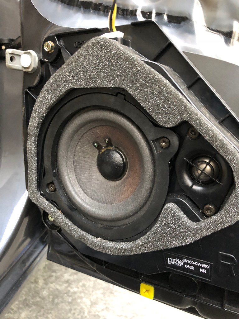

Well after spending most of the weekend prepping my 2009 335i for sale with a full paint correction and detail, I got around to replacing the foam on my rear door speakers.
When I opened up the door panels I was once again greeted with completely blown speakers.
And all fixed!
The rear sub also still sounds like it's blown so it may be something else wrong besides the foam. I ordered a cheap amazon Pyle sub to throw back there to see if it will give the system a little kick. If it doesn't cut it then I'll wire in my 10" JL sub that I have leftover from my old Tahoe.
Pyle Sub: https://www.amazon.com/Pyle-PLPW6D-6-Inch-Watt-Subwoofer/dp/B0071HY42K/?tag=ihco-20
Tore apart the rear to take the JL sub out again. Found out the "blown" sound was actually just the spacing between the sub and the box due to the shotty trimming job the PO did. Did some work and took some foam and sealed it up. Sounds great now!.....or as good as a 6" sub can sound...

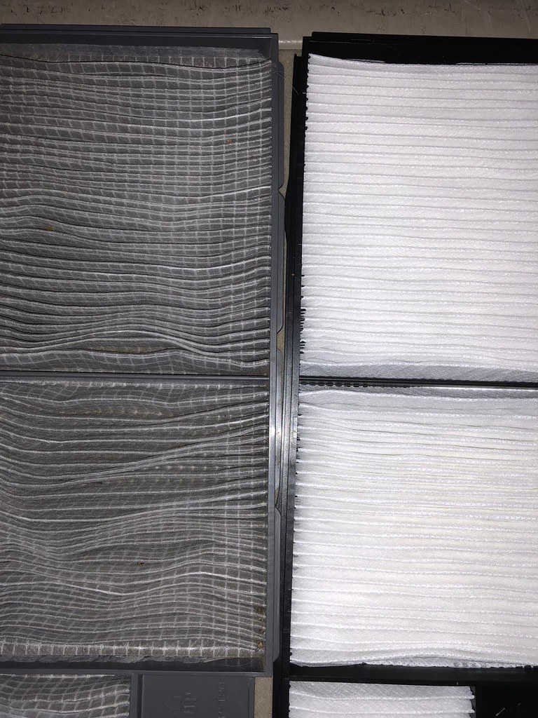

Got some more maintenance done. Replaced the cabin filters...gross.

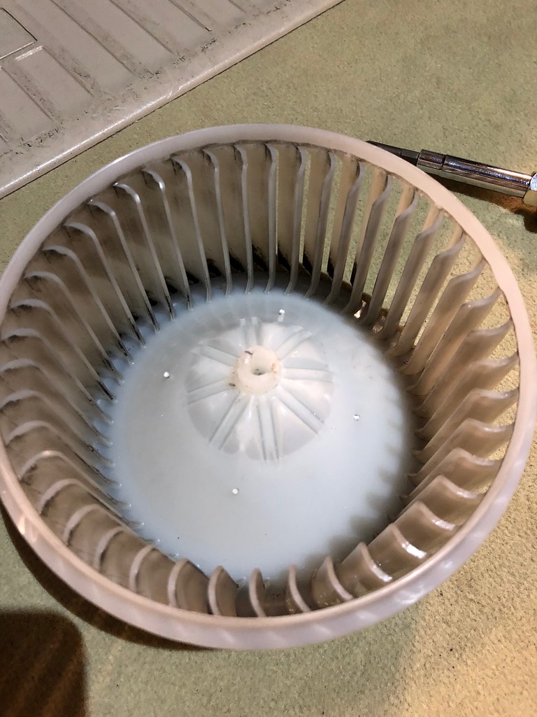

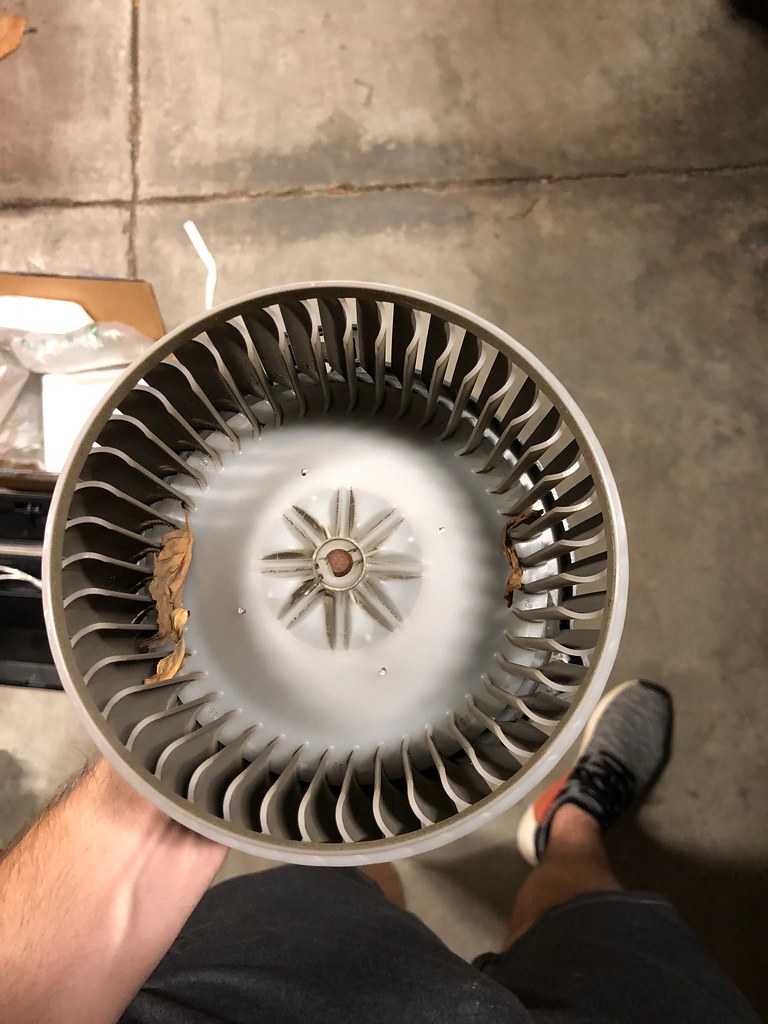

Also pulled the blower motor and cleaned it out, removed the plastic fan and soaked and cleaned it as well.

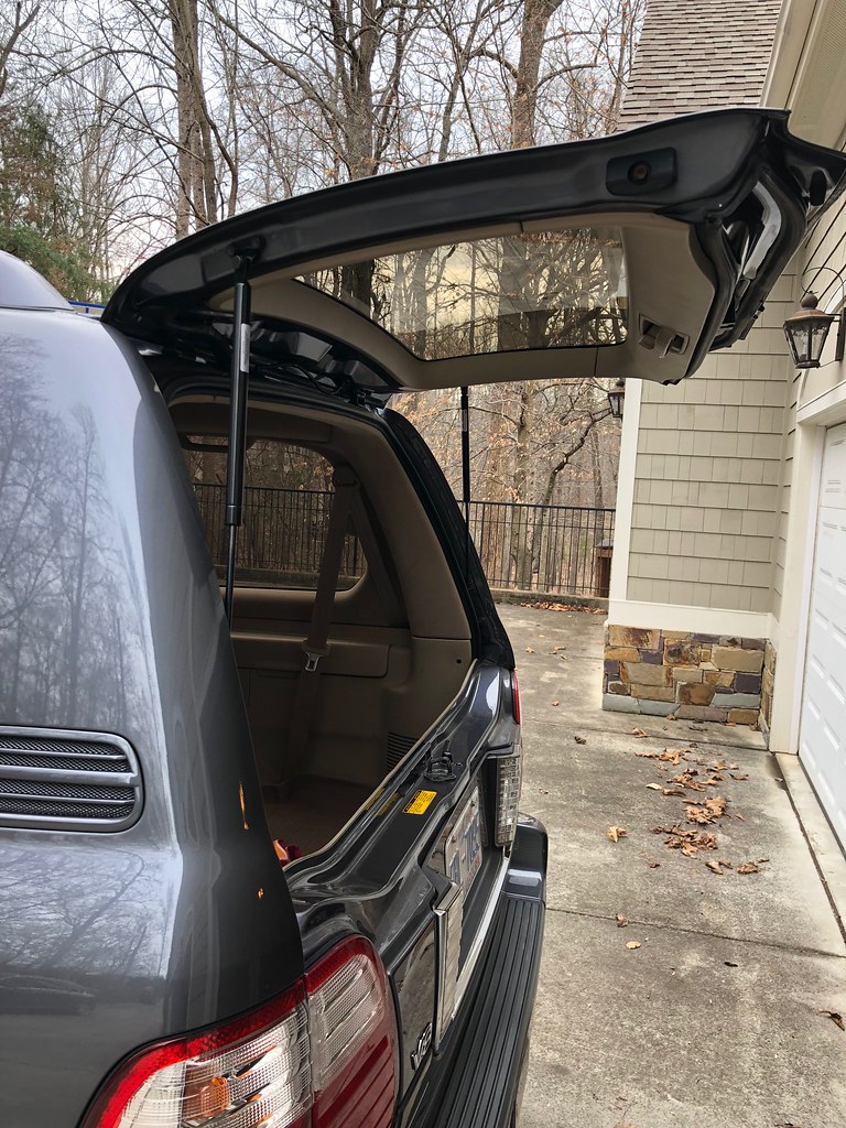

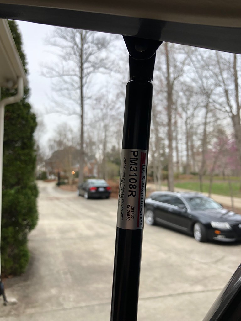

Then replaced my rear hatch struts so they actually work now which is nice. They've been weak since I bought the truck in late 2016. Used the "liftsupportdepot" struts from Amazon which were $34 or so.

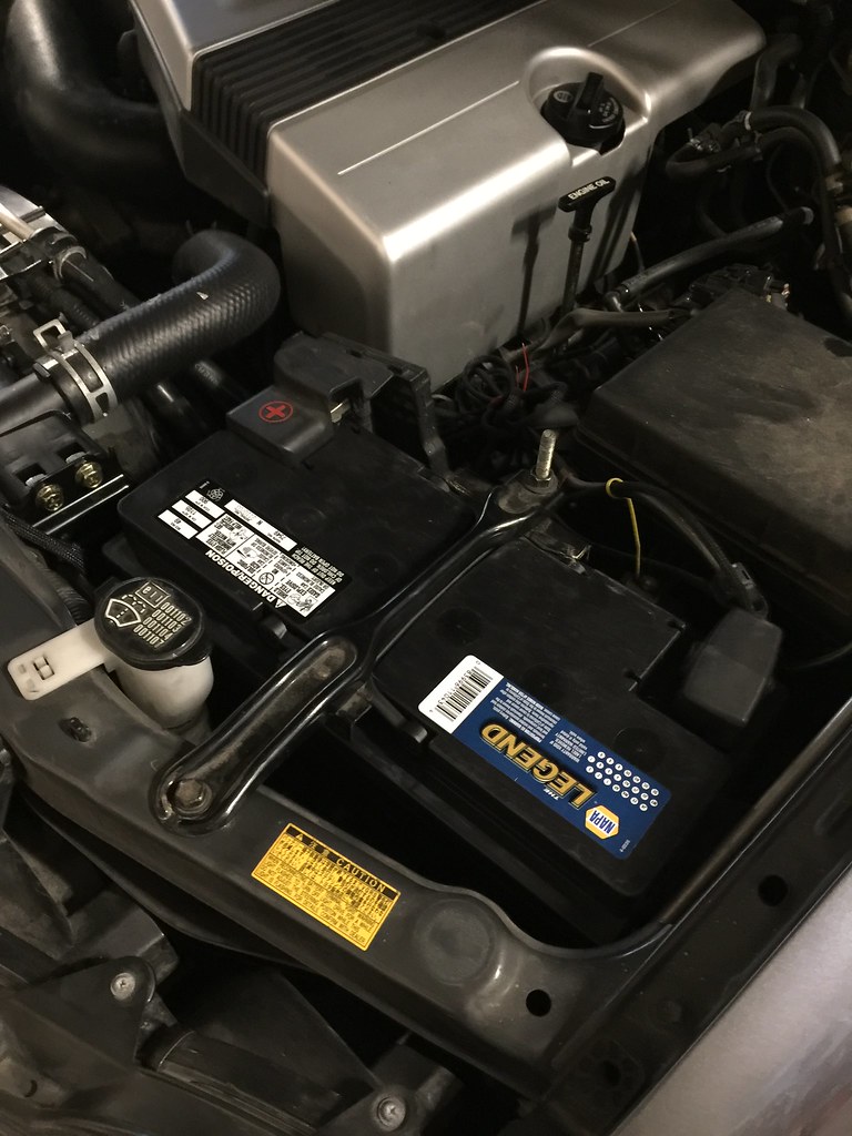

Also, what Battery is that? Size-wise?

Pretty sure it's this one: a Group49
Battery - NAPA Legend 75 Month 12 Volts Group 49 900 CCA Top Post

Yup, that's the one. Fires up the truck and all 4 of my HID's in below ZERO temps with no issues. Spent 6 weeks in Buffalo NY from January to mid February and worked flawlessly. It's a monster battery.

I take it that you're pretty happy with it then? I'm in the market for a new battery and this one is now at the top of my list. Was considering going the AGM route. But, as I understand it, they don't like being "jumped" (I have a NOCO battery jumper as a backup) and they are CRAZY expensive.
The CCAs on the NAPA definitely more than cover the J100 needs. Very curious about the reserve capacity. I don't run a ton of electrics when I camp (most of my equipment runs off the Ryobi 18v portables). Do you think the RC on the NAPA is enough to run some LED camp lights and the stereo for a few hours without killing it?

The CCA are definitely overkill but the truck was with my girlfriend in NY so figured more can't hurt.
I can't really comment on the RC of the NAPA and ability to run the lights and stereo as I haven't really subjected it to that kind of use. I have kept the interior lights on with the stereo on sporadically over the course of an hour or so while installing my new speakers and the truck had no issue firing back up after.

Price is right for sure and everything else seems in order. Think I'll go get one before HIH8. Fitment looks like it wasn't much of an issue at all.
Battery fits fine. It is larger than the tray underneath but I just left mine as is. The better thing to do would be to get a larger tray.
