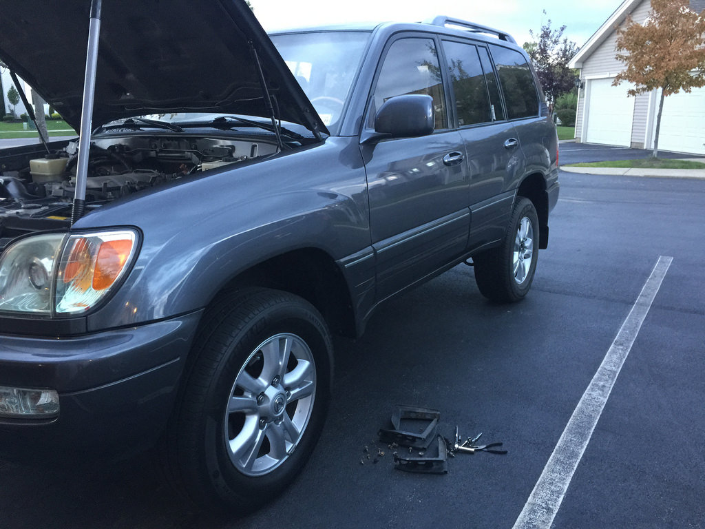

Once I checked over the truck and realized it didn't need anything, I started doing the first modifications. First up was removing the running boards. Simple task, took around 30 minutes.

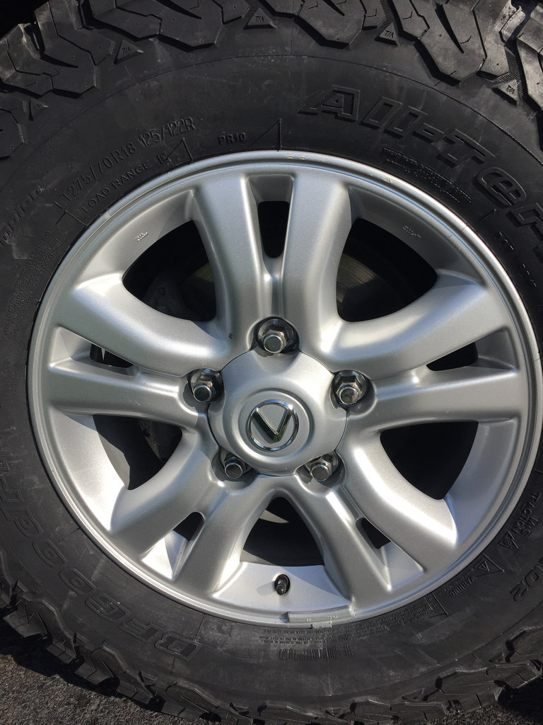

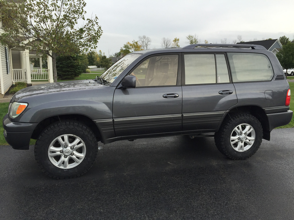

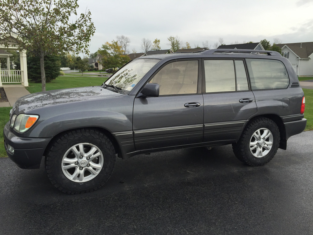

Next up was new tires as I had an old plug work it's way out of one of the tires and realized that the tires had quite a few plugs in them. I went with (5) BFG K02 275/70/18 courtesy of Dunn Tire. They look great to me at stock height and I have no clearance issues in N or Low. Spare fits as well with the larger tire.
Low:
N:
High:

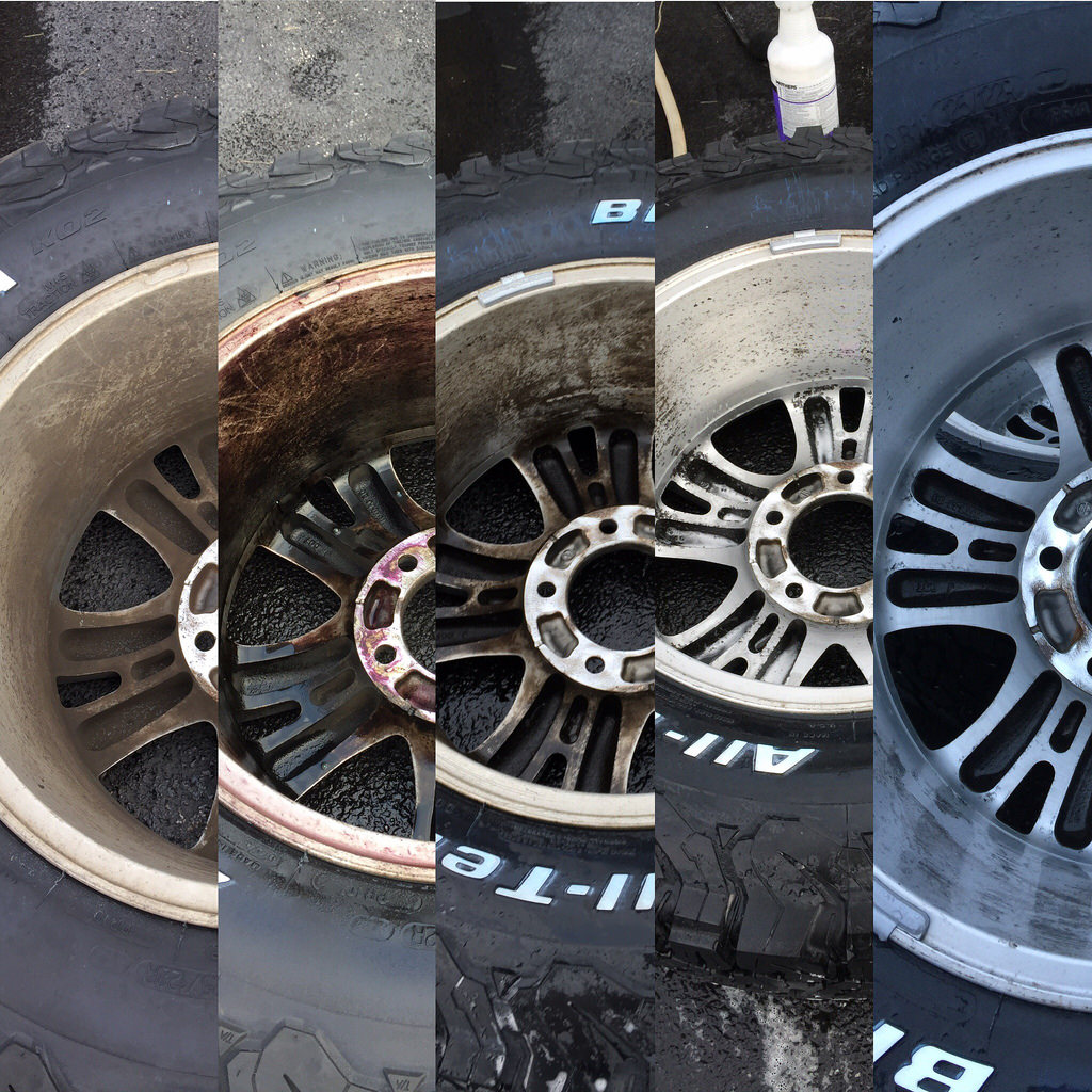

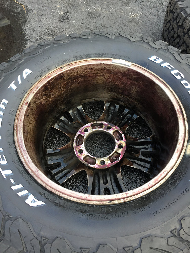

Since this will see snow/salt I will be protecting the truck to the best of my ability. I have been detailing cars for a few years now and the truck will be getting the full treatment; decomtamination, paint correction and ceramic coating. I started cleaning up the wheels with some Iron-X first before tackling them. This product dissolves the iron particles that accumulate on the wheels from the brake pads.

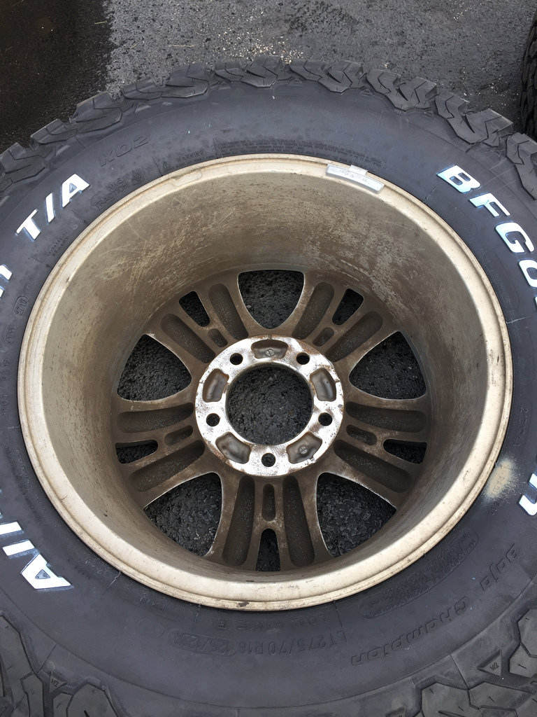

Before touching them:
Iron-X at work. It turns purple as it's dissolving the particles. This is something that normal cleaning can not remove.

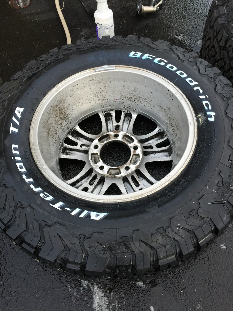

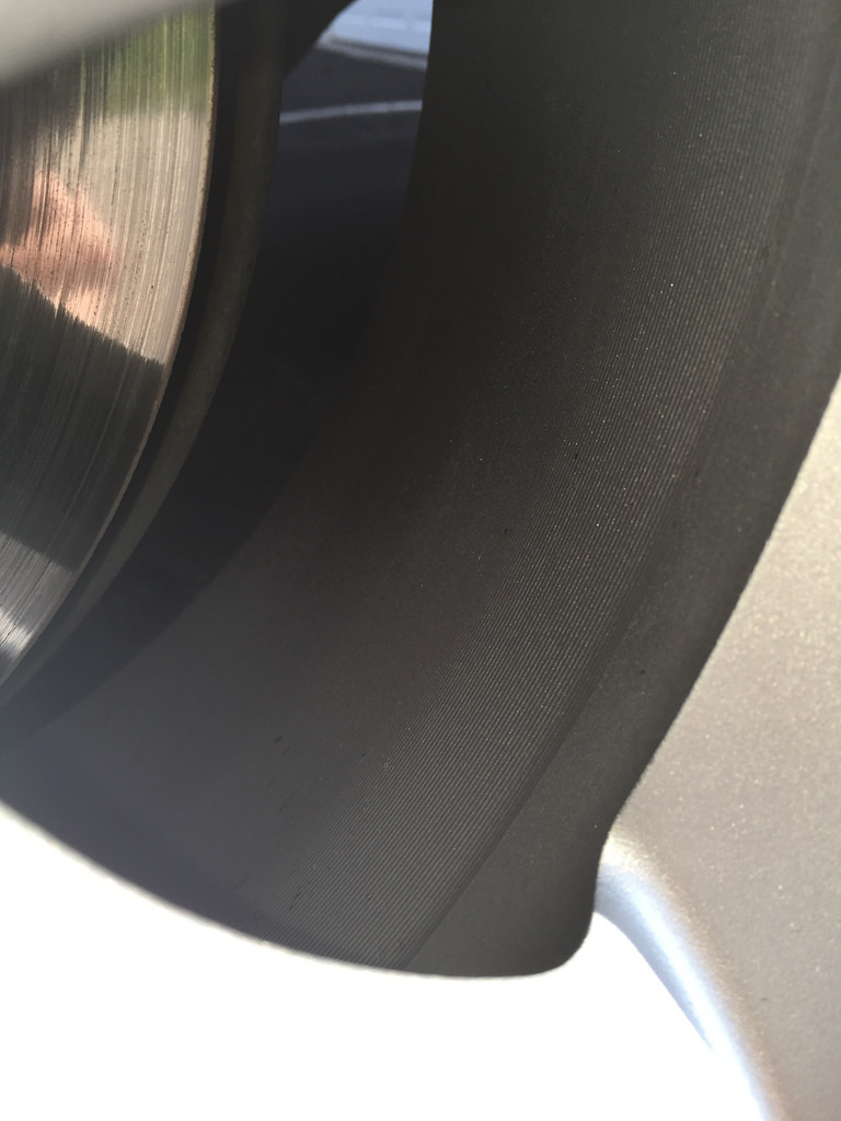

Next I hit them with a few rounds of cleaning with Mother's Foaming Wheel Cleaner and here are the results. There was a fair amount of oxidation/corrosion on the wheel barrels. They were worked on as well.
After some work on the barrels, removing the tar build up and knocking down some of the corrosion they were ready for coating. I wiped them down to get rid of any remaining oils and applied the ceramic wheel coating to the faces and barrels. These wheels are finally ready to take on the elements!
Insides:
Step by step:

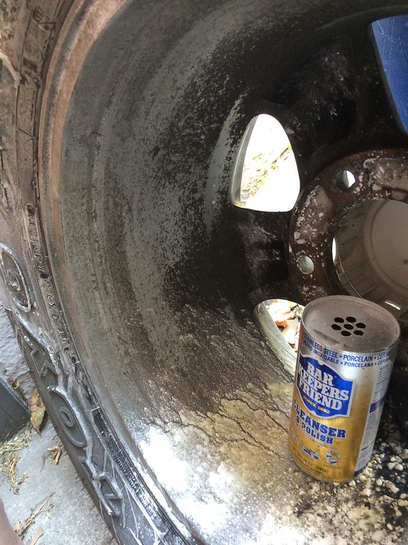

Okay my rim cleaning method kind of works but is a totally pain in the butt and you need to do it at least two times...
Thanks for the tip with the Purple wonder..
I use Red Power on my wheels. I cleanEd and waxed them before I got the new tires on. Any reason for the old school balancing weights?
Not sure. Just the ones the tire place used. If the wheels were in better shape I probably would have requested they used the adhesive weights. Not a big deal to me like they would have been on my sports cars.

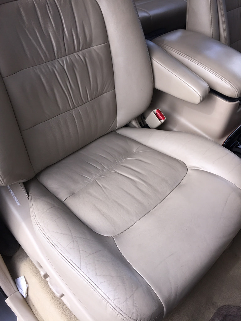

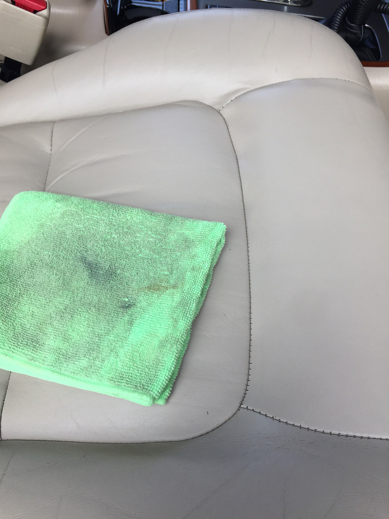

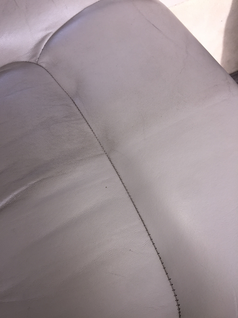

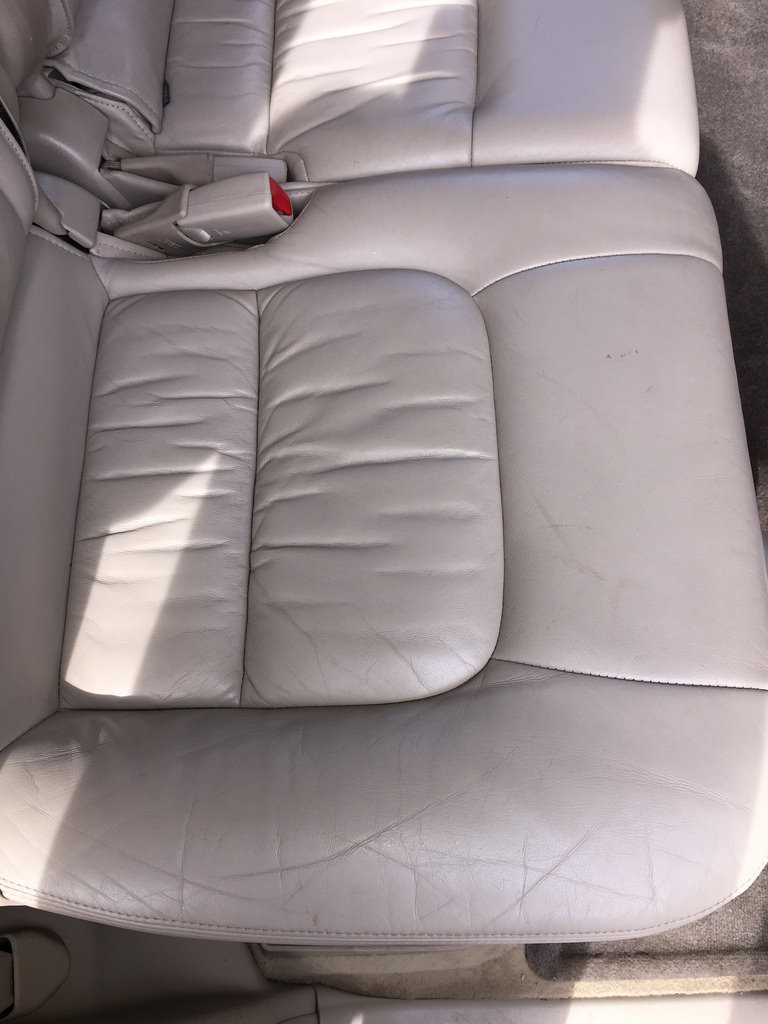

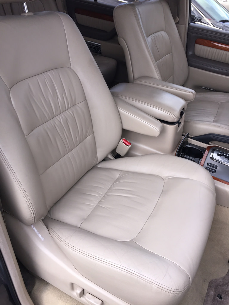

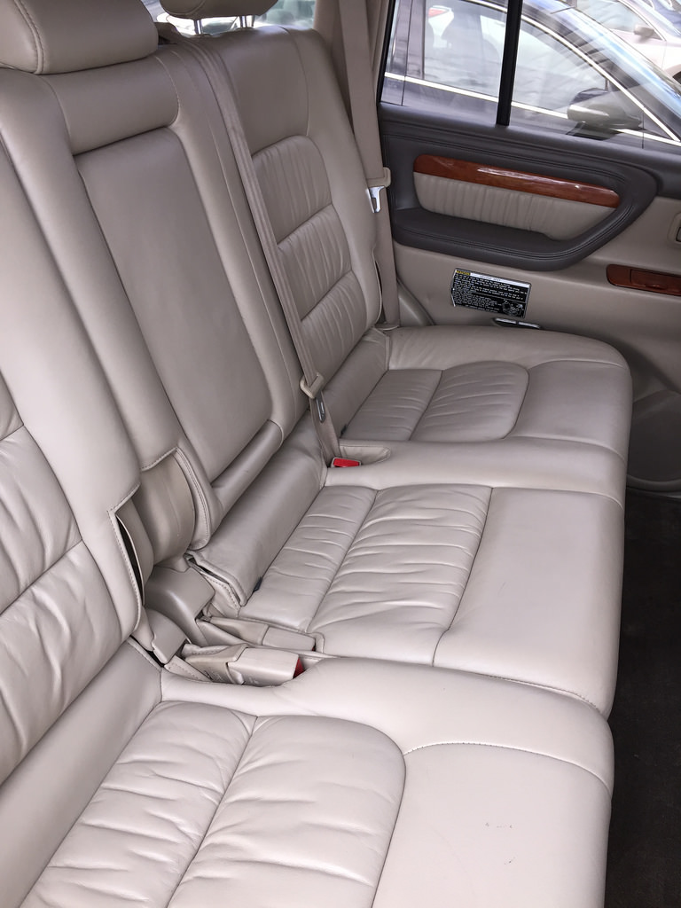

More detailing done today. Today I tackled the leather which didn't look to have been cleaned it quite some time. I did clean it quickly when I got the truck home but it really needed some time put into it to really extract the dirt and grime embedded into the leather.
I started with a leather cleaner but it wasn't quite cutting it so I switched to Einszett Deep Plastic Cleaner (one of my favorite interior products) which was able to get the majority of the grime out. I used a horsehair leather brush and had good results!
Before:
50/50 shots
After:
Back seat before:
After:

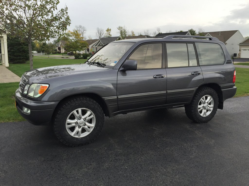

Bonus pic of her after a quick bath. Topped with GTechniq C2V3. First time using it so we'll see how it holds up.
Sunset:

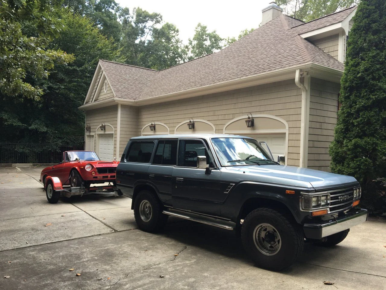

My brother Matt sold his BMW and picked up a pristine FJ62 which got me looking at these trucks.

Yeah he graduated. This is his truck along with his Datsun. He has a thread on here somewhere about it with more details. I love my LX so far though. Once I finish prepping it and protecting it, I'll be able to start modifying it.

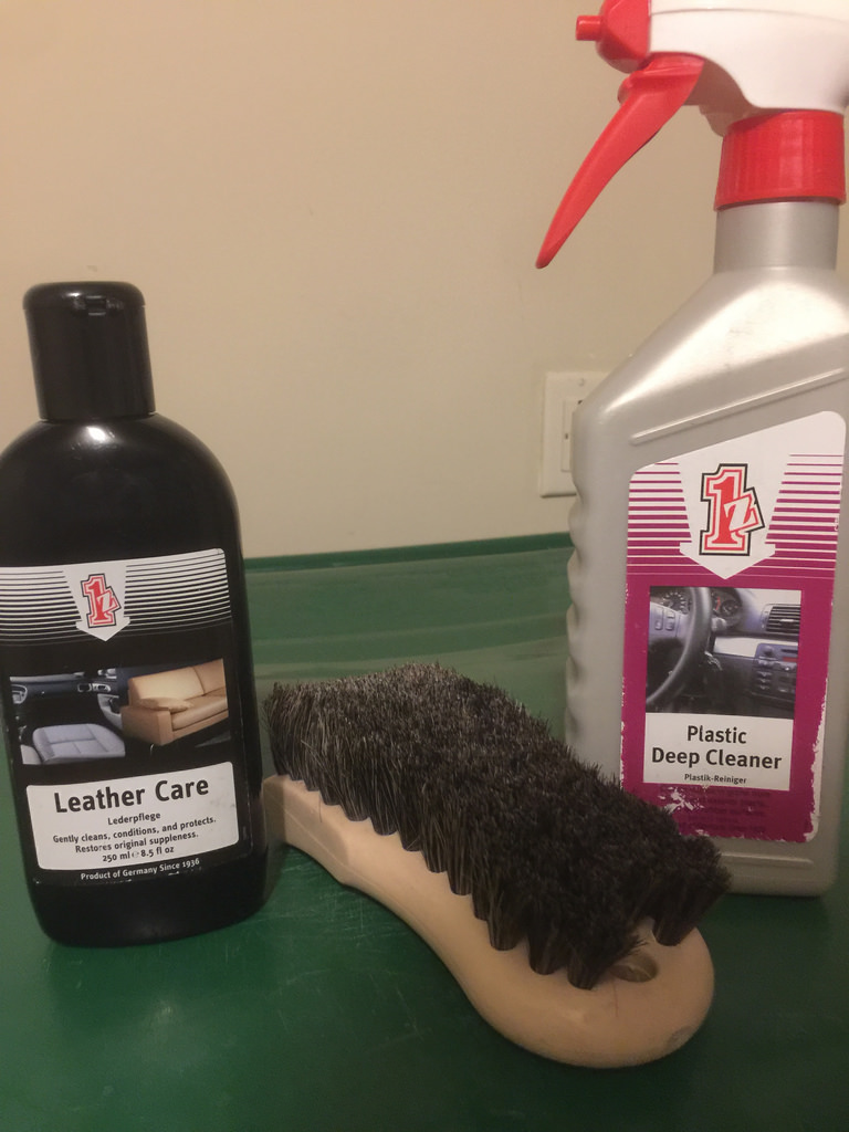

Got a link for the stuff you used on the leather seats. They turned out great. I need to do some cleaning on mine right now.
Thank you! Part of why I am posting all of the detailing work done on this truck is to help others out if they want.
I ended up using this cleaner: it is meant for plastics but is fine to use on sealed leather when you follow up with a conditioner.
Nextzett Plastic Vinyl Deep Cleaner Plastik Reiniger NEW LOOK!
and this brush:
Natural Horse Hair Interior Upholstery Brush
and I have a ton of different conditioners but I ended up using this one for this project:
1Z Einszett Leather Care
My products were older though so this is what mine looked like...

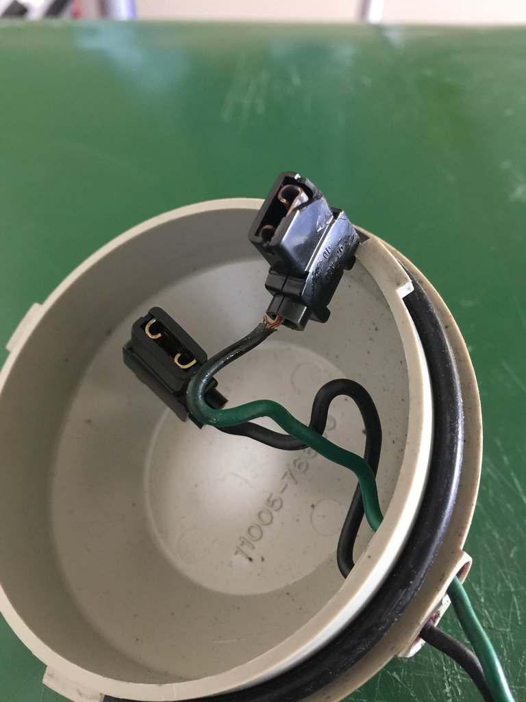

My passenger low beam has been intermittent since I bought it. Traced it to the leads going to the bulb fraying apart. Bought a new cap off eBay for $29 and put it in today!
P/N 81125-6A080 I wasn't able to find the correct part # online so I had to call the local dealer to get it.

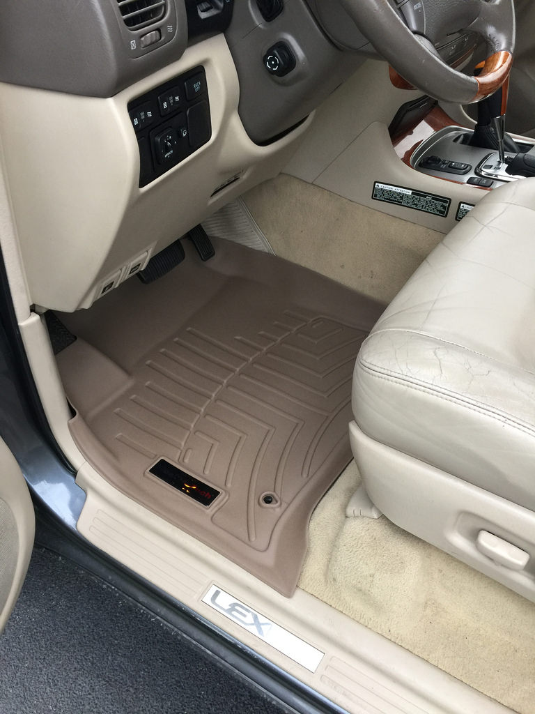

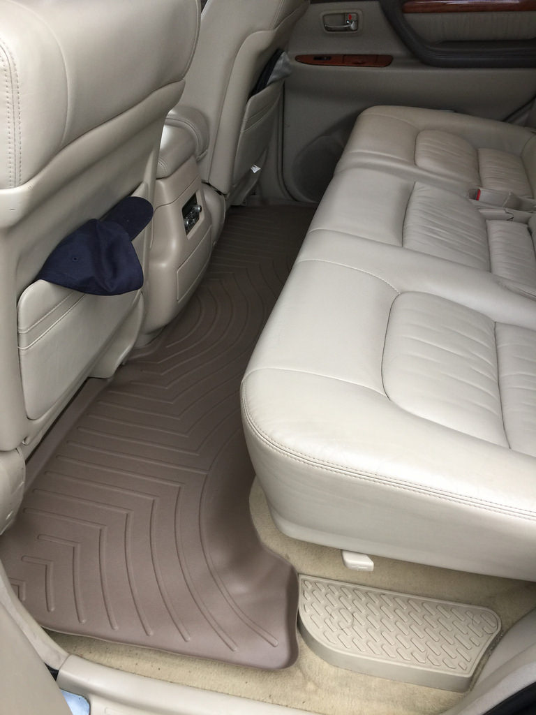

Continuing the winter-prep on the truck. Got some weathertechs for the front and back seats. The cargo area mat (for no 3rd row) is still in transit. I got it without the 3rd row fitment because those mats are skinnier and do not cover the whole cargo area. I will just take the mat out if I ever use the 3rd row seats.
