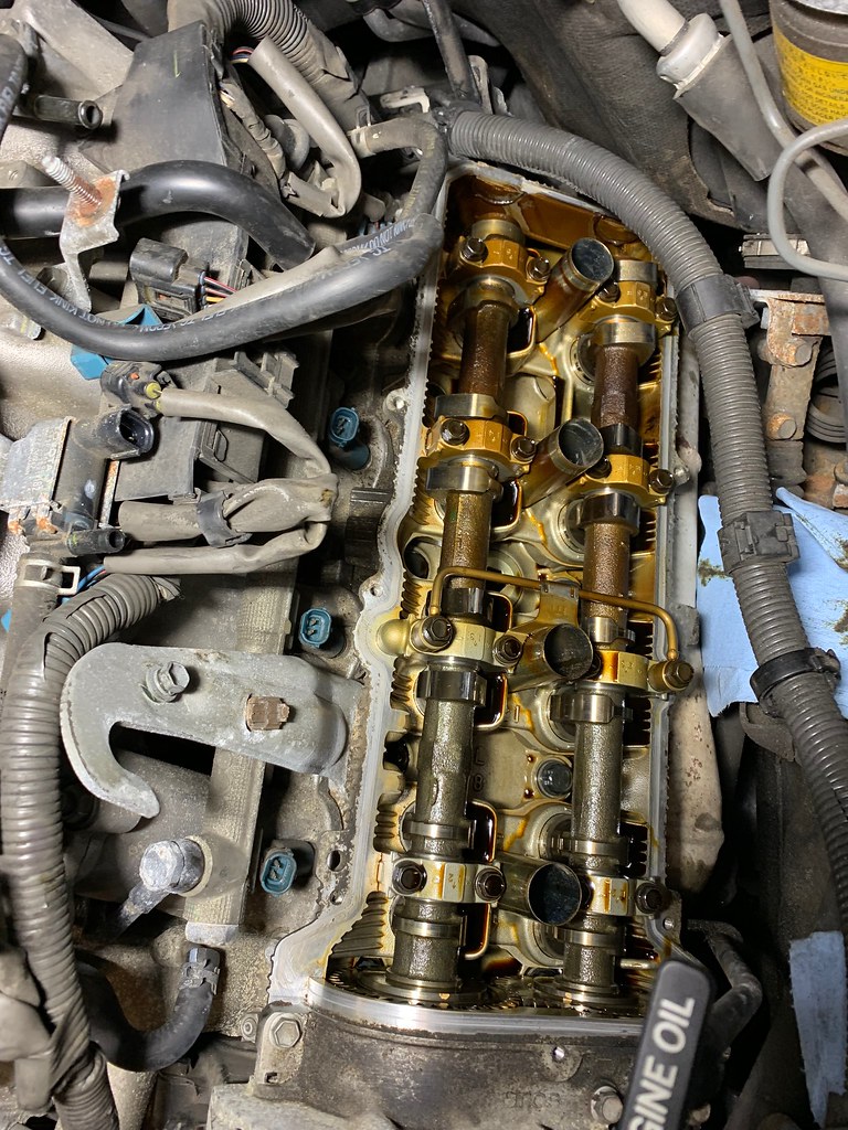

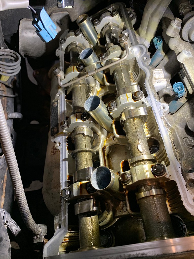

Got the VCG's done this weekend. It was straightforward with no issues. Going to roadtest tonight on the way to dinner but no leaks after idling in the driveway for a while. Replaced valve cover gaskets, all screw crush washer gaskets, and spark plug tube seals. Unfortunately the PCV I ordered was for the earlier trucks and was a slip in vs. a screw in so I ordered another which should be here tomorrow to replace mine. Current one isn't gunked up and still functions just fine but going to replace it for peace of mind.
I was planning to measure valve clearance while I was in there but completely forgot to. Oh well...
Insides were nice and clean at 201k miles!

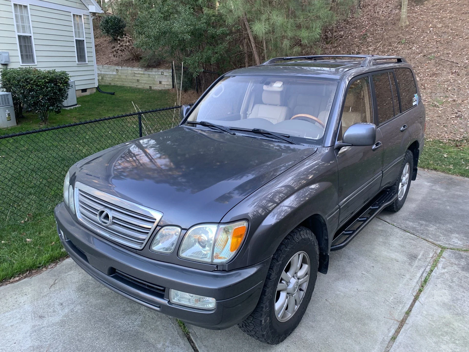

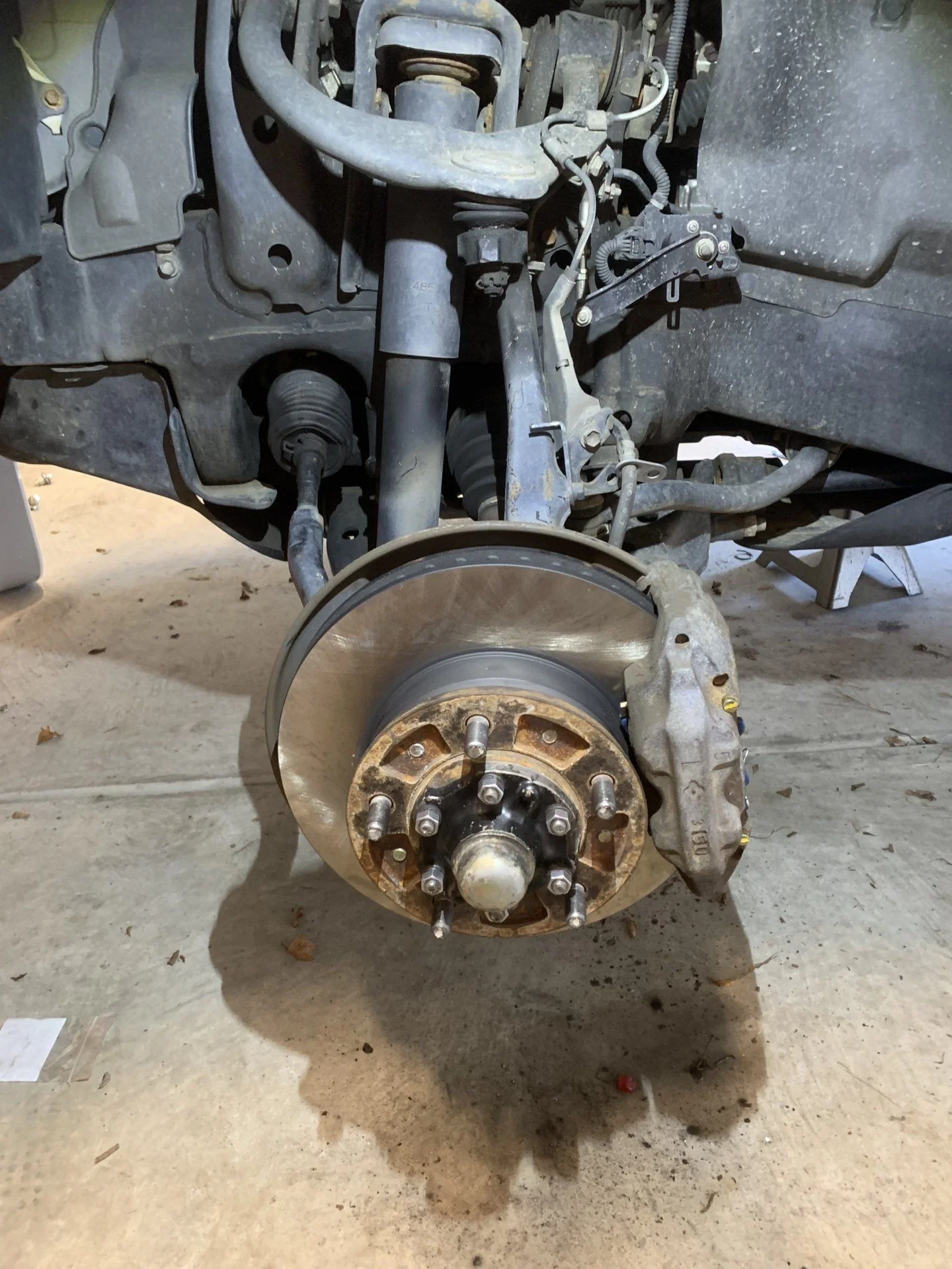

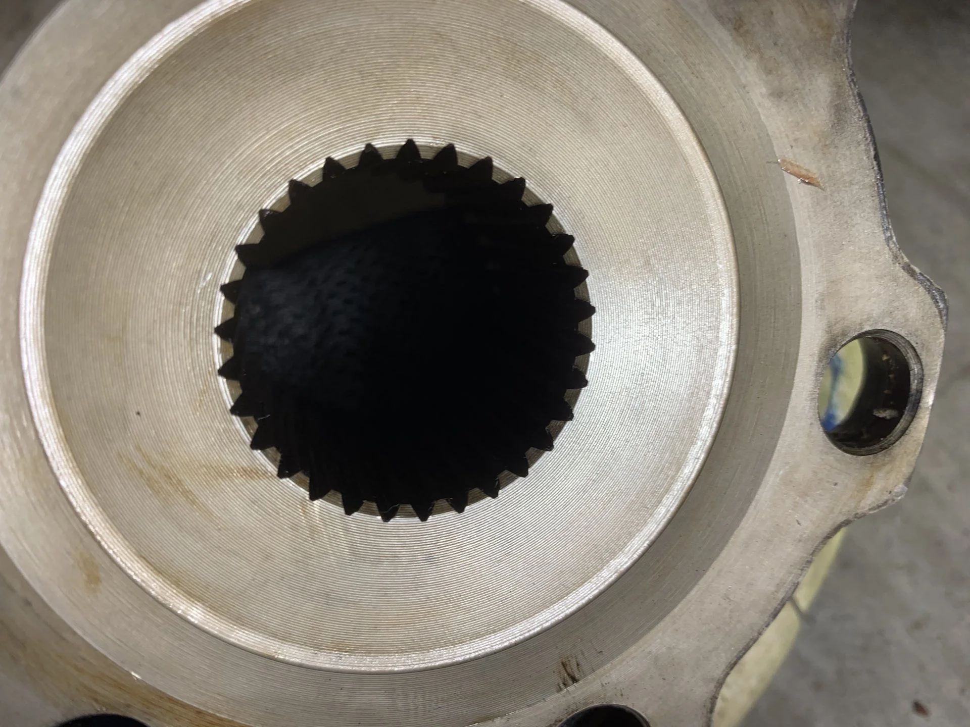

1. Truck got new Timken front bearings, seals and all associated hardware courtesy of @cruiseroutfit . Inspected the hub flange and axle teeth and all looks good to me. No odd or uneven wear that I saw.
2. Installed a new set of OEM Toyota brakes F&R to replace the CRAPPY Powerstop setup. Should have gone OEM to begin with...

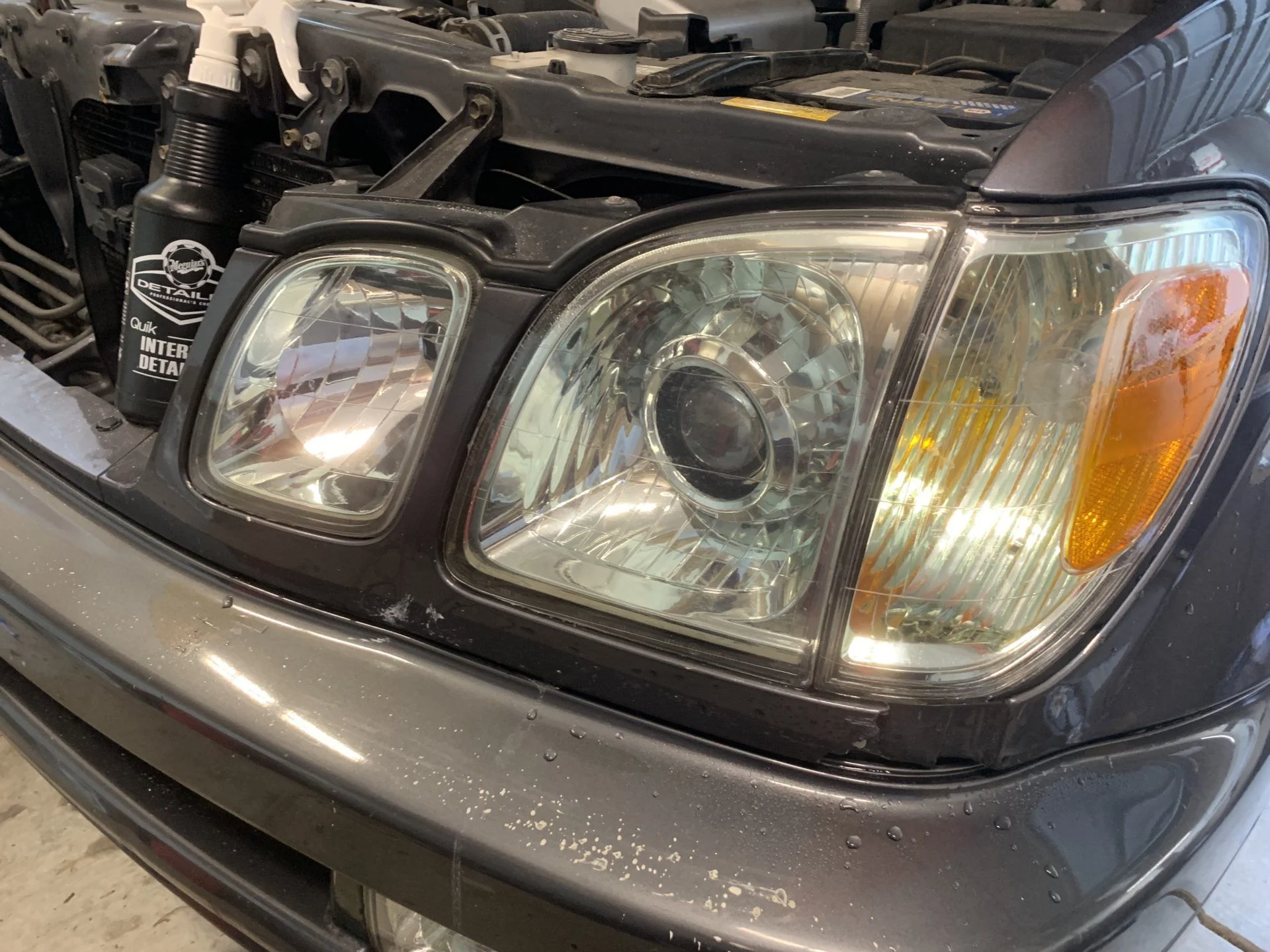

3. Polished my headlights and installed a set of Lamin-X films on all front lights.

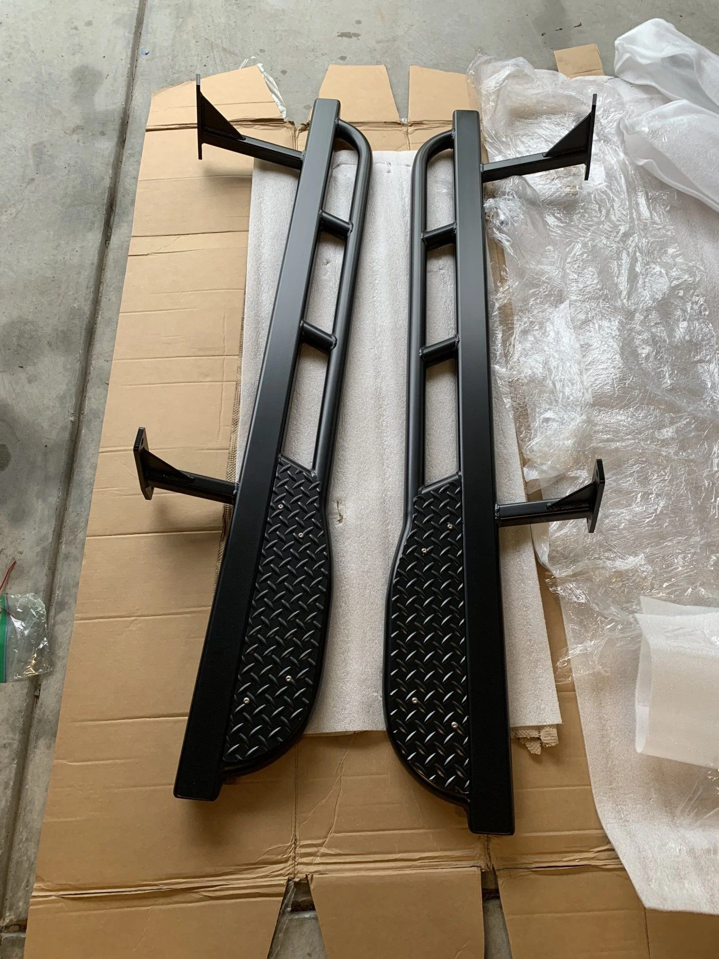

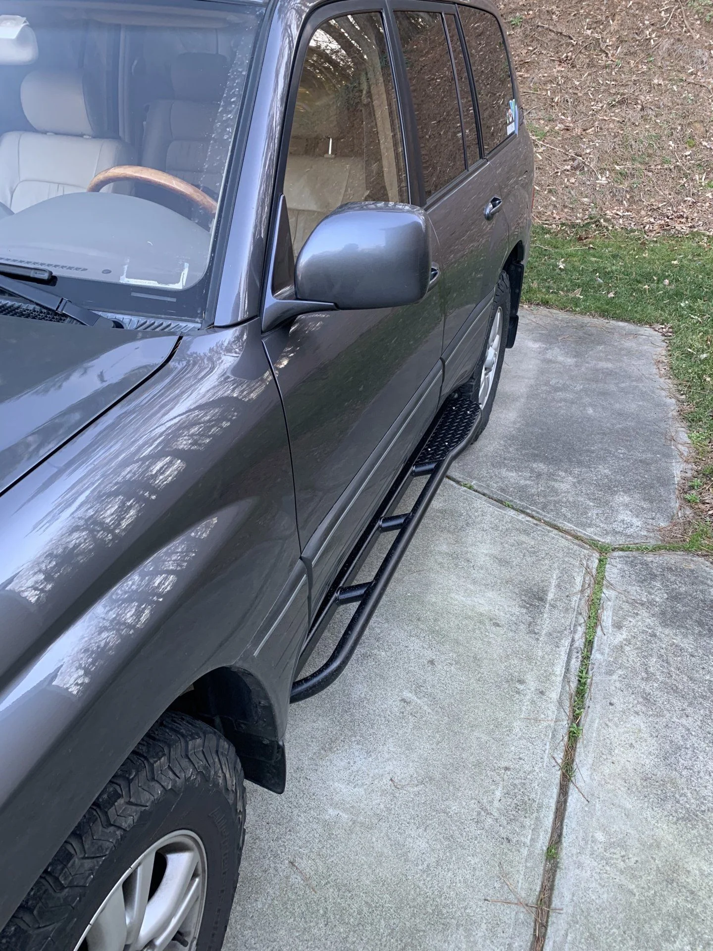

Added my first piece of armor. Bought some WKOR sliders during their black friday sale and they showed up this week. Went with DOM tubing, rear diamond plate and 10* angle so that my shorter fiance can use them as a step.
Looks sharp!

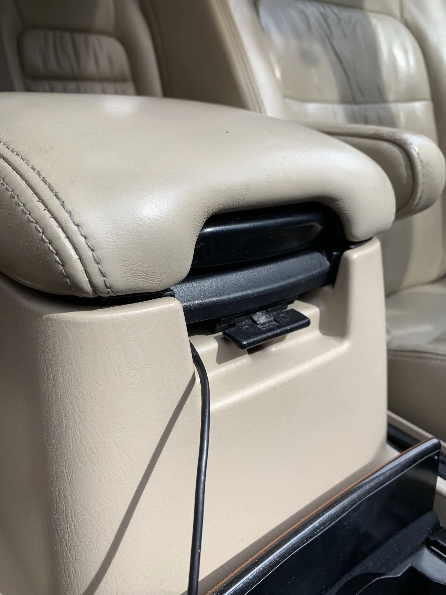

Also replaced the center console lock which has been broken since before I bought the vehicle. Such an easy fix and no more flopping center console lid!

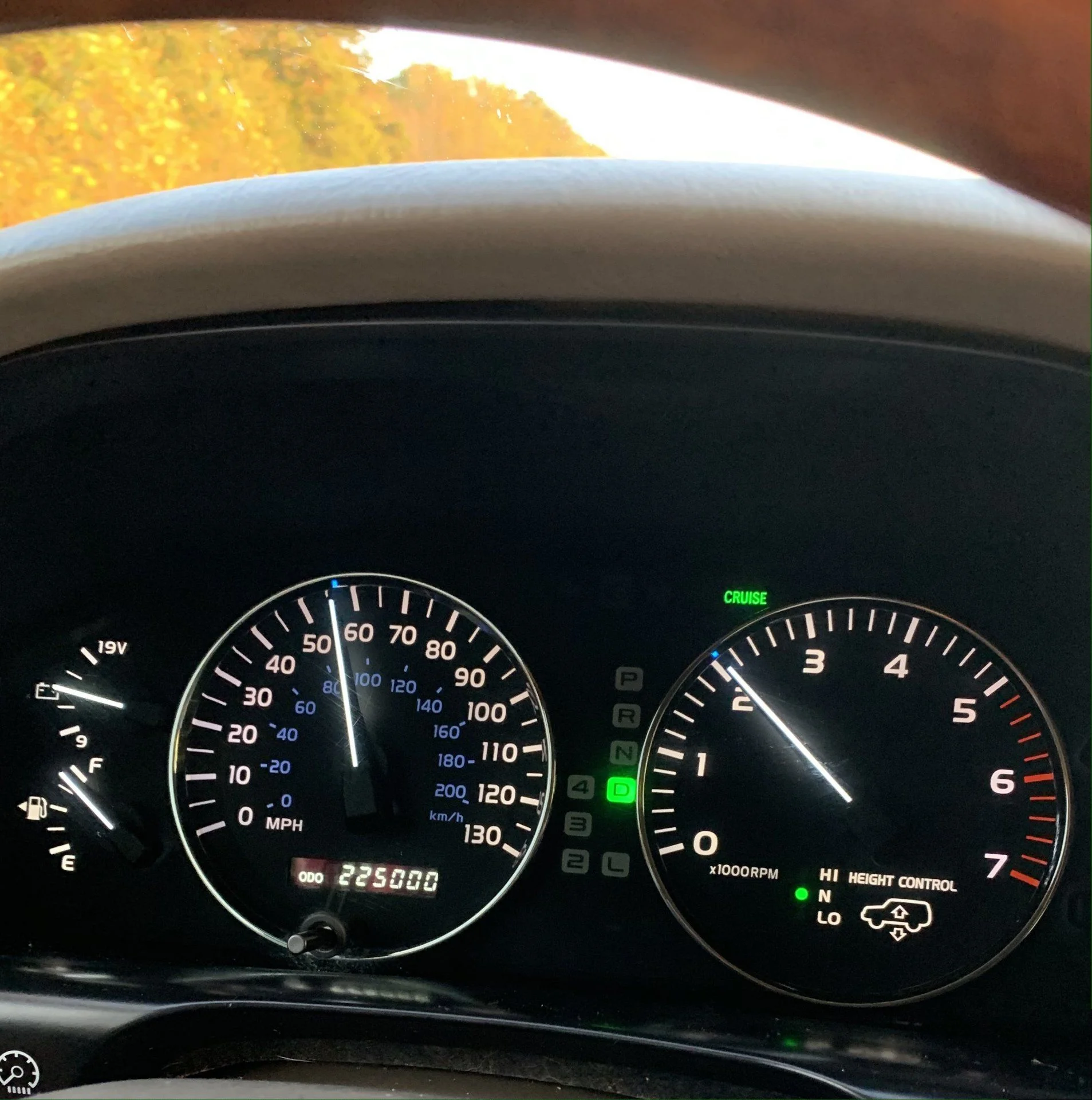

Been a few months so update time! Just rolled 220k miles this morning!

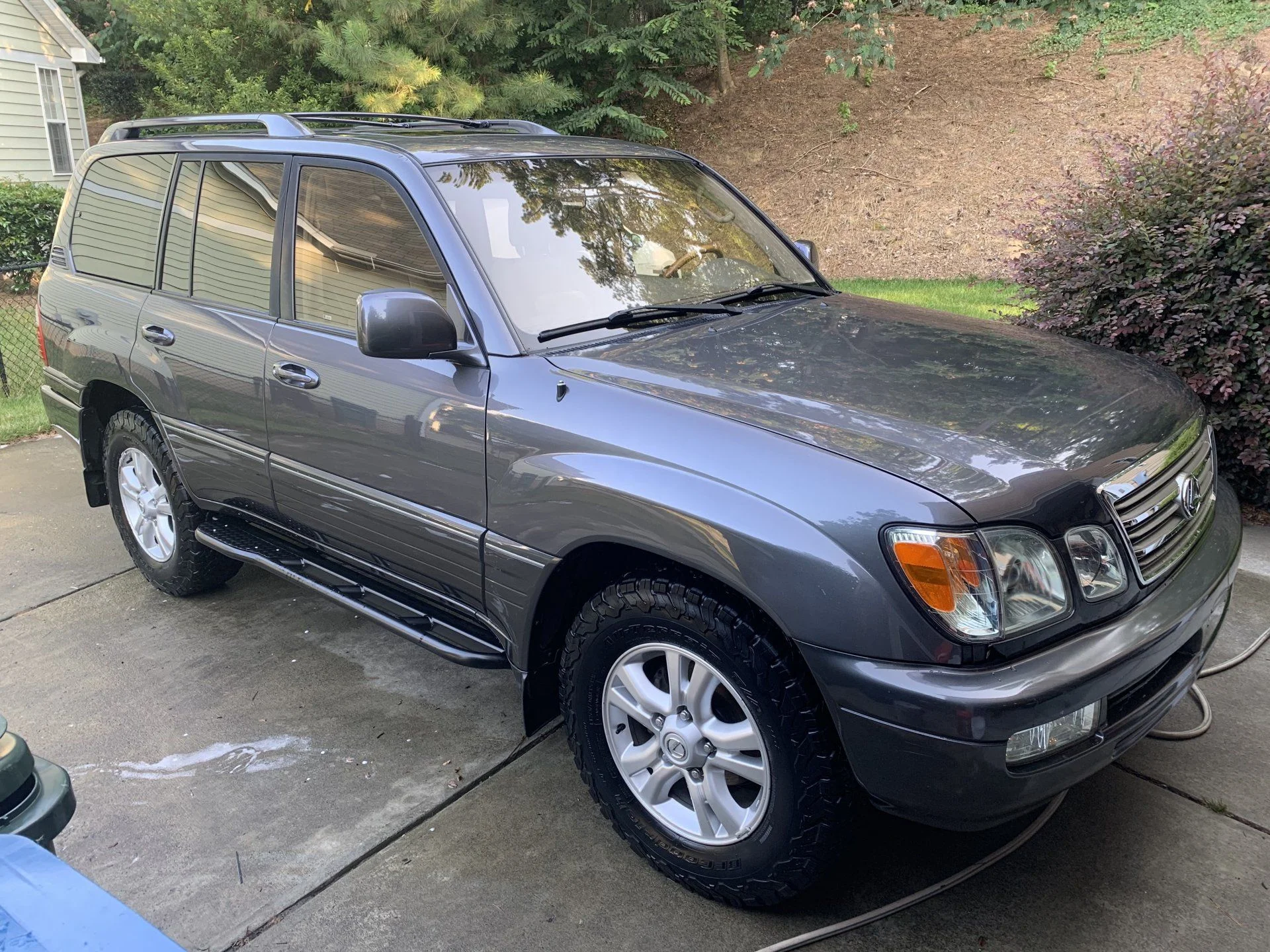

- Did a fresh paint detail on the old girl. Decontamination (chemical and clay),2-stage paint correction, and ceramic coating. I really enjoyed the GTechniq CSL+EXO ceramic coating combo last time so I opted for it again. It's been 3.5 years since the last coating which is pretty good durability. Coating still had some life left but early stages of quarantine had me looking for things to do! Paint needed the decontamination BAD after sitting outside pretty virtually every day since I bought it. A couple rounds of claybar and a spraydown with Ironx and paint is as smooth as a baby's butt once more! Not a dramatic difference since it was already coated and still washed up to damn near perfect (for a 17 year old truck) but corrected some light scratching and removing the contamination embedded into the paint improved depth and clarity.
Pic is after 2 months or so. First wash.

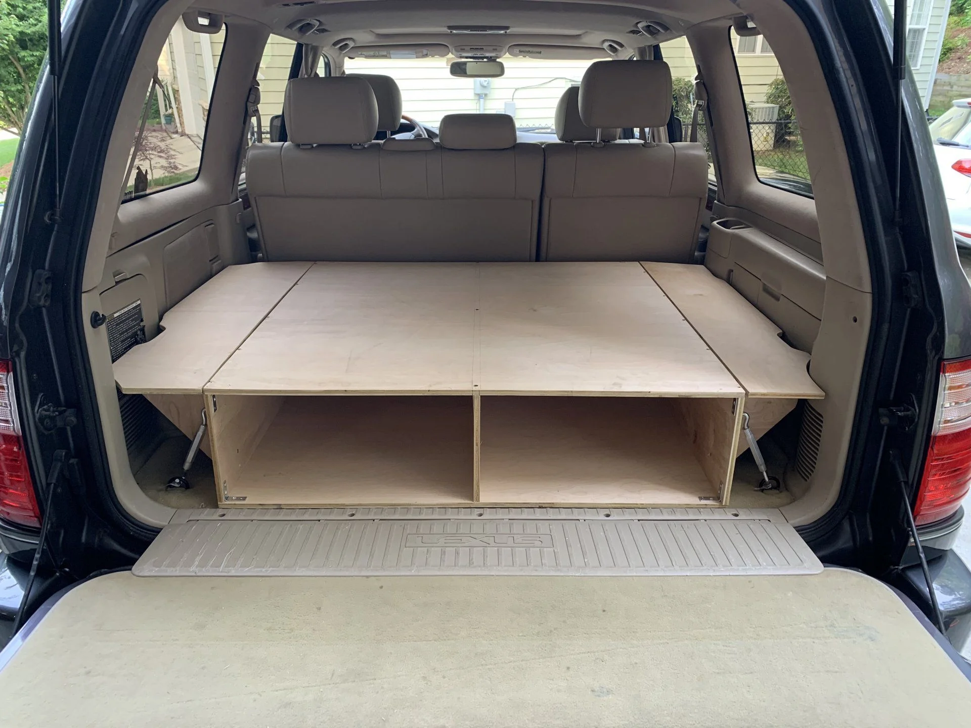

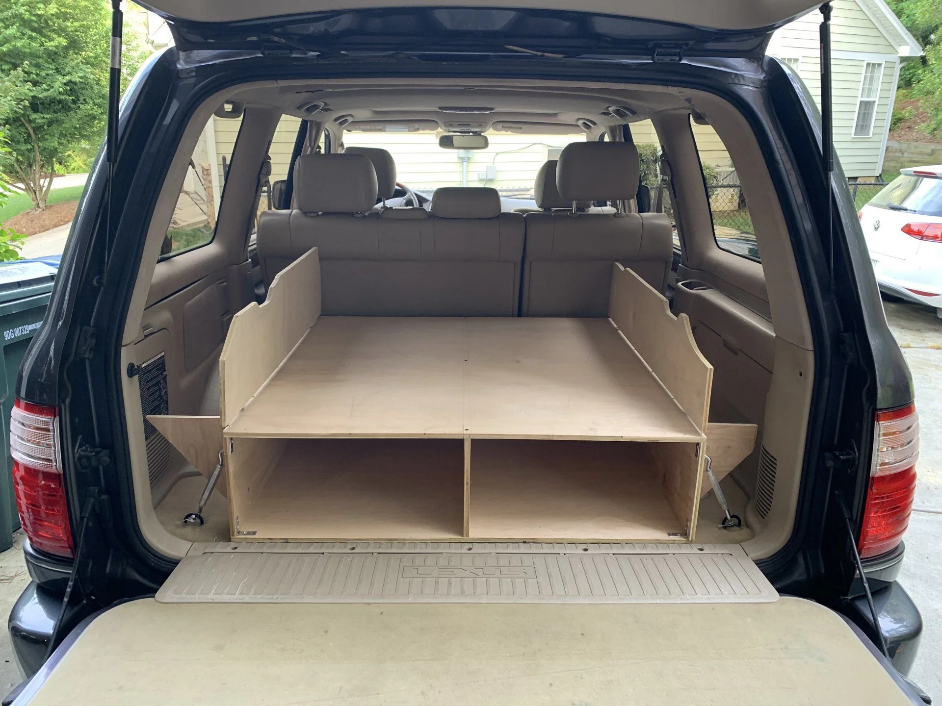

Next Covid project was to build a platform in the rear. I started doing a lot of motorcycle track days and needed a place to sleep. Knocked it out in a day. It has hinged sides and no drawers at this time as I stuff a lot of stuff in there like sleeping bags, etc. Maybe I'll put drawers in one day...
I've slept on it 3-4 times now and it works great!

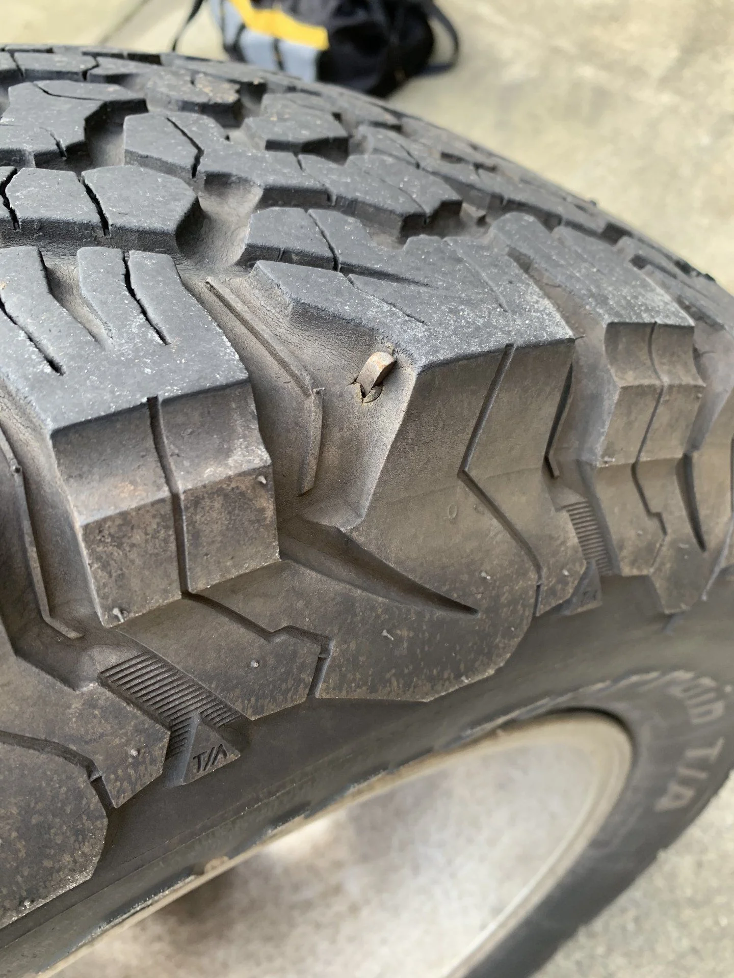

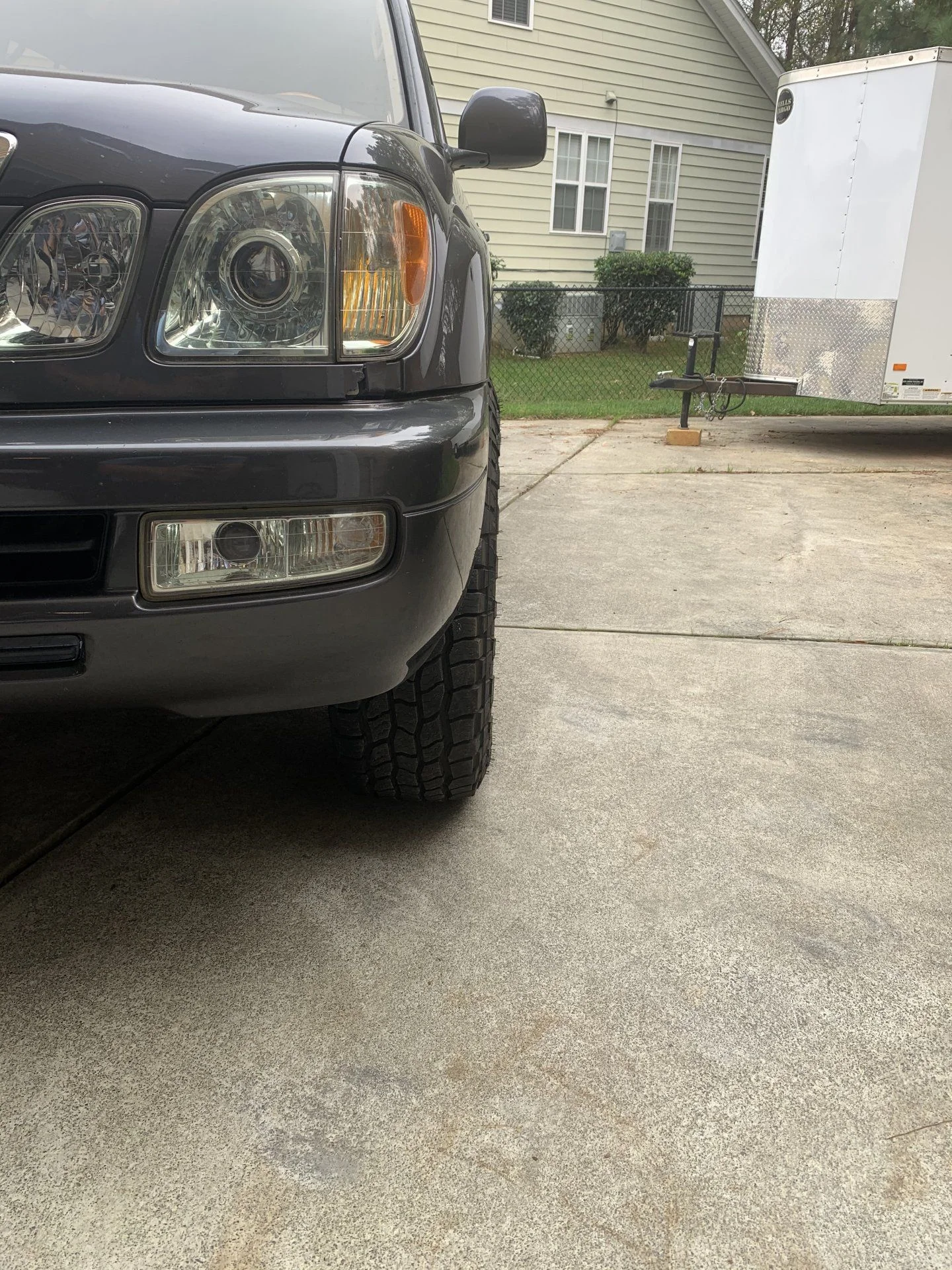

Been a busy few months. Had a flat tire. The puncture was right on the shoulder too so no repair possible.

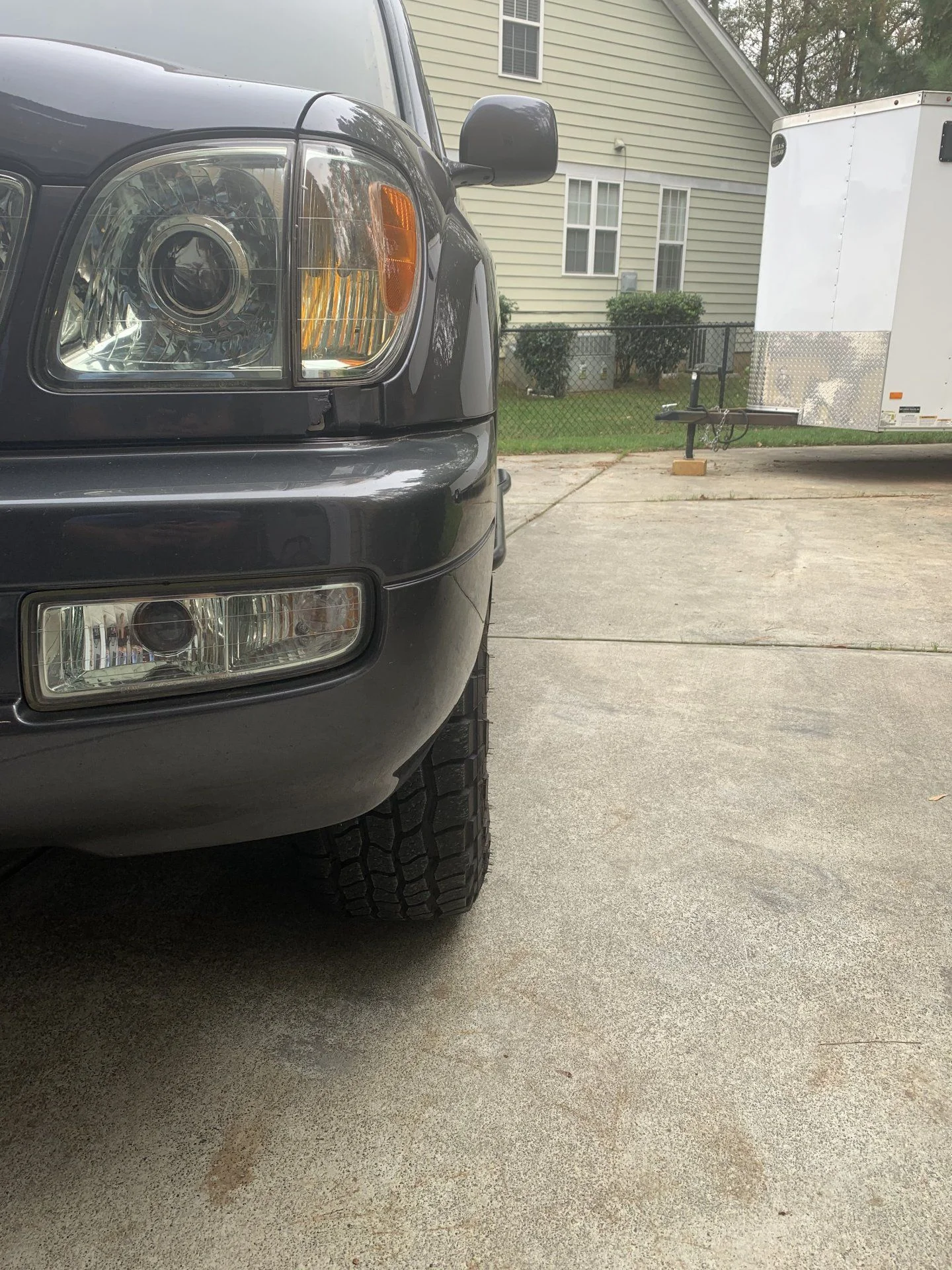

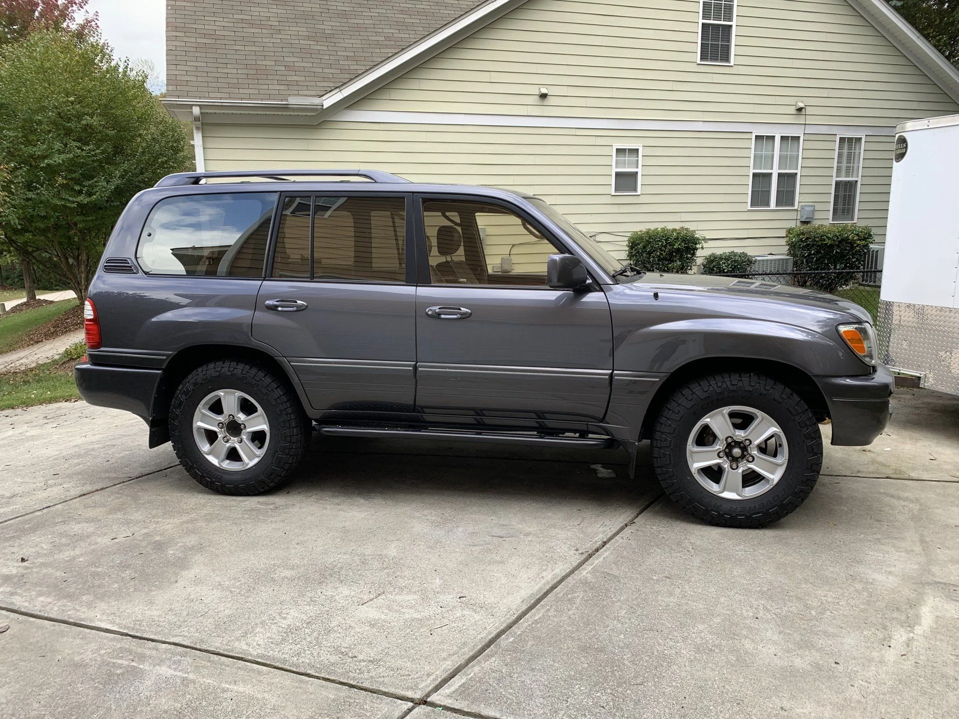

They made it about 60k miles on the nose before this happened. Decided to go ahead and just get a new set. Ended up with some Cooper AT3 XLT's to try out and got a screaming deal on them locally. Also took the opportunity to add some Tundra wheels which I told myself I'd do when I got new tires.
Then got some spacers from Bora. Ended up with 1.25" front and rear to fit the center caps front and rear.
Before:
After:

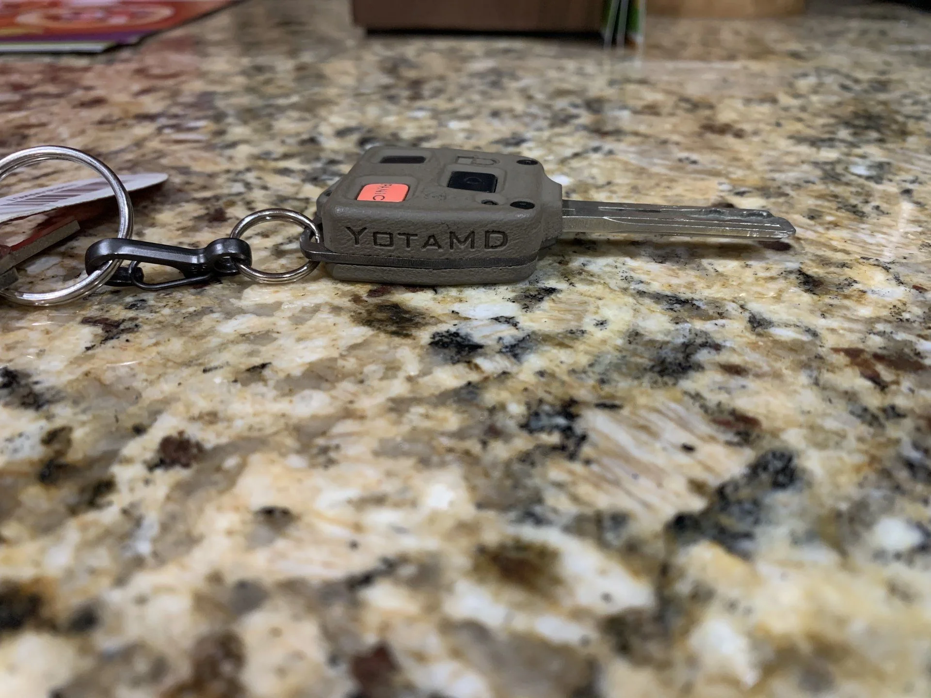

Well my main key fob shell cracked so the obvious choice was to pick up a couple of new key fobs from @suprarx7nut
Went with one in FDE and the other in classic black. Trying out the FDE first and so far I dig it!
