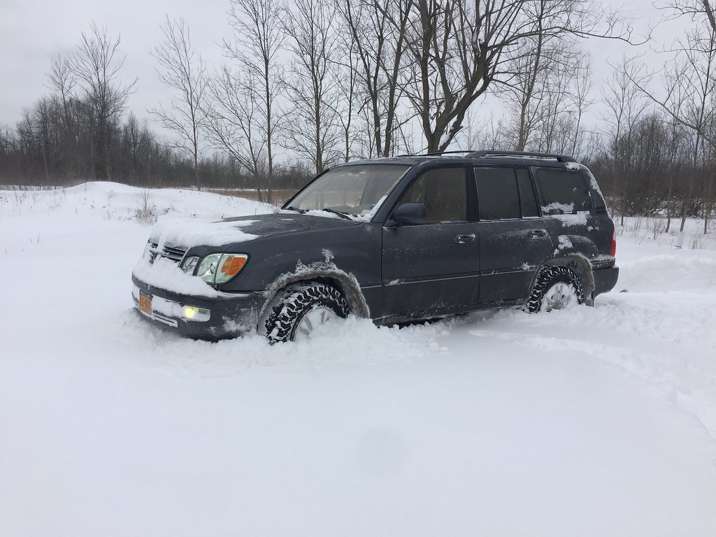

Finally got to test the rig in some snow. Got a decent bit in Buffalo and had some fun bombing around.

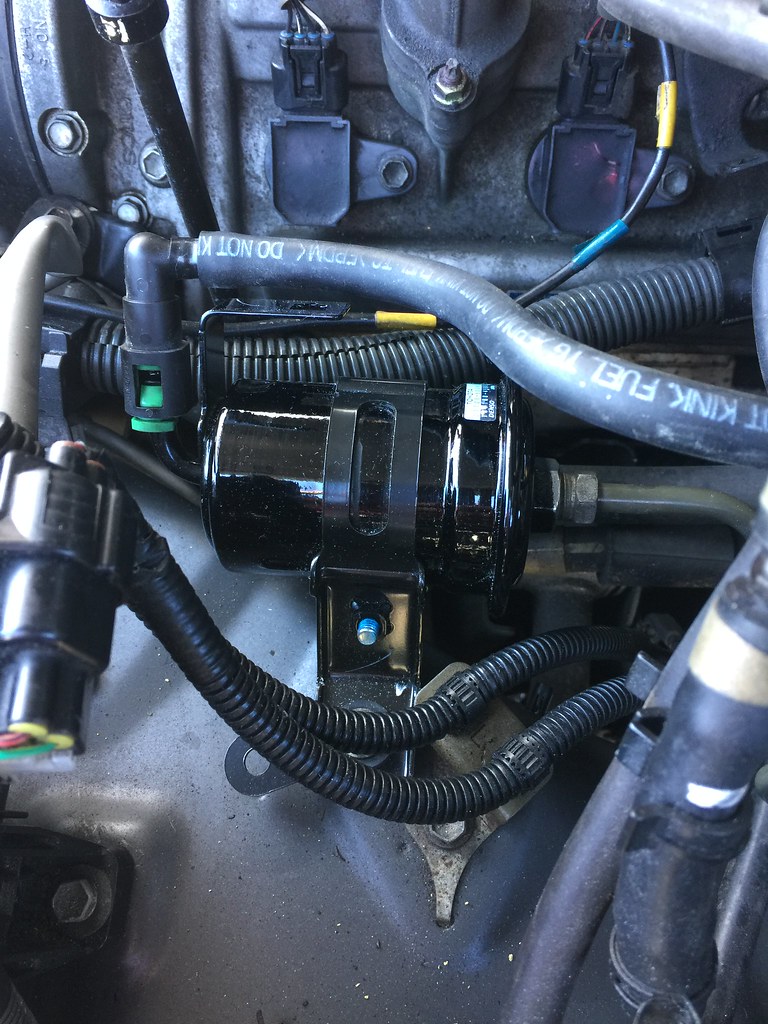

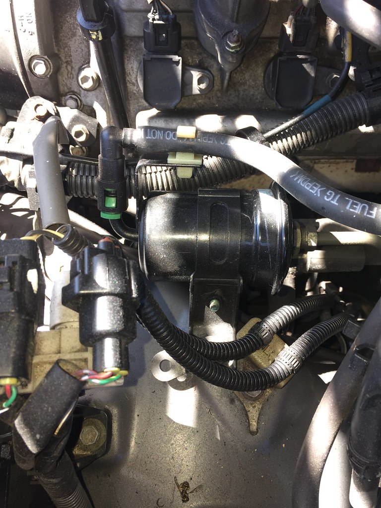

While I was in there though I replaced the fuel filter (5 minute job) and spark plugs with new Denso Iridium plugs. Truck seems to run a little smoother now! I think the fuel filter was original and the truck currently sits at 174,xxx miles!
Plugs weren't bad but didn't know how long they were in there so a fresh set was put in:
Old filter:
New filter!

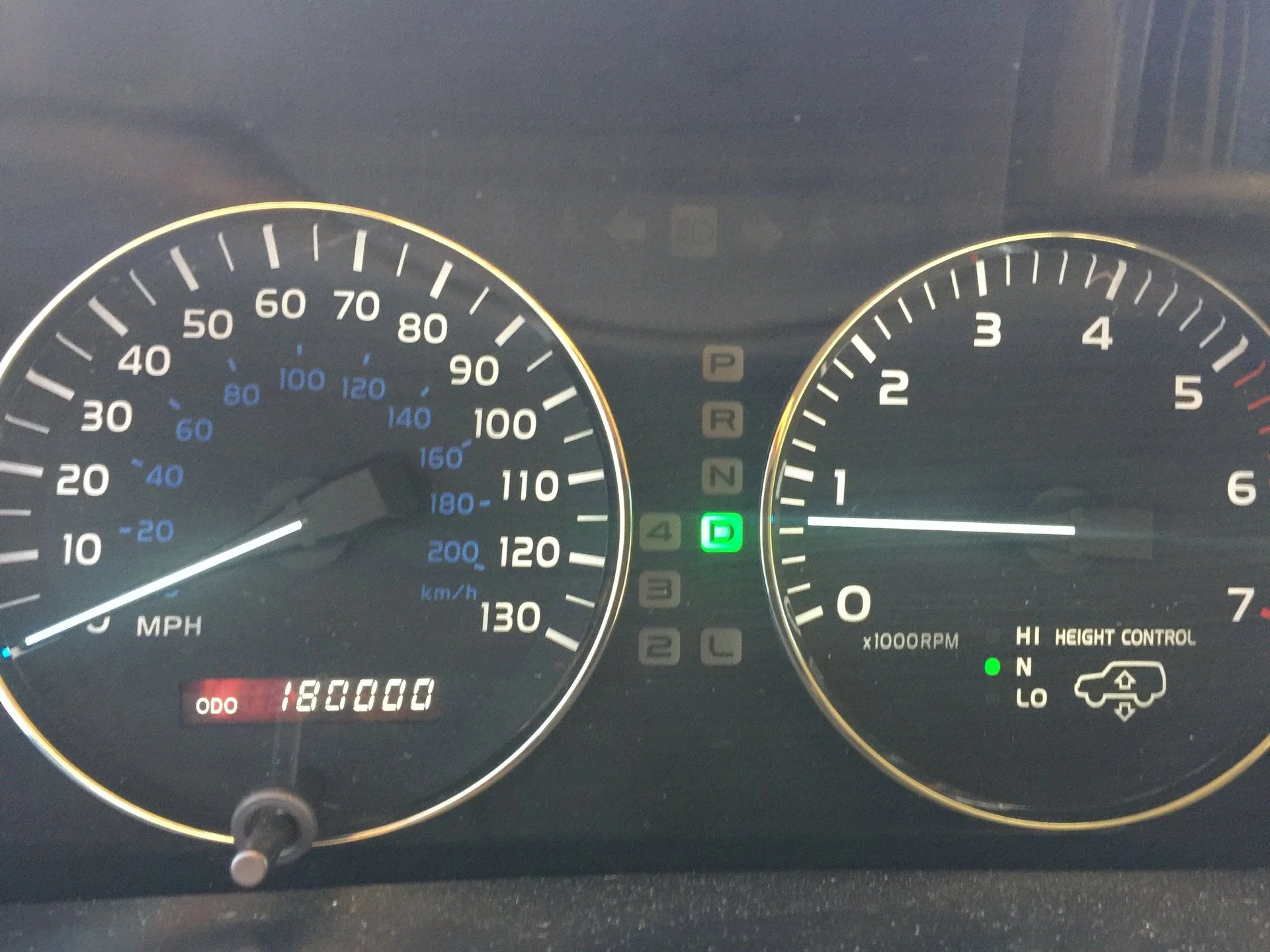

Rolled 180k today. Roughly 15k miles since I brought her home a little over a year ago. Still runs like a top!

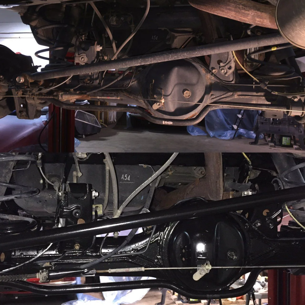

Well I went down to Virginia for Thanksgiving and a friend of ours was kind enough to let me use his lift to POR my truck. Took approximately 6 hours of wash, prep and application time (plus drying time) to do 2 coats on the chassis, rear axle, braces, front suspension arms, skid, etc. I still need to top coat it but I'll do that over Christmas break maybe. Came out well though! Prepped and cleaned the entire underside and then used metal etch to prep.
She's ready to take on Buffalo now! Here are a few before and after pictures of it.

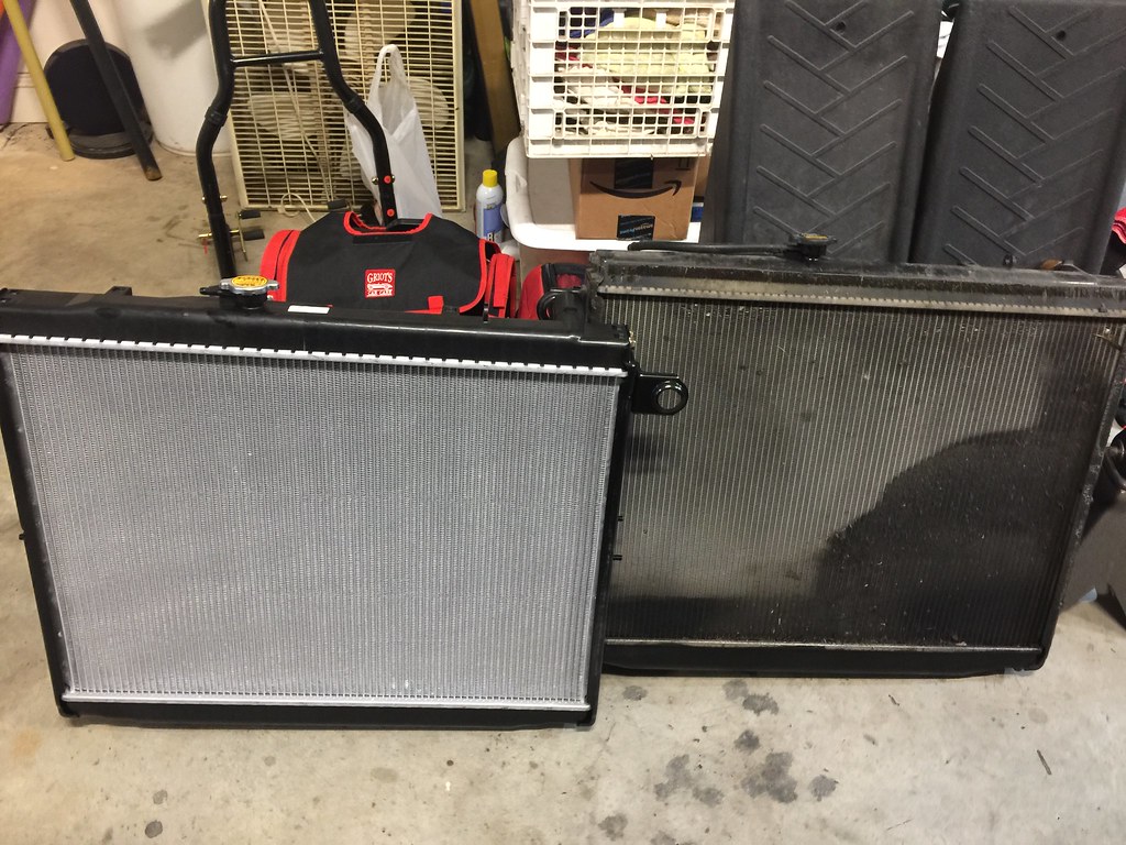

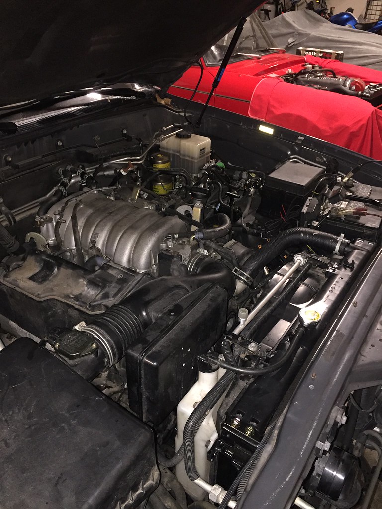

I noticed some coolant residue on the radiator and remembered the level had gone down some so project went on hold and I ordered a new Denso unit. The Denso unit was 1/4" less in overall width so that I had to space the lower mounting bracket out 1/4" so the holes would line up. This added the following parts to be replaced:
-Complete drain of the coolant system and refill with new Toyota SLLC!
-Denso radiator
-Upper and lower radiator hoses
-Radiator Cap
Everything came apart great. No corrosion evident on any of the rad hose connections or in the WP/T-stat housing which is always good!

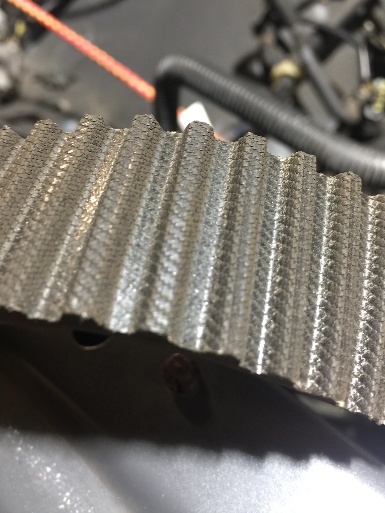

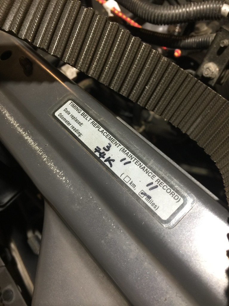

Previous belt interval. Went a little over...
Old belt looked decent though with 116k miles on it!

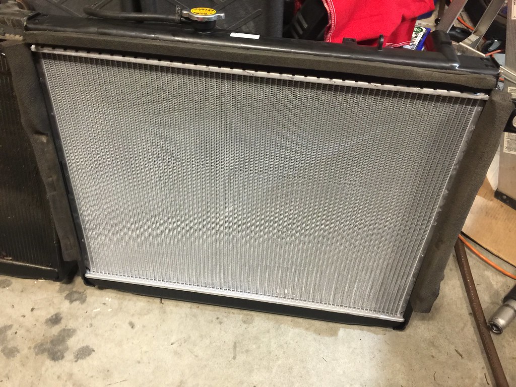

This is the old radiator vs the new one. Old one may have been original...not sure. It weighed about 3x as much as the new one though!
Grafted the foam pieces onto the new radiator...
And wallah! She's all back together.

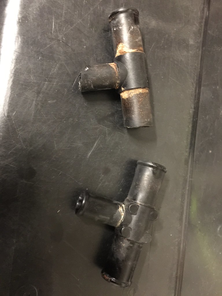

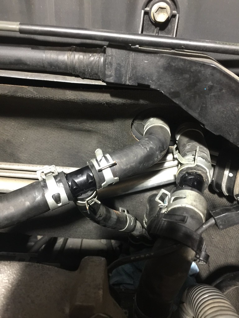

While I was in there and had the coolant completely drained, I replaced the Heater-T's. Original and yes...they did fall apart in the hoses when removed. Luckily I had removed the hoses from the truck prior to removing the heater t's so no issue there!
Old:
New:
