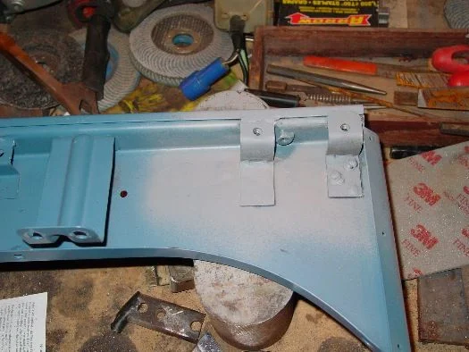

It was fun to get a chance to work the die grinder, then weld some sheet metal and grind again. i was careful to cover everything up with a drop cloth while I worked.
then put the fog lamp switch back in after the primer dried to check it out and adjust the wiring behind. I think the lamp symbol is supposed to face to the left.
Also painted a bunch of stuff today with rattle can epoxy paint. It was satisfying to complete the fuel tank, save for new fuel line tubing

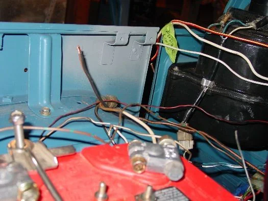

On the wiring scene, I am working on the wires for the amp meter running from the instrument cluster (a three-prong terminal on the back of the cluster, separate from the round main plug in with lots of wires) to the battery. It's connected to the + terminal on the battery on one wire - from there is a short line to a fusible link, and on on the downstream end of the fusible link is the return wire to the amp meter. If the fusible link fails, it would show up at the amp meter. Both wires from the ammeter pass through some inline 5a. fuses, which I chose to locate right near the cluster.
I've got to sort out the fusible link connections pretty quick - there are three in the system.

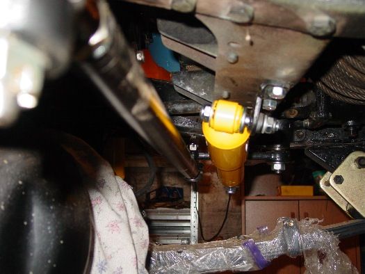

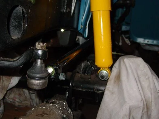

I looked again at the steering damper today and realized that I'd put the mounting tab on backwards. Undid the bolts and reversed it - now the shock alignment is what it should be.
Then I noticed I'd put the drag link end on upside-down yesterday as well (it was just loosely installed), so I flipped that around too.
That seemed like the time to put some more suspension stuff on, so I put the 4x4Labs stuff back on, now freshly coated in epoxy paint. There sure isn't much space between the tie rod and the frame - I hope it won't be a problem. There's not a lot of room regardless, above or below it.
