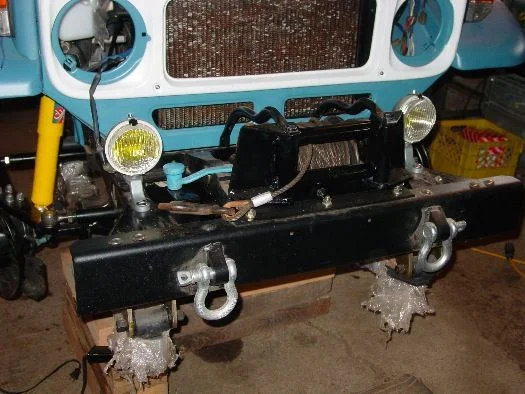

I guess I should paint that winch lever black too.
It's getting to the time to finish tightening the bolts holding the bumper and mounting brackets.

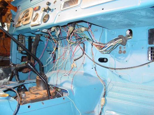

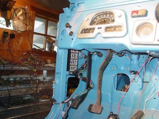

I've been toiling away on the wiring, and a few mistakes in previous sections have been uncovered along the way. I've got about a dozen connections left.

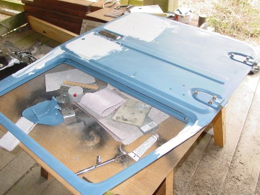

First though, I've got pictures of the body work on the doors thus far.
I plan to have the harness buttoned up tomorrow, and tested, all the while moving the bodywork along.

Connected up the last of the wiring and hooked up the fusible links to the battery....
Well, mostly good news. Nothing blew up or fried. Most everything works.
But not everything:
-the starter motor (relay clicks but solenoid doesn't seem to be actuating)
-wiper motor not working yet, though the wiper relay makes noise
-front parking lights seem to be on a different circuit and are on when they shouldn't be
-can't get the horns to work yet.
-the light dimmer rheostat doesn't seem to do anything
-brake warning light circuit doesn't seem to work
-sedimenter warning is not working
-the headlight and taillight relays. These are the 'M3' type, which has 3 terminal blades. I have 4 of these gippers kicking about in my pile of electrical parts, and all 4 click when power is applied, however when testing them as per the FSM procedure, none of them produce output power then the relay is switched. This seems a little unlikely that all 4 would click but not actually work, so I have some more looking into it to do. I used a wire to bridge across the headlight relay and the headlights come on fine. Power reaches the relay from the battery, but doesn't seem to come any further.
Otherwise, the hazard light switch works, the reverse light, the left and right turn signals, the rear brake lights come on when the pedal is depressed, the heater blower motor works at both low and high speeds, and the fog lamps work. With the headlight relay bridged, the hi/lo beam was functional too.
So, a little troubleshooting is in order today. Most of it should be fairly straightforward to solve, but I'm puzzled about the relays. Either I'm not testing them properly and they are fine, or I need to get a functional one before I can proceed much further.
I guess I'll be doing some more body work today anyhow. It's still a bit cold for paint, but the body filler hardens chemically so I can work with it when outside temps are a little cool.
