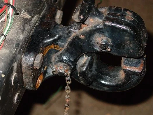

Well today brought some new goodies. I obtained a factory locking pintle hitch off of a JDM HJ61 locally. It's a little seized up, but in excellent condition overall. I'll strip it down and get it working smoothly again of course. The issue I was first worried about though was whether the bolt pattern on the pintle flange was the same as the bolt pattern on the back of my chassis cross member. Most excellently, it fit perfectly, so that bolt spacing hasn't changed between the older trucks through to the HJ61 model anyhow.
Just for fun, I popped in into place and snapped a few pictures. My plan is to sandwich a 0.375" plate behind it and fabricate a new 2" square receiver to go below the pintle. That way, I'll have all the bases covered, towing-wise, both on and off road.

Good to see the pintle bolted right up to the FJ45.

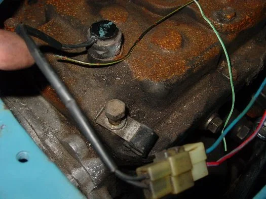

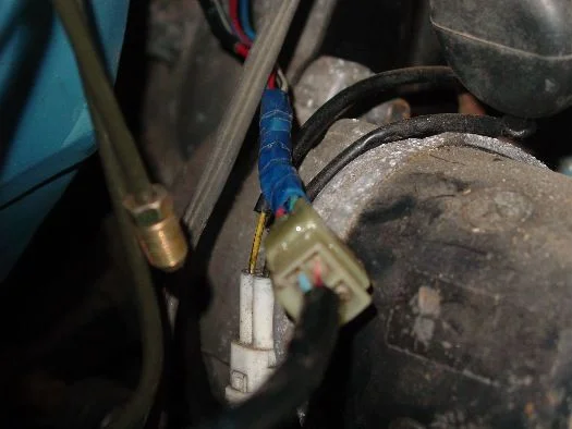

A little more advancement on the wiring: put together a new sub-harness for the tachometer sender and reverse light switch. It took a couple of hours but I was able to replicate the old sub-harness in detail, with fresh connectors. The old sub-harness had a couple of breaks in the wiring sheath as a terminal end, and the wire itself was inflexible and brittle-feeling, probably from the heat.
This sub-harness emerges with a 4-blade terminal on the right side of the engine just above the starter motor. One of the two wires from the reverse switch, red with a light blue stripe, has to connect to the harness going to the rear of the truck, to the reversing lights. The other wire to the back up switch, light blue with a red stripe, connects to the main power feeding the instrument cluster gauges and warning lights.

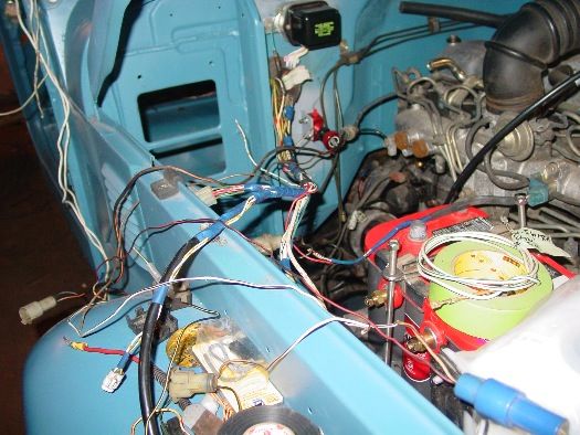

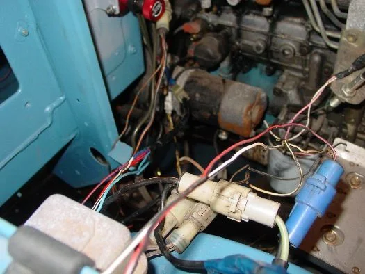

More advances in the wiring department. Just the glow and starter circuits to work out, which is subject to a bit of a puzzle at the moment.
I ordered in a couple of parts from the local Toyota dealership, and that enabled the front shock install. As you can see, I decided not to bother repainting the shocks. I can live with the color.
in the third picture you can see the wiring loom on the battery side of the engine bay. The regulator-starter wiring is all in. Engine bay 95% complete.
The radiator guy returns from vacation fairly soon I think, so hopefully I can have the radiator in by the end of the month. I need to fabricate the screen piece at the top of the rad frame, as mine was long gone (seems a common problem from what I have seen - might be better to make a slightly stouter one).
more wiring pictures. The last section to wire up is under the dash, the fuse panel, and the relay bus - and, oh yeah, the line out to the windshield wiper motor. I'm not sure, but it looks to me like the factory routing for the wiring and the water line is the same hole in the windshield frame, and that the wiring passes through the pocket (glove box) at the top - can anyone confirm this?

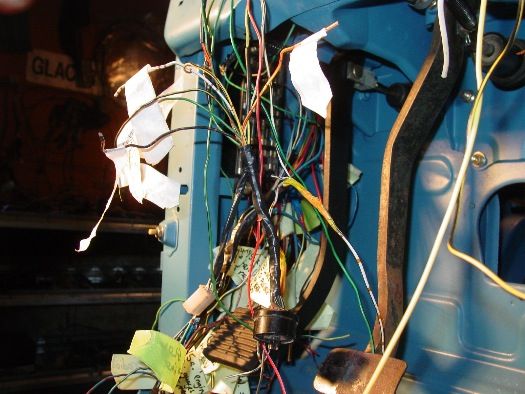

Here's the latest pics of the wiring nightmare - I guess these are all starting to look the same, but progress is occurring. I spent about 6 hours over this past weekend hooking up wires in the cab. it goes a bit slower than I would like, and it's a matter of time, probably another 8 hours of work, until the connections are complete. I managed to get the blue group (blue, blue-white, blue-black, and blue-red), which are for the windshield wiper switch, wiper relay, and windshield washer, mostly hooked up. The water temp sender has also been hooked up to the instrument cluster.
The fuse panel and relay panel are both in place. The toughest part of wiring in such tight quarters with so many frickin' wires is trying to get the lengths of the wires right in relation to one another so that when the wires are bundled and wrapped, there are no loose loops to fold in. Mind you, Toyota didn't wire them perfectly seamlessly either, from the half a dozen harnesses I have ripped apart so far, as you find the odd little loop in there. I'm trying to get the harness as clean and tight as possible, and hoping that I haven't put the harness in a bad position where it is in the way of something else, like an air duct.
I have a large order from SOR in the mail, which includes the transfer case rebuild kit, as well as a couple of other small orders - a used fuel sender cover and interior cabin light from Australia, and a fog lamp switch courtesy of fellow 'mudder MOT in Japan. I'm also putting together an order, hopefully the last one, from Japan4x4, which should be sorted out this coming week.
Once the wring is complete, I have to pull it all out, carefully, kinda like pulling a snake from a gopher hole, and then separate all the sheet metal again so the bodywork can proceed. With the cab off, I can deal with the transfer case rebuild. I'm also anticipating that the weather will be warm enough within the next couple of weeks that I can begin painting parts again.
