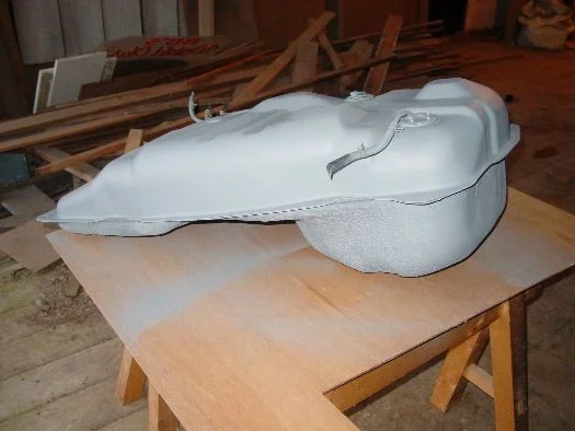

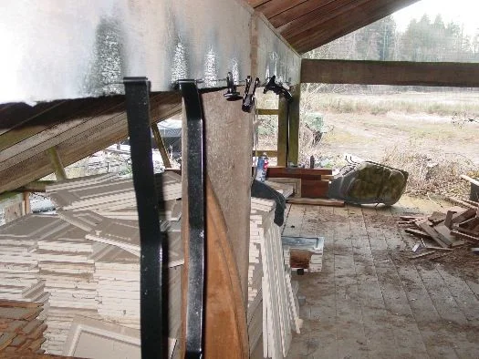

I had a day recently where it was warm enough to paint, so I completed the fuel tank straps, and got the rest of the steering parts into primer and paint. The pintle, now stripped apart, has been media blasted and is now painted.

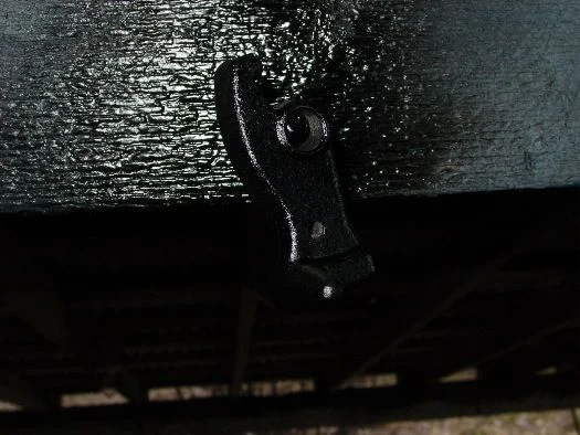

The pintle latch piece, and a couple of other new bits arrived: the OEM drag link and clamps, along with the Tuffy box. The front mounting of the Tuffy box doesn't make much sense, as a 'L' bracket seems to be needed to fix it down at the front.

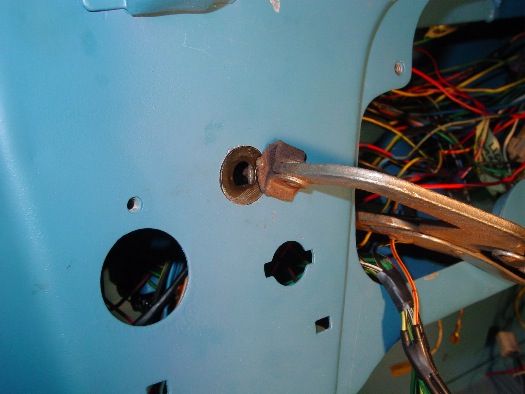

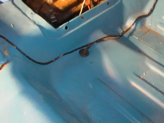

The sub-harness in the first two pics contains 4 wires; two red-white for the parking brake switch and the vacuum reservoir warning switch, a white-black ground wire, and the wire to the fuel tank sender. I need to add the stereo wires yet as the cd player unit will mount in the front section of the Tuffy box. I'm not sure where the speakers will go, but I won't be cutting any holes in the door panels if I can help it. Any suggestions? What about an overhead console? Down by the kick vents? Up in the back corners of the cab above the curved windows?
In tracing one wire back to the headlight, I discovered under the electrical tape some crummy un-soldered connections from a PO repair, something I hadn't noticed whn I first connected it into the harness. Good thing I found it early. The last pic shows the re-done left headlamp plug. Pulling the metal terminals out of the plastic terminal block requires a different terminal tool than I own, but I was able to get them out undamaged using the tool I did have. i then swapped out the terminal block for a cleaner looking one.
IThe last pic shows the re-done left headlamp plug. Pulling the metal terminals out of the plastic terminal block requires a different terminal tool than I own, but I was able to get them out undamaged using the tool I did have. i then swapped out the terminal block for a cleaner looking one.

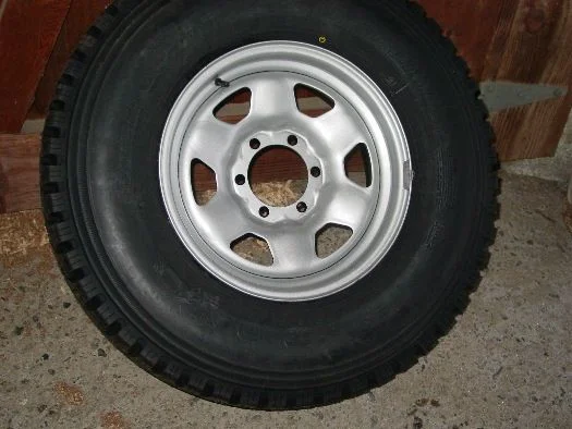

What was the trick to pulling out the terminals? Are you using the 16" wheel on all four corners or is that just the spare? Would that fit a 45LV? Wonder how that would look? Maybe I could photochop it?
The tool that would work perfectly for taking the terminals out of the headlamp plugs resembles the pitchfork-shaped one in the picture below. I have a skinny screwdriver-shaped tool (like in the bottom left of the picture below) instead, and to pull the wire, I apply tension to it and pry, coming in with the tool along the wire side of the plastic plug, alternately working the tool to the left and right inside corners of the plug against the catches. It's a matter of tripping one catch, pulling the shoulder of the metal connector end past, and then tripping the opposite side catch. It takes a little practice. I would prefer to have the right tool if I could.
I bought the 16" rim as my spare, but I am thinking seriously of getting four more and switching the tires over since they're so nice. Stout too!
I want to check them out on the hubs to see if they clear the calipers more than the current set up with the 1/4" spacers.
These wheels will fit many LandCruisers, including the 45LV.

I find that long jeweler's screwdrivers also work pretty well, though the tool i am using is an item i picked up at the local Napa.
