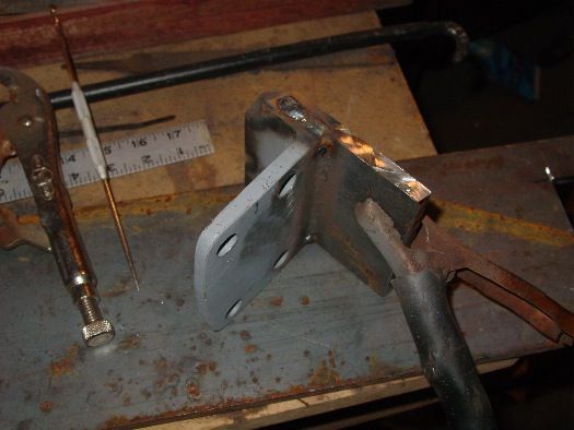

Anyway, here's some pictures. I took a break from the wiring and started on the mark II model of receiver hitch. i had some .375" plate and angle iron to work with.

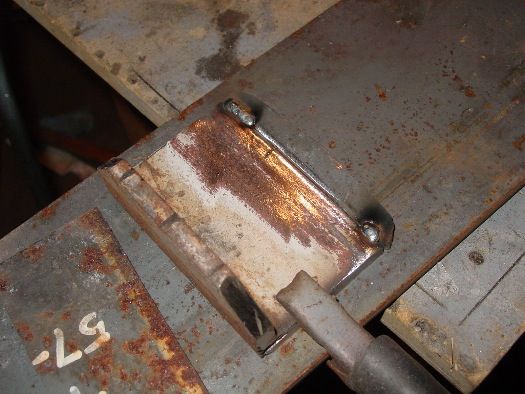

Anyway, some progress pics. I've been workin' on da hitch
I wasn't too happy with the weld quality. I think I need to change the tip on the torch and become a little fussier about cleanliness around the weld zone. Anyway, the weld penetration seemed okay.

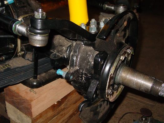

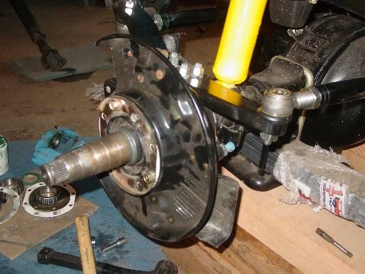

I also moved the front axle along a bit - finally fitting the axle shafts and adjusting the knuckle housings. One of the bushings that I pressed in to the axle spindle proved to be a little deformed and I had to take it to a machine shop, where the machinist took .002" out and that solved the problem.
I realized that the axle spindle takes a fair bit of load, so I decided to order new mounting bolts w. washers, all 16 of them, from the local Toyota dealer. I also order caliper mounting bolts (4) and the hub selector mounting bolts (12). I'll pick them up tomorrow.
Unfortunately the 4x4Labs set up is not looking so good. There is only 1" of clearance between the top of the tie rod and the bottom of the chassis rails. That's not going to fly, and I have been on the phone with Luke Porter over at that company, and he seems very helpful. It is looking like I will send the knuckle arms back to him and get them bent down further. There is around 1.25" clearance below the tie rod and the upper part of the differential casing with the wheels turned fully to the right, so there is room to move downwards. Still, these little steps backward can be frustrating, especially now with the end in sight.

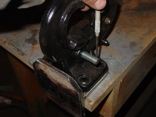

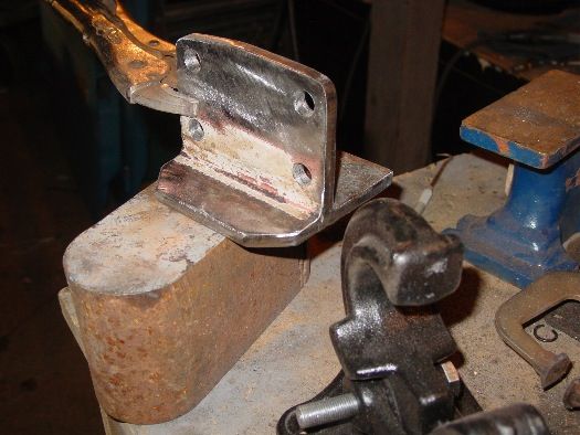

Another hour or so of welding/grinding/priming/painting and the hitch will be complete. Then I'll return to the wiring and try to button that up by the end of the week.
Hitch is finished up (I think!) I'm think of welding some side pieces to it that will help secure the spare tire a little better. Winched up to the support piece, the tire is a little too easy to tilt up and down for my liking (it's been lowered down in the third pic to give me room to fit the hitch.
