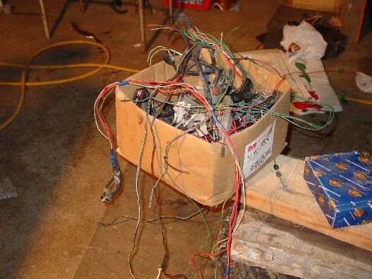

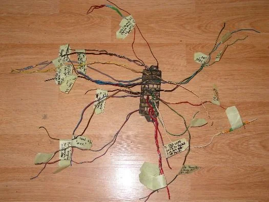

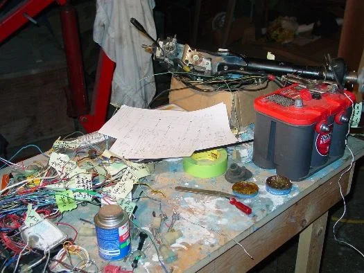

So, Ive been doing a little bit on the truck, mostly relating to the wiring. Here's a picture of my BJ60 fuse panel, which I went through, with the help of the FSM and identified the wires and their associations. I ended up with one unused fuse position, which is great. Once I had the fuse panel sorted, I was able to make a few small changes to my wiring diagram (which I will post up when I'm sure it will work down to the last detail) to reflect that.
Tonight I sorted out the wiring for the 70 series turn signals, which entailed pulling a couple of connectors out of the terminals and clicking in the connectors with correct wire color. I'm going to stick with the factory routing of the headlamp/turn signal/alternator/wiper motor/glow and start relays/rear lights/reverse light s/w harness along the right side of the truck. The harness that emerges on the left side of the engine bay through the firewall will handle the a/c clutch, the temp. sender, tachometer pickup on the bell-housing, and the brake fluid warning switch. I think that covers it.
Tomorrow I'll try and do the fog lamp sub-harness.

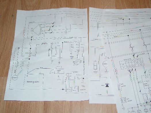

Now that i have the wring diagram pretty much complete, it's mostly it's a matter of sorting out the terminal arrangements, and some types are easier to gut than others. The other battle is just keeping the mass of wires and terminals organized, as i have ripped apart 4 or 5 harnesses for parts and my shelves are overflowing.

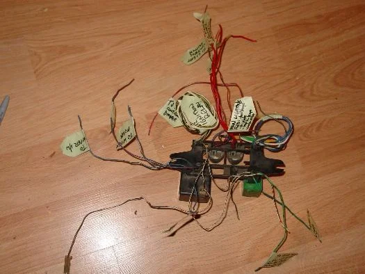

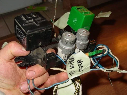

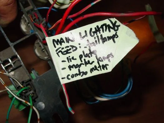

So, I brought the relay panel home and i.d. tagged the wires. I end up with two relay locations wired that won't be used, one was for the ignition relay (on a 60 series of course) and the other was for the heater relay. in addition to that, the cluster has room to instal another two relays. These would have been for the headlamp washer motor relay, and a charge lamp relay. i will wire up the charge lamp relay, as I included one in my wiring diagram design, but that still leaves me with some unused capacity.
It is nice to have the 60 series relay cluster, as now I will have factory headlamp and tail lamp relays, along of course with the intermittent wiper. In the second picture you can clearly see the relays. The green one is the flasher, the large square black one is the wiper relay, and the two cylindrical ones are the head lamp and tail lamp relays.

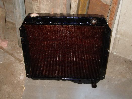

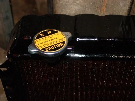

I decided to go with the 4-core radiator rebuild, with the good copper. The radiator guy said that aluminum rad cores are not field fixable for one thing, and not as durable as the copper ones. Since he does a lot of work on rads for commercial logging trucks, and has 35 years experience, I'll go with that. :D It should be ready any day now.
I realize that a lot of the parts in this re-build are going to be good for a very long time. It's a lot of up front cost, but it's nice to know that from then on out, my cost should be confined mostly to maintenance, and I won't be worrying about what part is going to give out next (which is unfortunately the normal automotive experience of my life).
I like the way you think. I did the same on my faux-Hilux, and after driving all across the hinterlands and winterlands, I'm VERY glad I did. So nice having peace of mind, y'know?

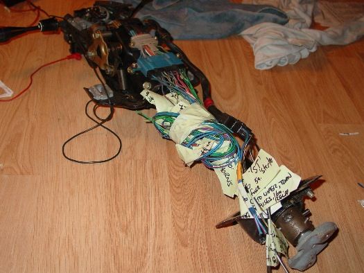

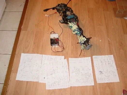

More progress on the wiring. This time I tagged all the wires emanating from my steering column switches. In doing so, I discovered a minor goof up in my wiring diagram, and found that I will only have to change two of the wires for different colors to make it mesh with my fuse panel and relay bus. I'll swap the wires out tomorrow.
I tried posting up pictures, but now I find my attachment quota is full! I deleted a bunch of other attachments from other threads, but for some reason I am still over quota. And what happened to the silver star I bought last year? I thought it was good for a year, and now I can't even find where you buy a silver star. What gives?
That takes care of sorting the wires on the three clumps in the system. From here on out it will be a matter of connecting the dots and a lot of crimping, soldering, and sealing with shrink wrap.

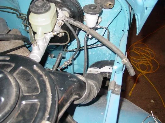

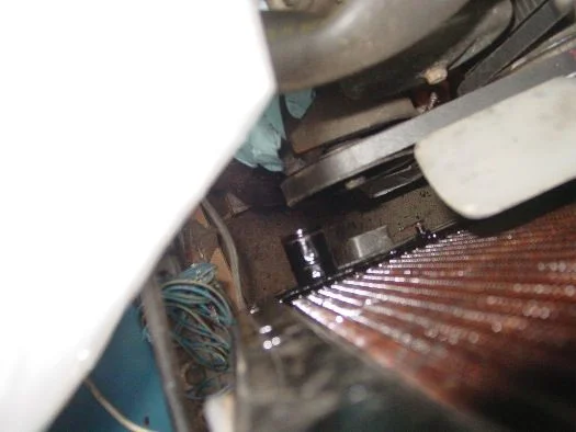

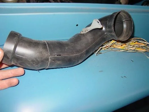

Some minor progress to report. I connected up the rubber intake hose that goes form the intake manifold to the air cleaner. I found that the hood slightly pressed on it when closed, so I while looking through my old cab support rubberized mounts, I found another 0.25" shim. I put that under the front left corner of the cab, now both front mounts have been shimmed the same, and the hood now clears the intake hose.
Puzzling a bit over the wiring ( a mild understatement). I had Dave Stedman at Japan4x4 run the numbers off my existing 47 series glow and starter relays, and only the starter relay is still available from Toyota. Given their age, and the likelihood they may fail in the near future, I am considering wiring up 60 series relays instead. This will mean a change to the wiring diagram I made, as the 60 series starter relays have fewer wires involved than the 47 series units.
Hopefully the BJ60 series starter and glow relays aren't obsolete from Toyota.

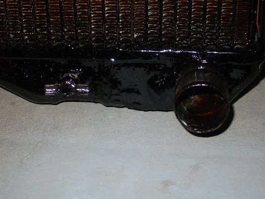

...and the bugger lower hose inlet neck still won't clear the power steering pulley:mad:
No biggie - it really does need to go at a 45˚ angle to clear, so I took the rad back to the shop for further modification.
then I threw a fresh air filter into the air cleaner can and started thinking about how to make a duct for the air cleaner inlet.

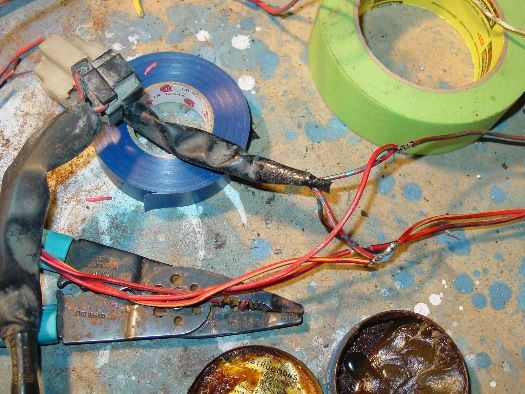

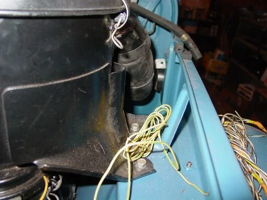

Some advancement in the wiring department. I managed to get quite a bit of the front lighting harness, which includes the wires for both headlamps and turn signal/marker lamps, as well as the horns. You can see in the first pic that I am using the 60 series pattern of wire colors for the headlamps. In 40 series trucks, typically, the wires go from a 15a. headlamp fuse in the panel to the dimmer swithcto the lights are red-yellow for high beam and hi-beam indicator light, red-green for low beam, and white-black to ground.
In the 60 series, instead of the white-black returning to ground, the components are reversed in order, and the switch and hi beam indicator lamp are the outlets to ground. There are two separate 10a. fuses for left and right headlamps in the panel, and the wires from the fuses go directly to the lamps and then to the switch: red-white for left headlamp, and red-black for right headlamp. As with the 40 series, red-yellow and red-green come from the dimmer switch to control hi beam (red-yellow) and low (red-green).
I'm routing these wires along to the left hand side hole in the firewall for wiring. Seems to be the shortest distance between the points involved.
To connect wires, I strip the plastic sheath, interweave the wires, clean it with flux, then solder, then finish with a short length of shrink wrap tubing or tape. I then wrap the wires for a particular component together every 18" or so. Then I bundle the these sub-sections together, usually with zip ties at the moment. When every wire is laid and connected up, then I will wrap the harness in non-adhesive tape, followed by a wrap of electrical tape, and then put the works in some corrugated plastic casing. When i put the spade and terminal connections together, I apply a blob of di-electric grease to the metal parts before the final put-together.
