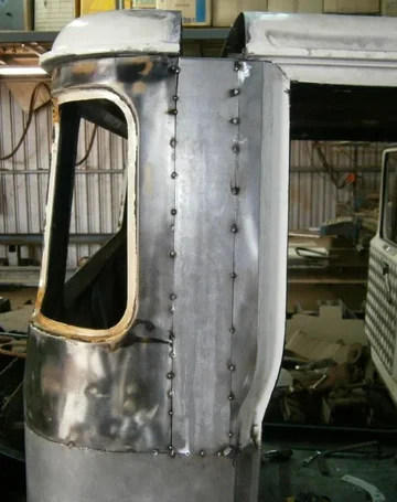

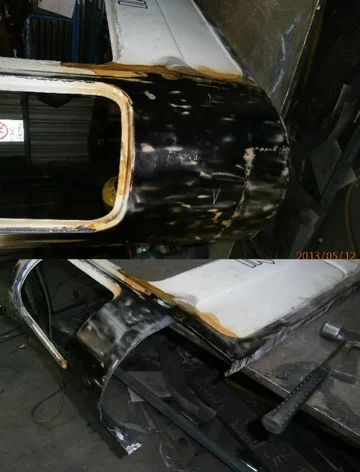

I figured that the best place to split the window section was just next to the body line that runs up parallel with the door opening. For the inside, I chose to seperate just off the corner of the pillar fold so I can get full access behind the weld join of the 75mm extension.
I braced the forward section before cutting free in order to keep the opening square and parallel.
When it was apart, I liberally sprayed the inside folded surfaces with rustroy. As I was there, I sprayed the outside also, which is why it looks a bit purple. I measured 150mm off the flange face as my repair corners are 150mm wide, its bout an inch below the tapered radius on the factory join.
Then I threw it on the cab, centralised it, took over 100 measurements and then tacked her in place with the mig. I grabbed the forward part of the window section and tacked it in. I think not too bad an effort for sunday! The next part will be bolting the windscreen panel, roof and maybe the doors to ensure the extension is going to work. I probably wont have time during the week, but will get more done next weekend, so stay tuned!:cheers:

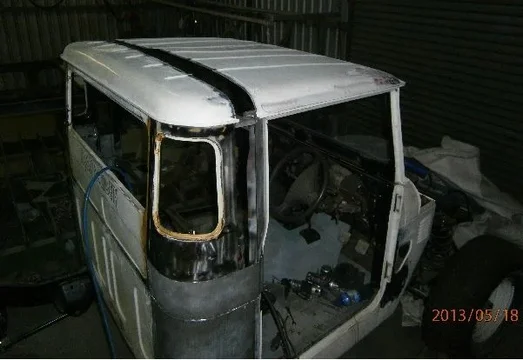

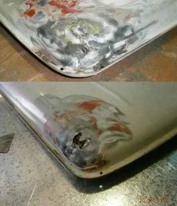

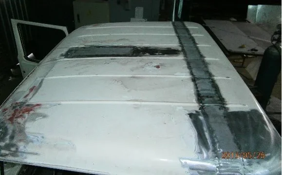

Cheers Pacer, I am happy with the progress I am making and enjoy posting it. Anyhoo, on Friday night I bolted the windscreen panel on and started to remove the cruddy green carpet on the roof. The carpet was kwik-gripped down over the entire panel and was quite a pain to remove. Before I cut the roof, I wanted to find out how healthy it was by running a magnet over it. I discovered that the ute's past life as a shooting rig hadn't been too nice to her. The roof had at one stage a large spotlight used by the shooters to site animals. It also had 2 rust "repairs" on each front corners of the roof. Oh well, more rust repair challenges!
After measuring and checking a hundred times, I marked the cut with masking tape and took the 5" to it. Without wasting any time, I threw the both roof sections on and bolted it down.

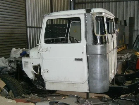

With the roof seperated and bolted down, I wanted to put the doors back on to make sure the cab was still square. After bolting them on, I was happy with the gap around the door and proceded to make the fill in pieces for the cab's window panel and tacked them in.
This is how it looks with both sides filled in and the doors on and closed.......

At this stage the next part will be the fill-in section of the roof, for which I will most likely make a blade and die for the workshops press or use the bead roller. I still want to TIG the 75mm pieces in especially when they are to be butt-welded so i can hammer and dolly when necessary. I will continue to MIG tack and stitch the panels as it is quick and easy. Stay tuned for more updates! :cheers:
