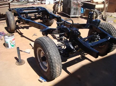

The following weekend the suspension bushes arrived and i set about reinstalling the new blue polyurethane bushes and castor correction set for the radius arms.After the install i paint them with the same gloss black i used for the chassis. As they were drying i set about fixing a leak in the rear diff aswell as a hairline crack in the front diff's drivers shock mount aswell as some flogged out control arm bracket holes. With this completed, the diffs were also given a coat of primer and black enamel then promptly installed back in the chassis with a brand new adjustable panhard rod up front. (The rear one is being ordered)

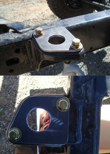

With all the suspension in, I decided to make some stays and lugs so i could tow it in and out of the shop without scratchin the paint into submission. And so i could lift the front and rear diff without having to mess around with jacks etc.

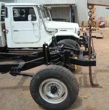

Have you ever wondered what a 80 series chassis looks like next to a hj45? Thought while i had me 45 @ work a mite aswell sit them next to each other and discovered the engine mounts dont need moving/modding but the gearbox Xmember will...
I will be attaching the 45 front apron to the chassis via a reduced rectangle transition piece that will pickup the 3 M8 holes in the chassis front xmember, similar to the original setup except a LOT more friggin about.

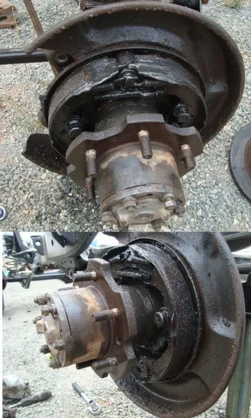

Cheers Cult45, this next part dont look too flash but. Today I lifted the rear diff onto stands to finally have a good look at the calipers, rotor and handbrake mechanism. I knew that the rear hubs were leaking when i bought the 80 frame, but i hadn't counted on it being this bad.
Looks kinda innocent...
Greasy caliper, could be worse,
Yuck, kinda looks like nickel-grade anti-sieze. Both sides are basically the same. I also discovered that both calipers were seized and pretty well buggered! Which means yet another part to buy on the list! Oh well, sure beats drinkin all me pay!

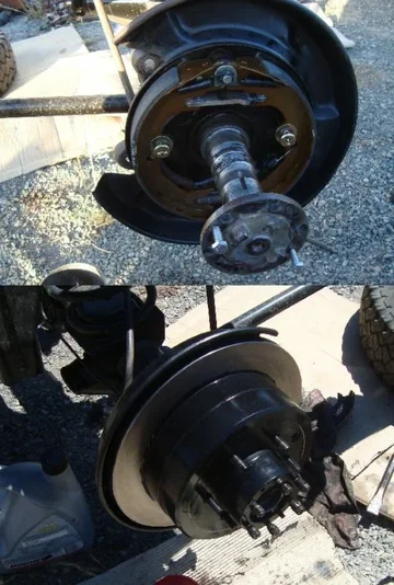

Well, it has been fairly busy @ work this week and time has been scarce, however, i have stripped, cleaned and replaced all of the handbrake mechanisms for both sides. I also threw the rebiult hubs back onto the diff housing with the rotors and have it off the stands for now and back on some wheels.
