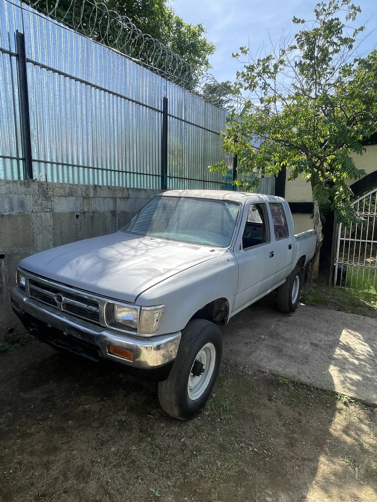

Hey guys. I just picked up a LN106 Hilux double cab. It was an abandoned project and it has no engine or transmission but it used to have a 3L diesel. It still has the wiring harness for the 3L.
I live in Central America so we get a pretty good choice of diesels/transmissions. I was thinking about getting a wrecker 4Runner(Surf) or Prado with the 1KZ and the trans.
How much harder/more expensive will this be versus just going back to the 3L? Parts are easily sourced for both 1KZ and 3L

Give us the rundown on the truck with more pictures.
My two cents is to go to the 3L. I love my little 2.8. I just recently rebuilt one, and I'm very familiar with these engines.
I run a 3L with G52 gearbox. But it will also work with W series transmissions, or even R series with correct bell housing.
As for how hard/expensive the 1KZ swaps are, I can't attest to that, but a few guys have done it. To me there is something very special about the 3L with fully mechanical injection.
Another option you have is the 5L. It will drop right in with very little or no modifications, and it is just a bored out 3L engine.
Thanks guys. I think I’m gonna stick with the 3L. We don’t have any big freeways here so dont need it to be fast, but I’m a sucker for power so may turbo it conservatively down the road.
