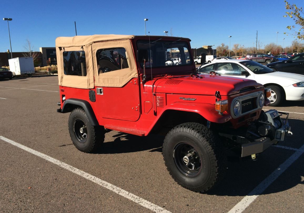

This was before the bungees were attached so it was a little loose. Magnets are really cool and just enough pull.

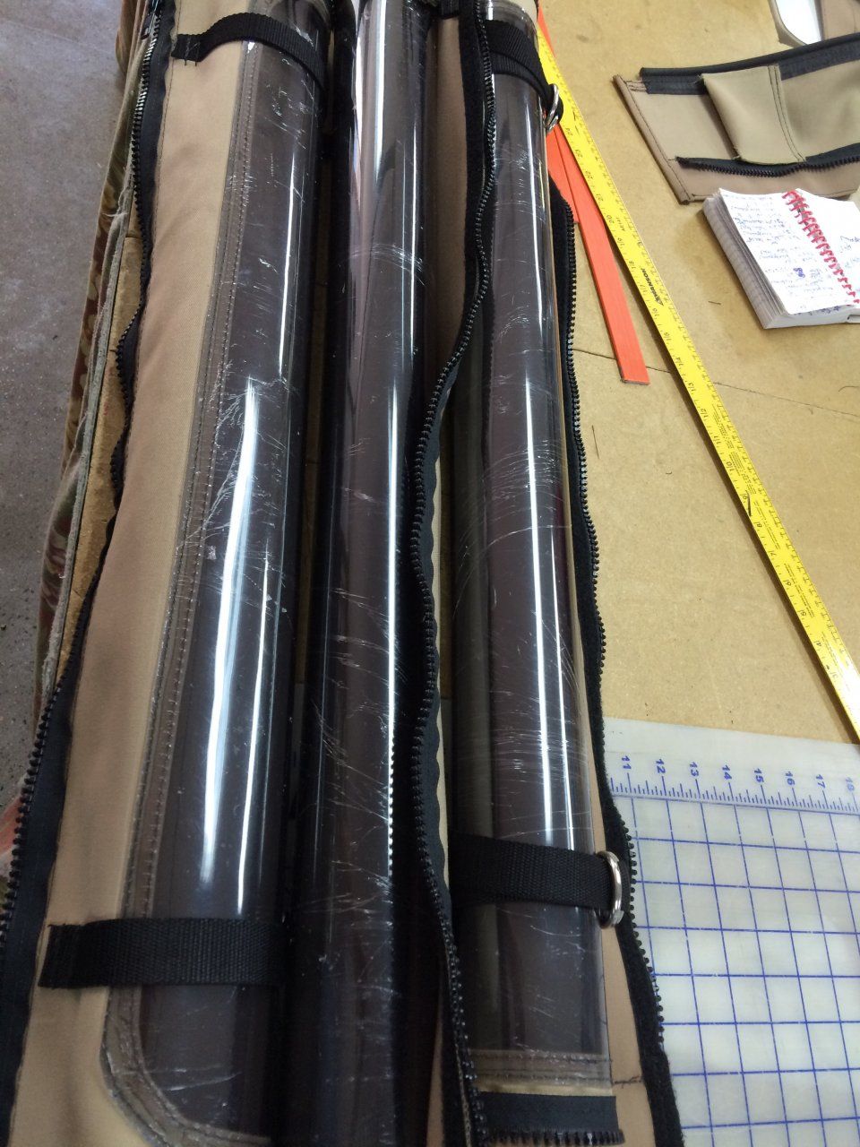

The bungee attachments. The magnets are attached to fiberglass battens that slide into pockets on the bottoms of the windows.
All the windows zip out as well roll up.

Correct. No drilling. That was the main reason I went with this design. Plus I hated the straps in the back. Made getting in a pain. There are no straps in the back window area though the flap is there if someone wanted to add anchors. The magnets hold the panel on just fine and the corners keep the top from moving.

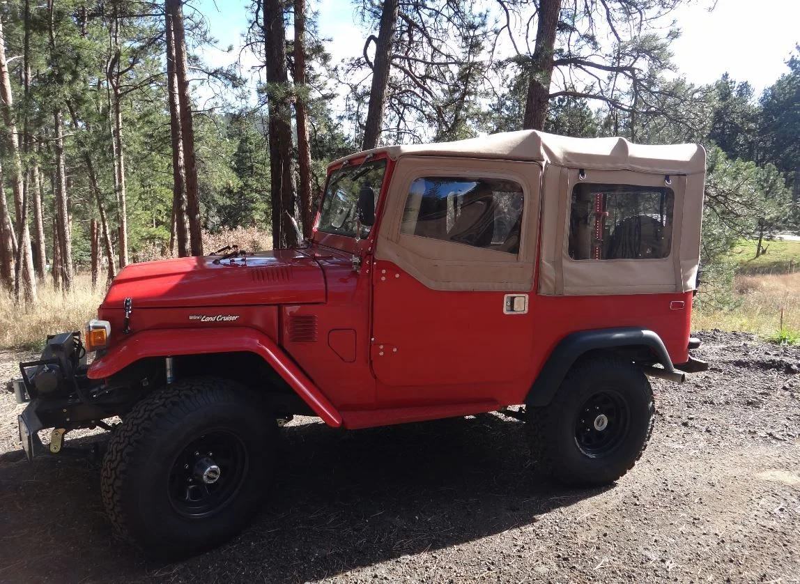

Took it for a spin today
Doing 75 on the highway, no issues with the top or magnets
