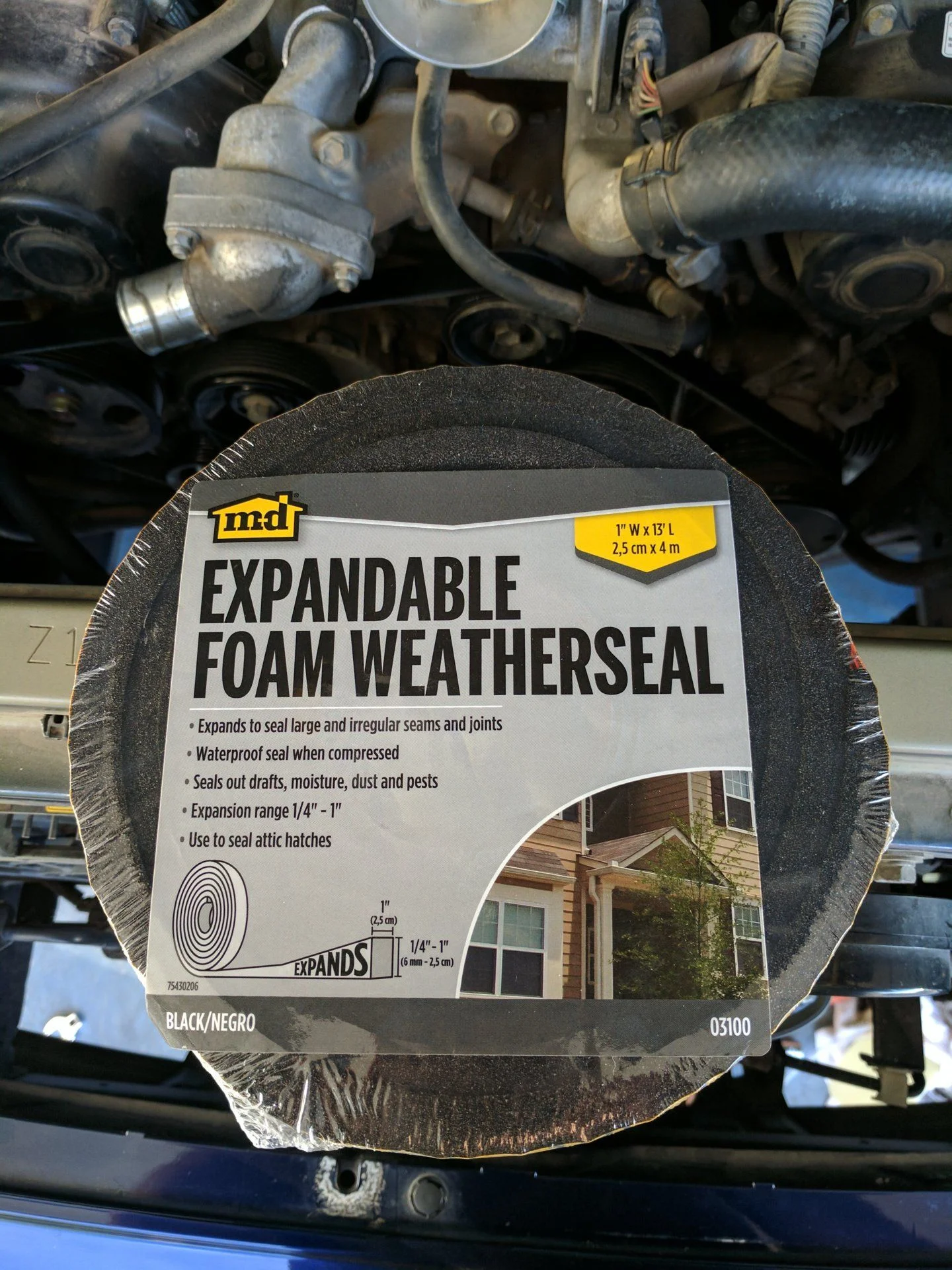

This is the foam I bought:

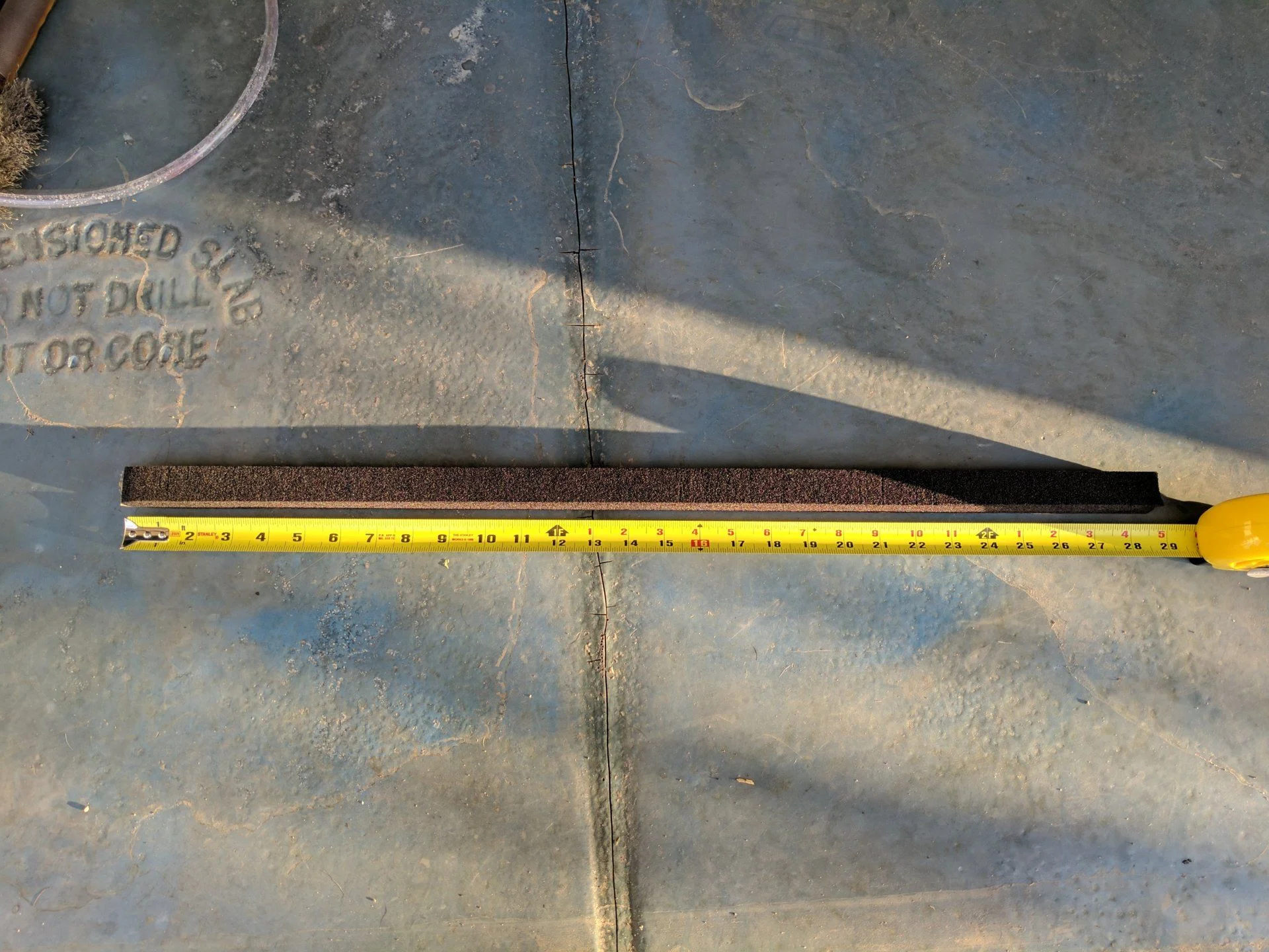

I cut a strip 29 inches long:

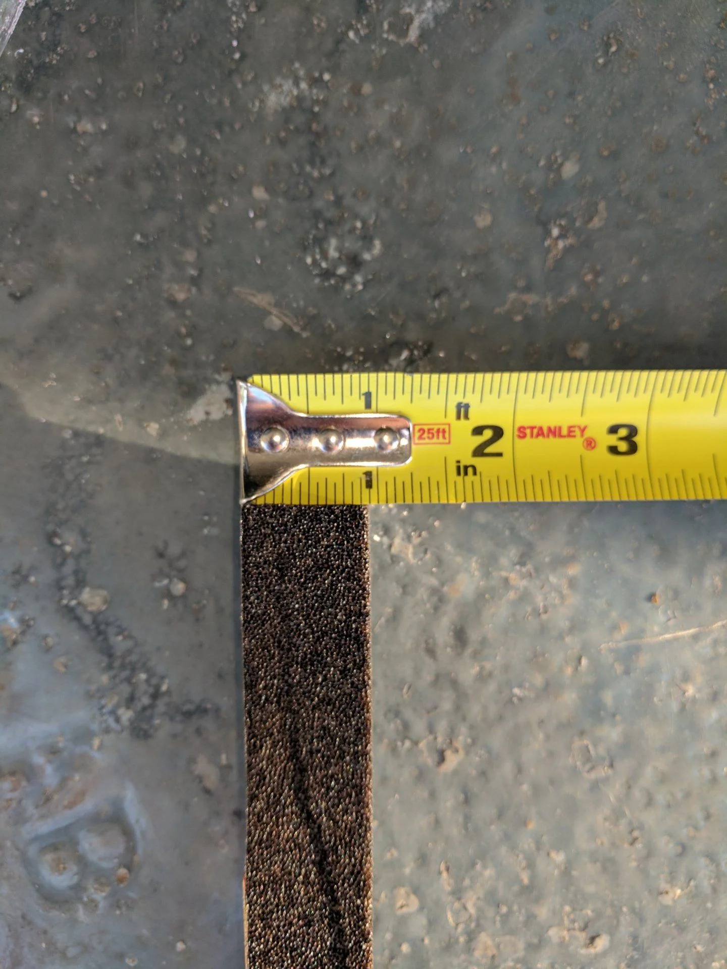

Once released, the foam expands to 1 inch in height:

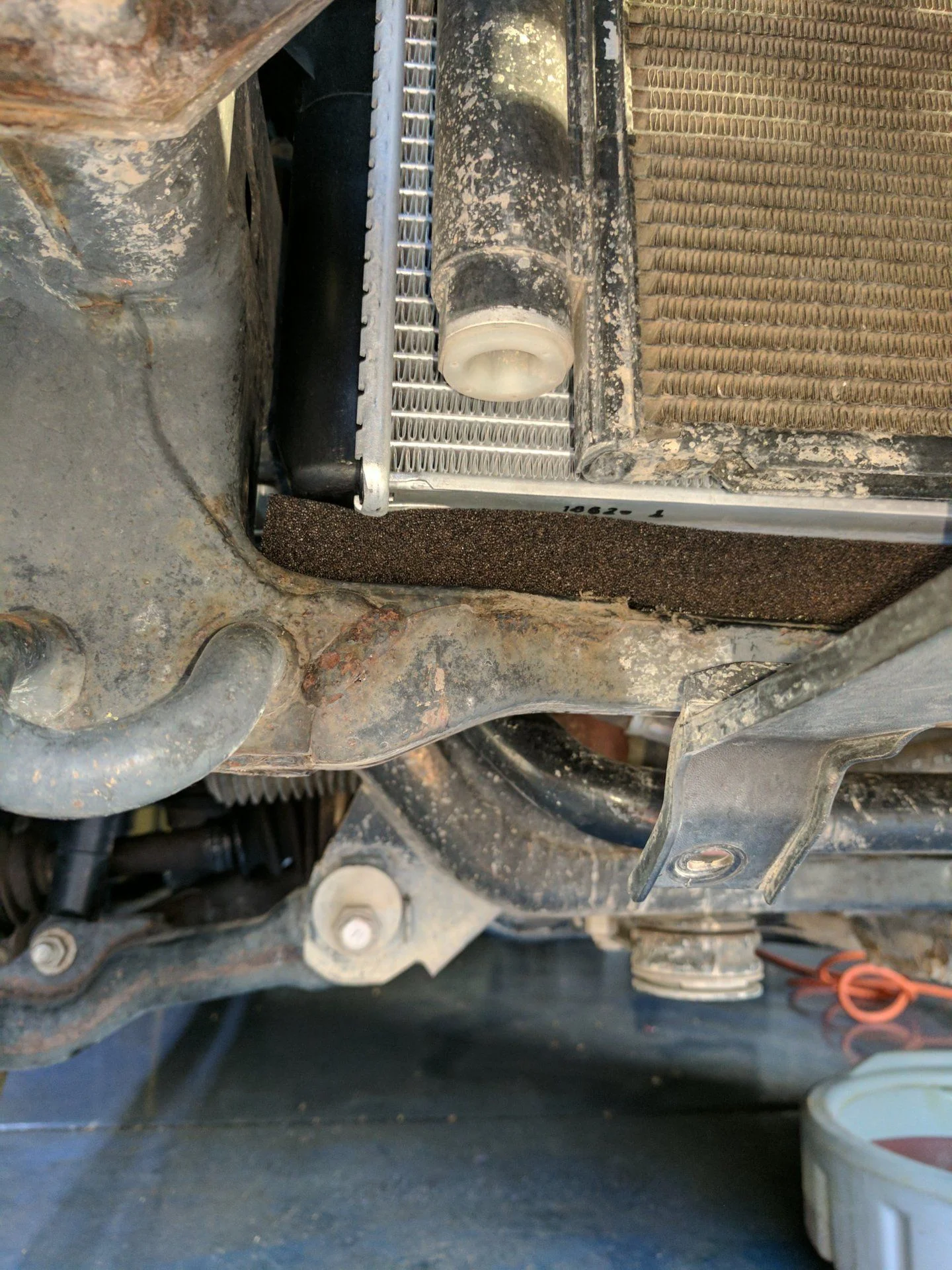

I cleaned and installed the foam along this crossmember/radiator support:

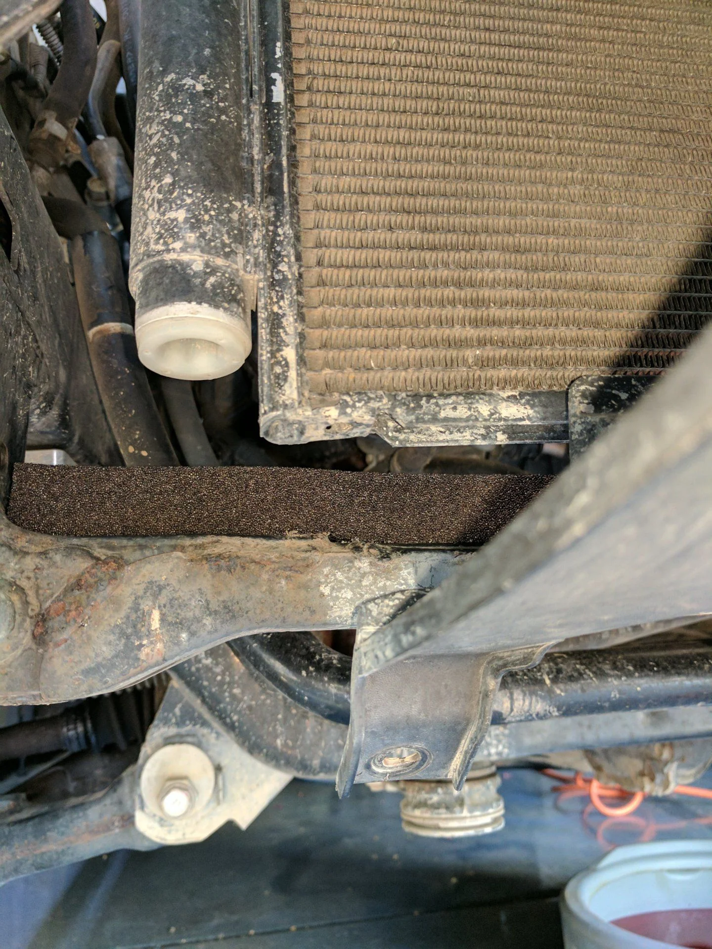

This is the foam installed prior to the new radiator going in:

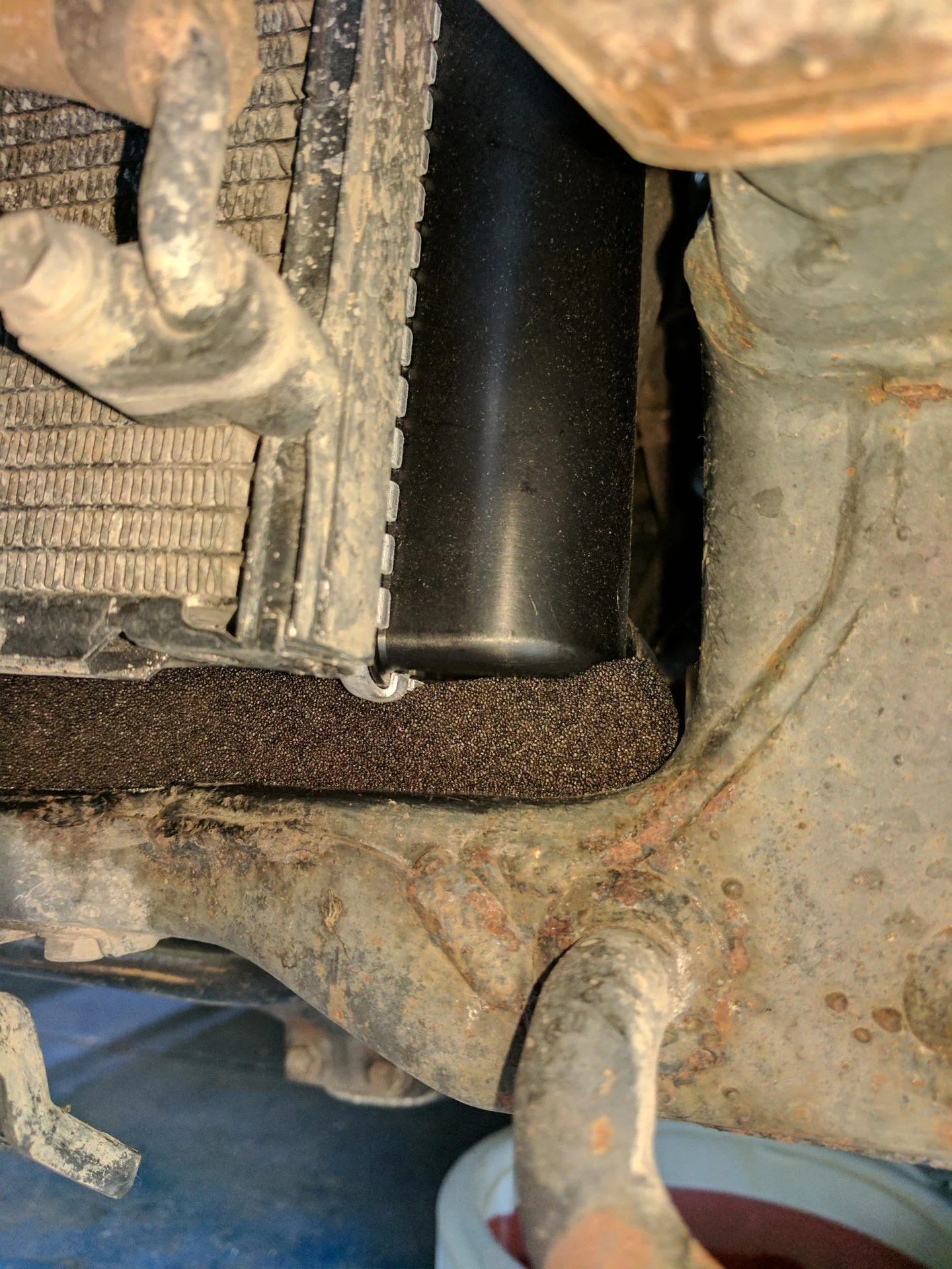

This is how it seals along the bottom of the radiator. I know it's hard to tell from this angle, but it leaves about a 5mm gap along the core:

Was able to get the pics to load by loading them into the media. If you want to completely seal the bottom of the radiator, you will need foam "taller" than 1 inch in height.
