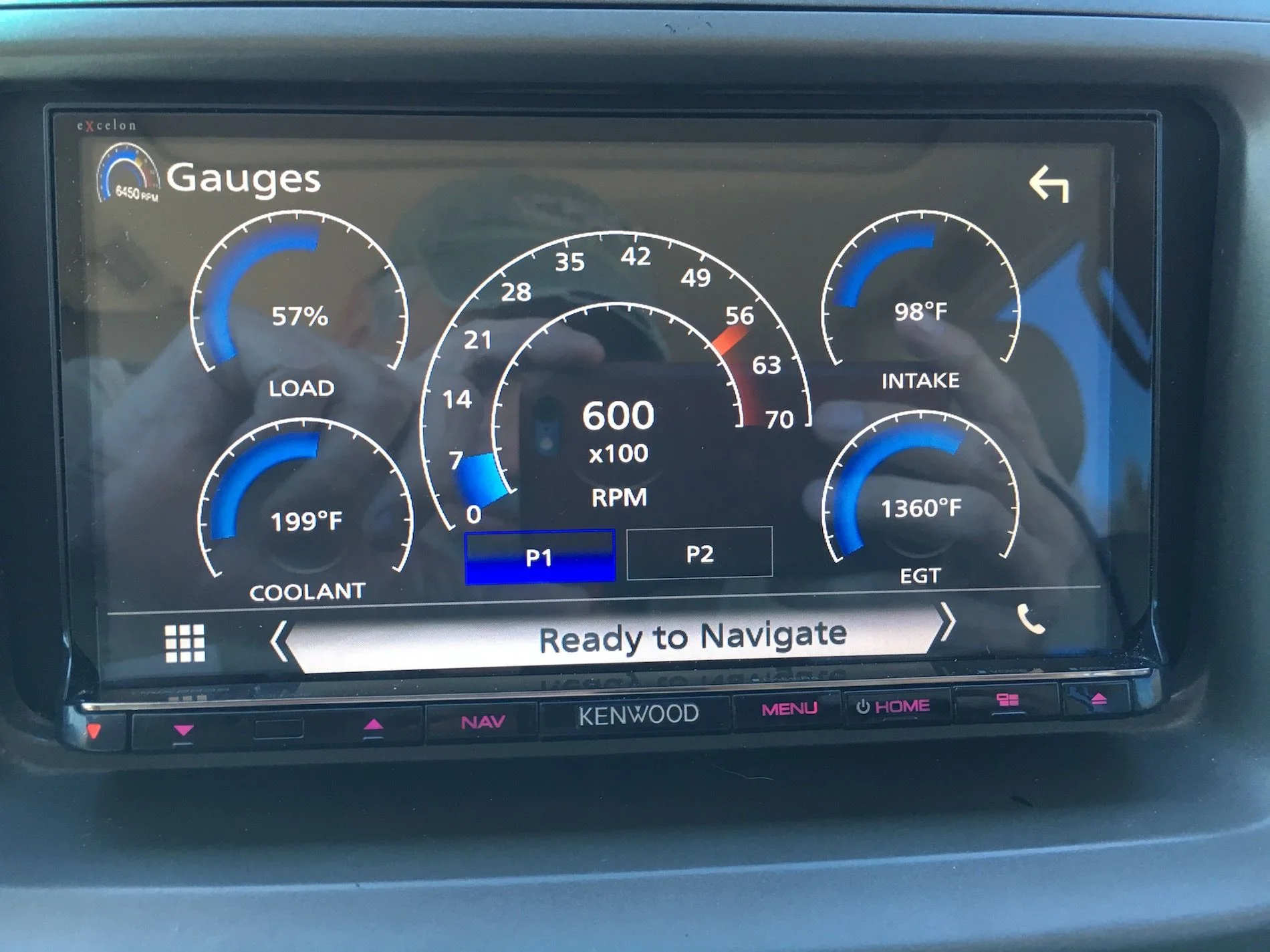

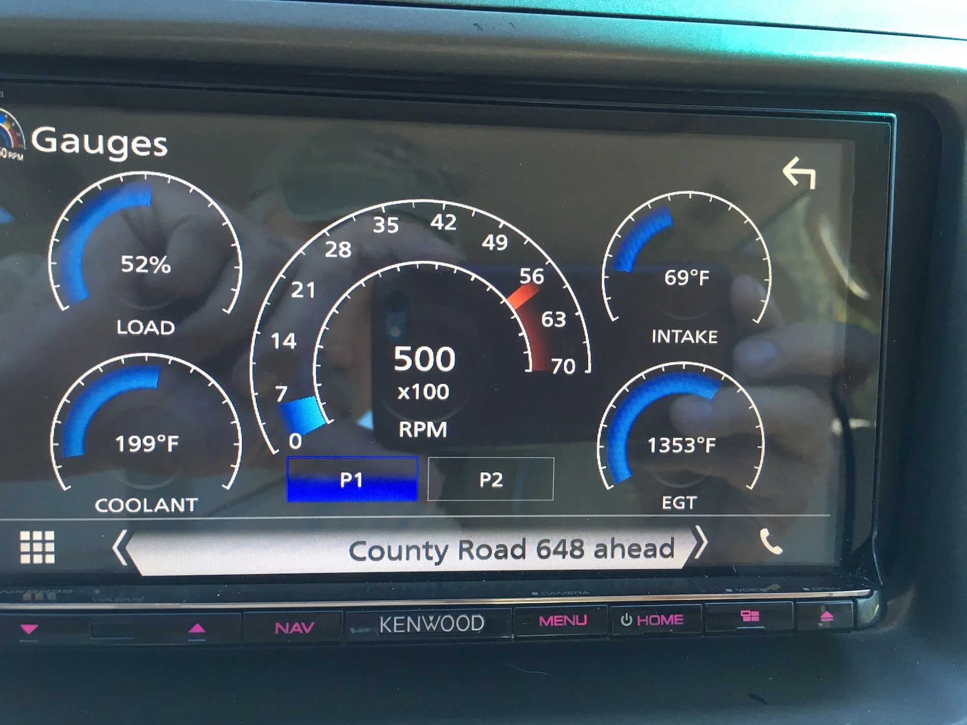

well it might not be too helpful, already getting cool here, started with a OAT of 68degs, when I started pulling the mountain grade at the chain up area, it was 65degs, at the top of the pass it was 55degs. From chain up area to top is 9 miles and a 3000ft climb, the speed ranged from 55-45-35-45mph and rpms where 2600-3000. The engine load was almost always in the 90-98% and the coolant temp was 194-199degs.

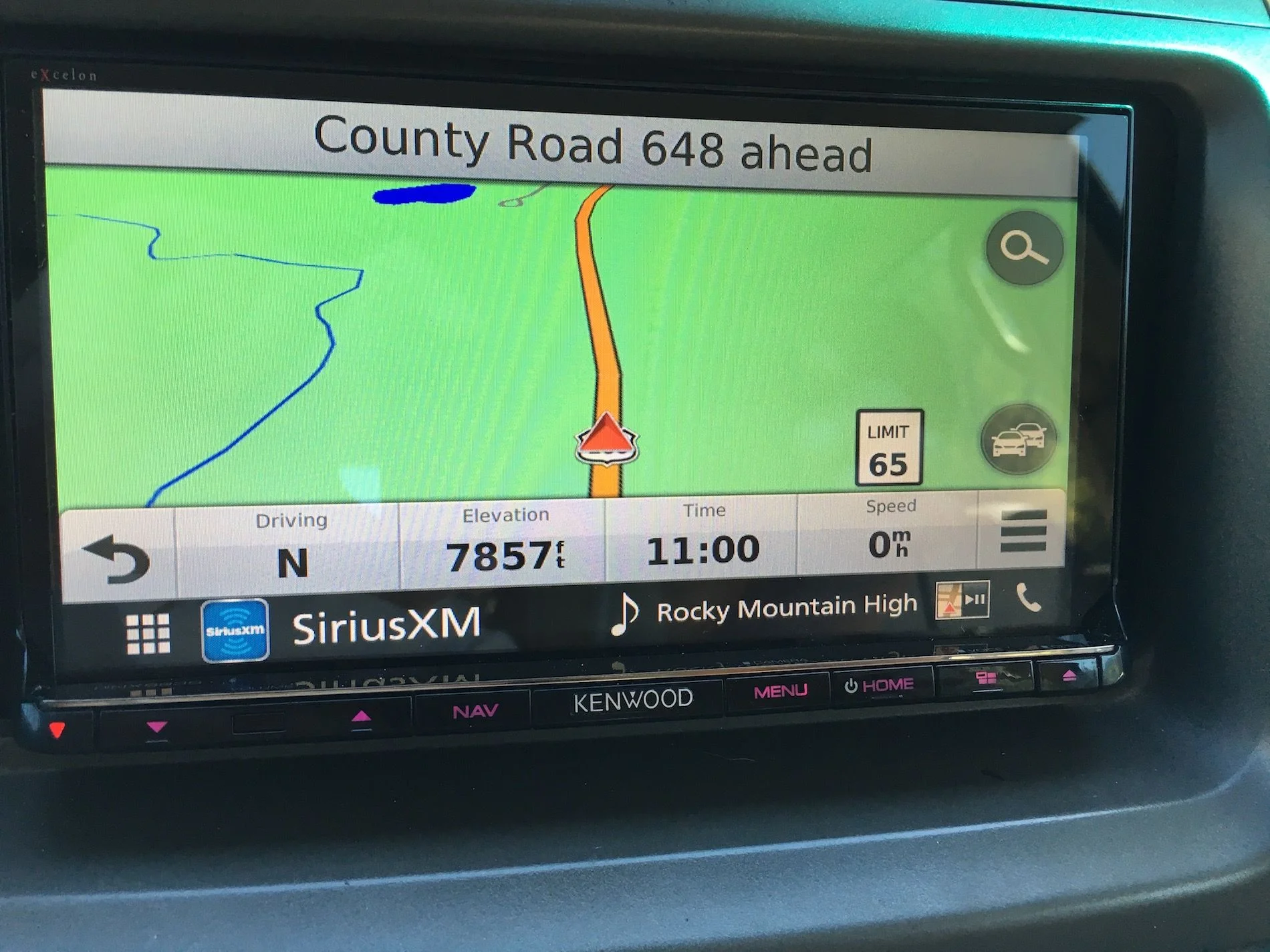

just before I started the climb, beautiful day in the mountains
stopped at the chain up area

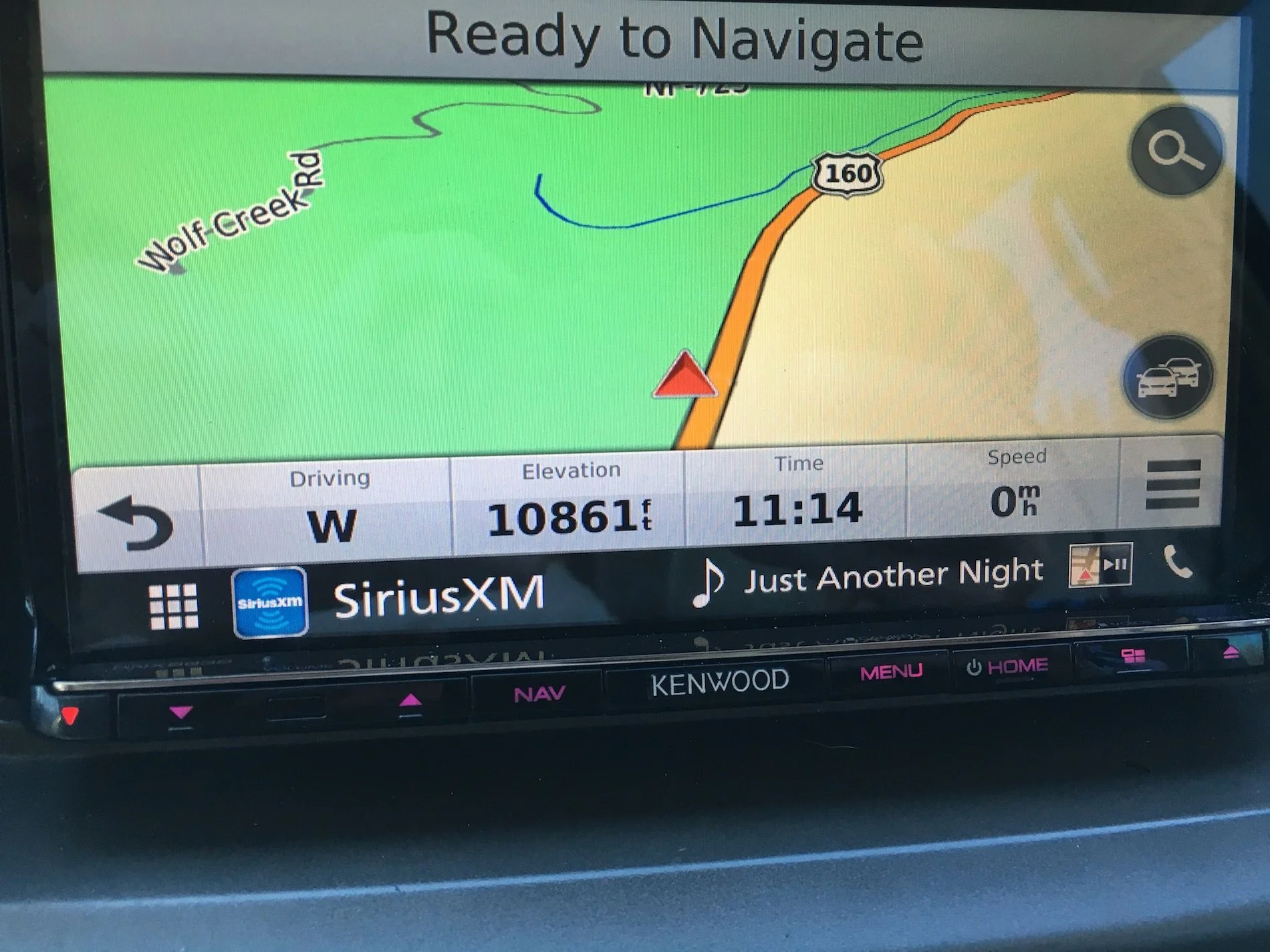

stopped the top of the mountain pass
