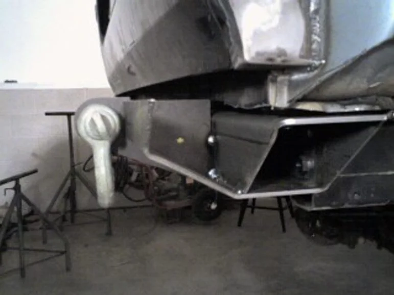

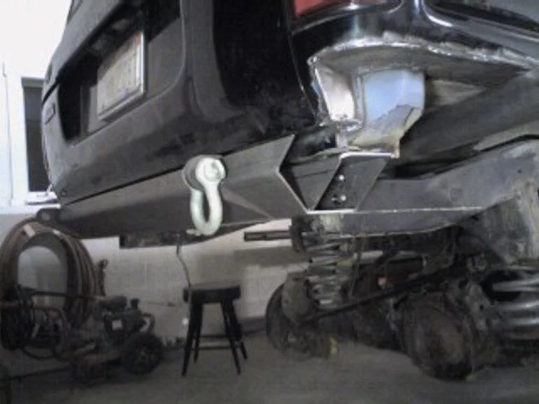

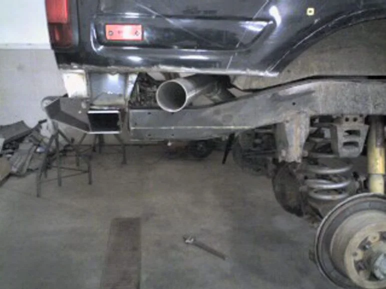

Here is my latest endevor on my 80. I ran my truck for a while without a bumper and thought of what would be ideal. I just couldn't keep my hands off the sawzall and cutoff wheel. I trimmed the lower portions of the body to route my exhaust up high and also to improve hanging up behind the rear tires. The frame has also been a source of hangup in the past so it was chopped up too. As more progress happens I will post em up. Kirk

Cool idea. A slash cut pipe coming out of an uncut quarter would be even cooler. :)
Does your tailgate not hit those tow points?

Very nice - going to wrap it around the sides or just leave it alone?
The tailgate has 3/8 inch air between the tow hooks.The sides are coming up at 45 deg angles and will fold into a 1" lip just below the taillight. From there a integrated pod of 1/4inch steel will protect the taillights. on top of this pod will be where the exo cage starts. The exhaust will be cut back inside the wing of the bumper and a stainless rectangular insert will be cut into the wing. The frame will be chopped at the yellow line and the new bottom plate of the frame rail will have 1" flanges to tie into the wings.
