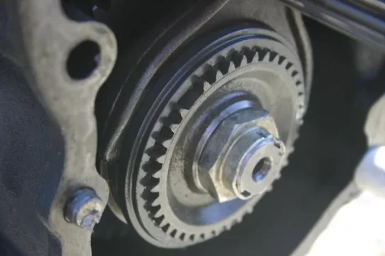

I can't tell if the 5th gear is worn, or if this is machined. It's not shiny looking, but the collar absolutely hits these "notches." Bending the shift fork won't let the collar slide any farther back, because of these "notches."
It also doesn't slide over the larger diameter splines, so I need to do some more research. It's either very, very worn, or hardly worn at all. Anyone know which it is?

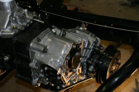

I got the T-case halves powder coated, so I just had to mock them up to store them.
The PTO cover plate had to be powder coated black, because somehow after the cleaning it just discolored somehow, kind of a dark grey color. And it wasn't going to match, it made more sense to make it obviously not match.
Got a replacement bearing ordered so that I can put the T-case back together, hopefully early next week.

hummm, interesting, i don't remember seeing any shift collar blocks on the gears i had but that looks factory to me.
now i will have to take a close look next time i tear into a H55.
thanks for the pics.
I know people say the 5 th gear pop out is from poor shift fork engagement. However, if I can remember back to my manual trans class it is the chamfer on the gear that helps keep the gears engaged. The gear tooth should have an old time coffin shape. At least that how we described them.

I'll write up a more detailed bit later on this, but I got the T-case back together today, with the parking brake on the split case. We must have bought one of the last kits SOR had for this, but it was really a no-brainer, since we were rebuilding the T-case anyhow...
Here's the main difference, you can see how much longer the parking brake rear output shaft is.
And at the end of the night...

Dan i notice you choose not to cad plate the parts that were originally cad plated -like the cap on the transfer that covers the end of the tranny input shaft. Is that because the cad plating doesn't last long (my experience) or???
We can't actually cad plate anything, apparently it's an EPA thing. Closest we can get is yellow zinc, which isn't bad, but definitely wears off (especially with a power washer). Besides that, I can powdercoat for dirt cheap, and for a part like the cover over the output shaft it takes me about 45 minutes from dirty to done and ready to install. To plate stuff we've got to get a big enough job together, drive ut into town, wait a few days, etc... Powder coating in my shop also guarantees I won't lose it, or forget how it goes.

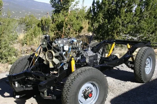

How about a nice shot of the whole chassis for my desktop background? You know, an inspirational type thing when I'm at work :cool:
looks awesome Dan!
Ask and you shall receive....

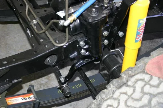

First off, the PS gearbox came back from http://westtexasoffroad.homestead.com/index.html, so I powdercoated the pitman arm, and installed the whole thing for good.
