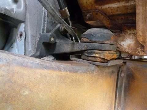

Moving right along, Im wondering if there was a sleeve over this at one point - or should I should keep it greased for now?
yes, you are missing the rubber boot you see on all of your tie rod ends, is the joint sloppy? You can buy the boot or a new rod end (with boot) it needed.

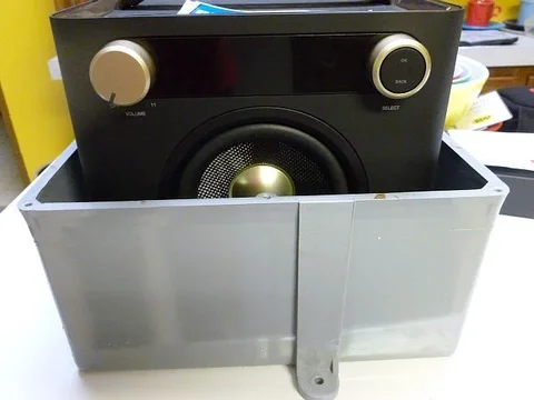

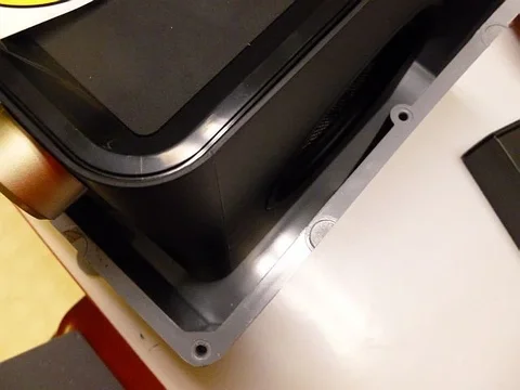

We went to Lowes with a very vague idea of what I wanted to do with the sound cube. Im proud to say my fix it all huz figured out the PERFECT solution for this sound cube to be mounted..
A junction box! We'll cut out half circles so the speakers arent muffled. The largest junction box is 12" squared, the cube is 9.8" squared. After he cuts out the circular pattern, Ill sand it for texture and then spray it with the same rubber protectant I use on the underside! The lid to the junction box can be fitted with long bolts to secure the top side (if needed). I have an extra otterbox holster which will easily clip to the side to prevent sliding.
A square section of that cheap foam matting you can get at Harbor Freight, cut to fit the inside and run up the sides should give enough cushion and barrier..how cool is that??

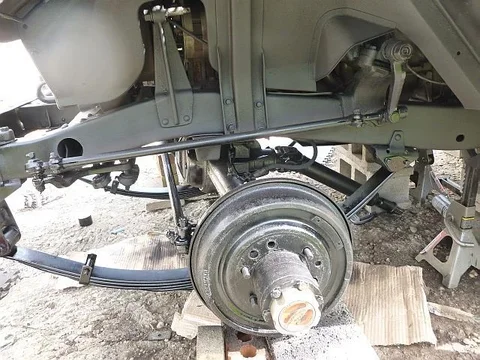

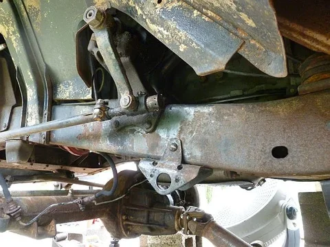

After a full day at work, came home threw on some work clothes and started cleaning up under the front half of the 40. I know how much everyone likes pics..so here's what I started with. Tomorrow youll get 'after' pics.
These are both from the driver side. You can see the floor pan looks pretty rusty - and from where I began on top side there are a couple of spots. I dont plan on paying it too much attention as I plan on replacing the floor pans in the next sixth months.
I fear this bushing looks okay...for now.

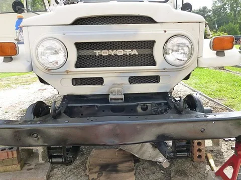

With a break in the clouds yesterday (its been raining consistently for the last week, we struck out to get the front half of the cleaned, sanded and coated as I did the rear a few pages ago. We're getting down to T-minus 2 weeks until I take my rig to my clubhouses' big event - a weekend of camping and wheeling in Uwharrie National Forest So after the suspension is complete, we'll be ready for that weekend!
My huz took it upon himself to work at the underspray, as I finished sanding and cleaning last evening so this is what I came home from work today to find -

Nice work! That paint looks fantastic... mine never looked that good, or that smooth.
One word of caution: I noticed the seperated front drive shaft hanging down. There is a specific way the driveshaft flanges are supposed to be phased. If you did not put match marks on the two pieces, you will, likely, reassemble them out of phase and get lots of vibration. This is most important in the rear where you spend 90% of yuor time in 2wd at speed.
I don't recall if the DS flange ears are supposed to be in phase or 90 degrees out of phase... I'm leaning toward the latter, but best to check the FSM and a search on here.
Also, are you missing a wheel stud on the left brake drum?
Nice work!
Thanks & Good call - the FSM I downloaded before I even owned one..(I like to be prepared:D) Match marks were something my huz suggested before we started on that...Dont tell him how right he is..he'll be unbearable :zilla:
I missed this question - damn youve got a good eye for detail! Wanna make a drive down south and help me out??!!
I picked up a wheel stud (plus an extra, just in case) from the local yota dealer. The huz is about to attach the new one. He's having issues on figuring this out. I told him there's a great forum full of info he might want to check out. :D
Boy, if we can find the time, I'd love to get a weekend in the fall to run the beaches down there. The last time I ran the OBX beaches was New Years 2001/2002 in the FJ40.
While I'm at it, those DS bolts look shiny in the before picture. Make sure they are the right size and the PO didn't throw some 1/4 grade 1 bolts in there. The slop will shear them right off and, depending on your speed, flip the rig and certainly destroy your T-case. Just passing the knowledge.
As far as the hub studs go, the edge of a strong work bench a 5lb hammer and a drift of some sort will get the job done. Tap, then pound in from the back side of the drum... I wonder why one was missing in the 1st place. If it goes in real easy, I suspect it was stripped and you may need a new drum.

Im probably going to slap myself in the head...but screw it - what are DS bolts?
Meanwhile..Ive got to go back outside and work on the stripped screw out (side project while I debate the input on shocks...it makes me happy doing body work, go figure!) BTW, it came stripped...I havent done it myself - YET!
Thanks for the patience and advice from everyone..Its got to be weird to have someone so "knowledge free" as I am ha ha..
DS= Drive Shaft. I noticed on the "before" picture of the backside of the front axle that the bolts on the driveshaft to axle pinion flange were shiny.

Great photos and story. I see jack stands, which are cool, but I also see cinder blocks and house brick.
While those could be used to support part of the axle weight for a suspension job, NEVER use brick as a primary vehicle support while working on the truck (especially cinder blocks on their side, as you have them arranged). I'm not trying to be a jerk here, I just want MUDders to be around so I can ask them questions in the future.

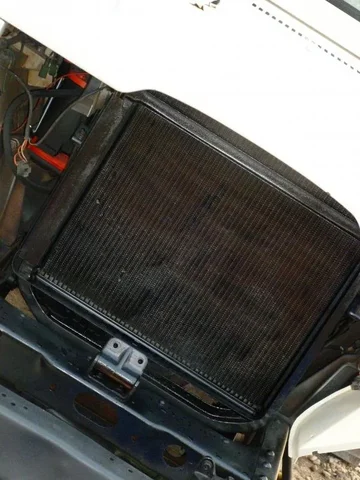

I have no doubt there's a workaround for the silly, probably overpriced and easily replaced piece..and its already been a long day. While waiting on shocks to finish the suspension off I noticed although the radiator is recently replaced, the part holding its anchored to is rough. I used my free time yesterday to remove the headlights, clean up the rusting light 'cups' and removed the bib..the black grill needed some love too - so what the hell..Here's the result - (give some love to the huz - he's the one who did the white enameling on the "toyota" piece!)

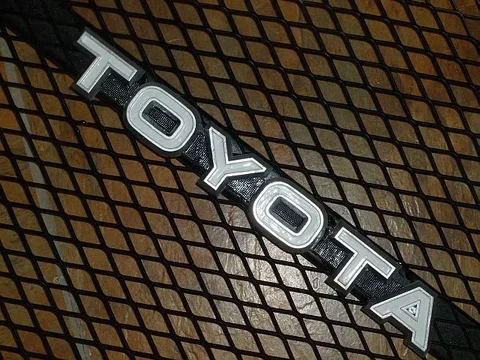

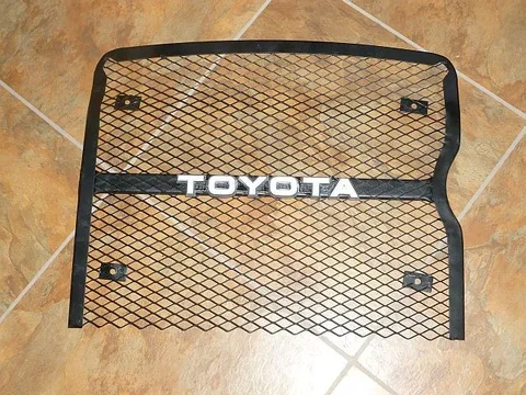

Here's the front end, just have to put the eyes back on - theyre currently drying. Went with a satin finish almond color. Flat Khaki is too dark for me - and I live next to a military base - so its not uncommon to see. I keep hearing how the dune beige is the signature color. The more I thought about it, the more I realized Ive never seen a dune beige jeep..which doubles my enthusiasm for continuing along the same vein in color. Ill probably never have a pro paint job done - as why would I drop that kind of cash for a vehicle I will scratch up...if Im using it for what it was 'born' for?! But thats my personal opinion..
The hood release will be colored black tomorrow.
The white bezel goes on, which I think will really make the white toyota 'pop'! What do you think?
