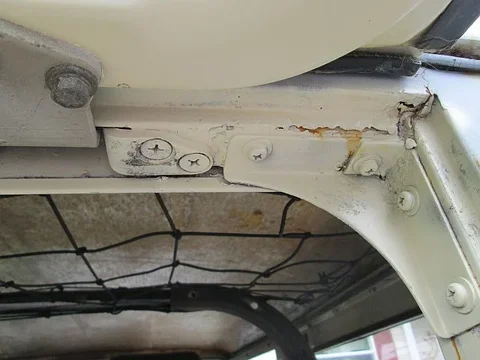

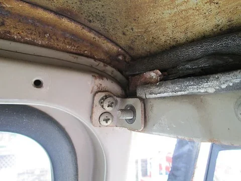

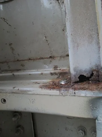

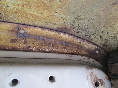

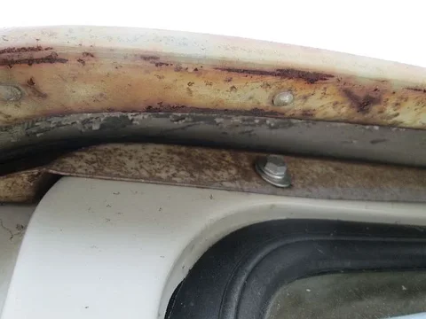

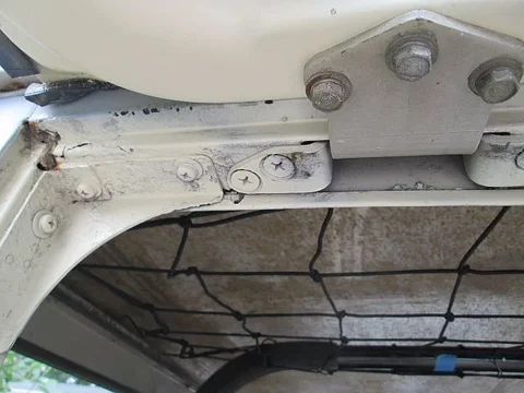

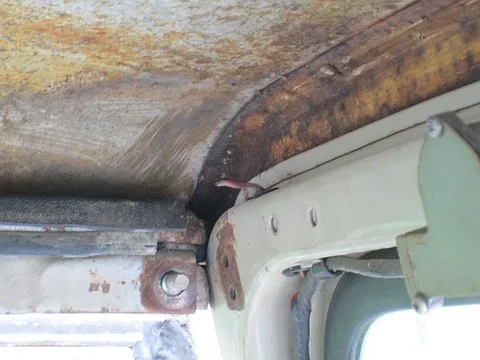

Well, starting the fiberglass cap removal was relatively easy...Until we got to the rear hatch. Here's what Ive got.
When we got to removing the corner gussets for the hatch - they aren't moving, EVER AGAIN.:D You can see from the interior shot that the rust is pretty serious on the inside - there is nothing left of the raingutter in the corners.
Ive got an extra set of gussets - should I just drill out the screws on the gussets?
Im at a bit of a crossroad. Im split between moving forward and restoring the hardtop, which is obviously in rough shape. More than likely based on what we've seen so far, that crossmember is probably toasted.
A new hatch crossmember $300+
Raingutter $300+
Ive got all the weatherstrip, paint, and hardware. I have so far enjoyed using my own two hands (and my huz's patience) to repair and fix things. Part of me says look for a hardtop in better shape. Part of me says do it right and then the logical economical side says - Im not doing a huge restoration, I bought it to drive it...but I.just.cant.leave.it.alone. I have to do these beast some justice and at least manage the damage already done but actively watch for replacement pieces.
advice? wanna see more pics?

PM 74HogGuy. He has a 74 top that he was looking to unload. He may have people lined up for it but it may be worth a shot.

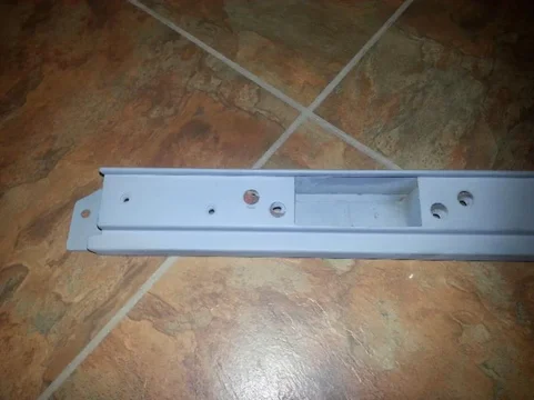

Got my replacement hatch crossmember today! Rain gutter has been ordered and a lil prodding from my club led me to an auto hobby shop on camp lejeune where I can get the welding done for the gutter and the patches in the corner window sections that rotted out. If the weather is nice, Saturday Ill drive her topless!

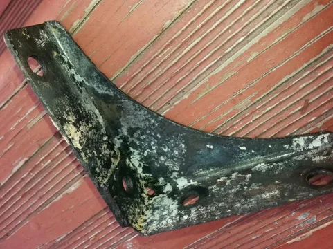

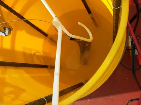

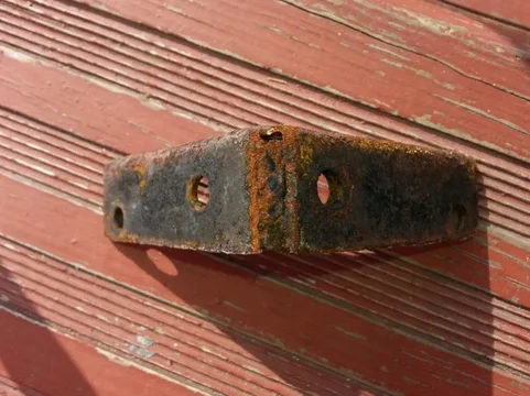

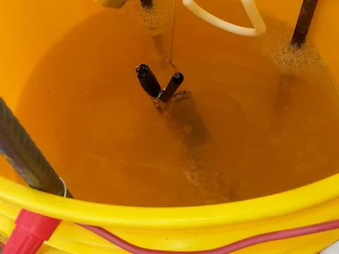

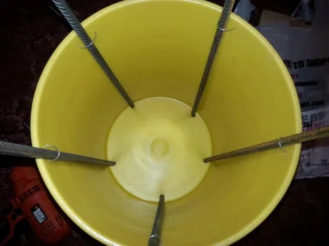

Well thanks to Vae Victus thread on his experimentation with electrolysis, Ive just dipped my first part in my bucket..Ive got bubbles, which tells me im doing it right..
Updates to follow!

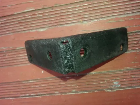

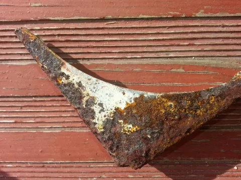

After one hour here are results..
First two are BEFORE

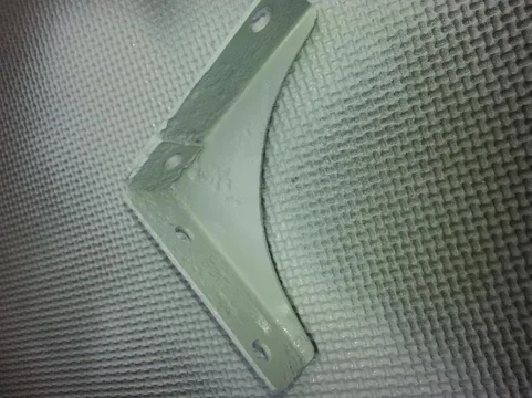

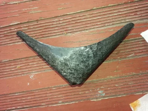

After one hour...wgen I pulled the bracket out all that crap wiped right off. Wow! I washed it dried it and primered it. Im gonna need a bigger tub ;-)
