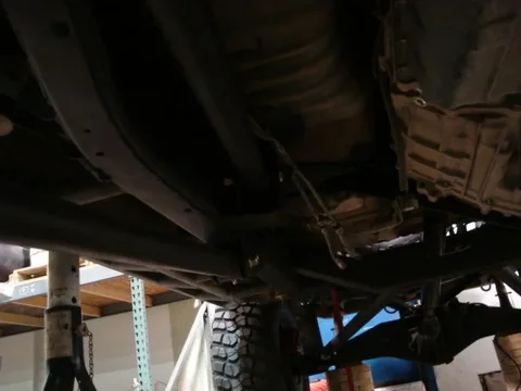

I also got the hydro assist cylinder tacked into place. It's a tight fit managing to clear everything and this is my first go around with the assist. If anyone sees anything wrong with the way I have it mounted please speaK up.

I had the same space issue. It took awhile to figure out the right location with the limited space availalbe
Its hard to tell from the picture but I think the current location of the ram will attract rocks.
Some how I try to move the drag link mount a bit higher

Qtipp, I'm pretty sure you're right about the rock magnet. I'll have to look again but I'm not sure it'll fit anywhere else. I was thinking I would build a guard out of some tube, possibly with a piece of plate to act as a skid. I've seen some pretty nice setups done that way. Thanks for the input.

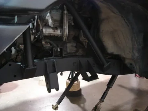

I've been avoiding the front coilover hoops and finally forced myself to give them some attention. Sure enough it was a pain measuring and re-measuring, and then tacking them in only to hammer them back off again. They didn't win in the end though. I painted the upper portion that will be hard to get installed and left the bottum bare to facilitate welding them onto the frame. I'm going to gusset them once they're burned in as well. The tabs on the closer one are for mounting the factory fuse box back in it's original location. The 4Runner had a tank mounted in the driver side fender well to hold extra vaccum. Has anyone heard of using something like the welded up shock hoop instead? Kind of like Marlins' roll bar/air tank but opposite?
R u going to run a removable (flanges) bar from hoop to hoop to minimize the flex?
Just wondering. I noticed you had already painted the top of the hoops and once they are burned in you might have a hell of a time preping the metal for the support bar.
I am no expert in the matter but I think you need one.
Just an idea
I am still undecided on that one... I have given it alot of thought. At this point I was planning to patter out some plate to weld on either side of the hoop tubes (four per side) to fill in the void and gusset the hoop beween its' mounting point of the side of the frame, top of frame and hoop uprights. That is why I didn't paint all the way down to the frame mounts. I'm thinking I'll try it like this for a while and see. If it's still not stiff enough then it will be on to hand sanding.:o I'm kind of going after the design of the coilover hoops that Offroad Solutions used to make when they were in business. That said they also offered a support brace as an option. Qtipp, do you have any thoughts on using the welded up hoop as a vaccum canister?
I have been thinking about it.
On one hand it is a great space savor on the other hand you might be setting yourself up for some issues.
If I were you I would put the hours into it and see how it goes.
Worst case scenerio it doesnt work and you go another direction.
Give us updates

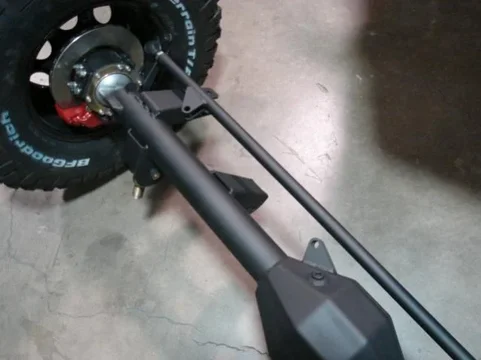

Thanks. Here's a picture of the front upper frame link mount. Sorry it's pretty dark. The mount is a 22.5* inner frame mount from Ballistic that I shaved down to about 15*.

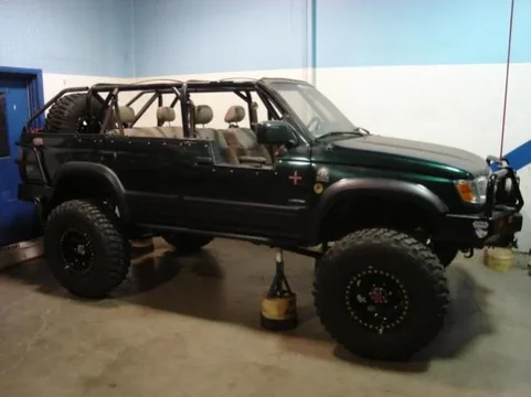

I put driver seat back in and the tires on for weighing this afternoon. I have a friend with racing scales that's going to help me so that coilovers can be ordered Monday. I am planning to go with 16" Fox all corners. Any opinions?

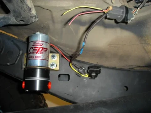

I wired the Mallory fuel pump using the factory fuel pump harness. No word as to whether or not it works though. I'll have to wait untill tomorrow when I can have someone turn the engine over while I'm under the truck to see if it turns on.

Thanks for the great pic, it helps alot. I found a build thread very similar to yours when I was doing my research and here is a quote from his build
"The 14" SAW coil-overs are pretty big. Had I done it over again, I would have picked up 12" coil-overs right away".
I have no experience with coilovers but it looked like his were too tall. The build thread is here Hunt4Steve.Com , you may have seen it already.
Thanks again​
Glad the pic helps mmml4. I am familiar with Steves' site and have found some pretty helpful info there. I think the reason he would have gotten 12" coilovers is that he didn't cut into the fenders and build his hoops up into the engine bay. I went the other way and cut out more fender than I needed to :mad:... but I should be able to fit 16s well. At full stuff (articulated) I measure about 25" from hoop eye to where I'm mounting on the axle. I'm pretty sure Fox 16" coilovers are 24.1 collapsed and 40.1 extended. I was happy to chop the fender wells to accomodate the extra travel. Post up some pictures of you progress if you get a chance; I hope it's going well.

I finished the bracing plates for the front coilover hoops and burned everything in. Primer and paint followed. This is how I'll run the hoops for a while and see whether or not I'll need to tie the two together over the engine.

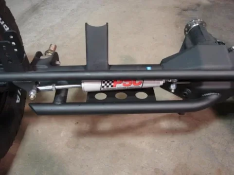

I burned in the hydro ram mounts as well and now have to fab up a guard to protect it's vunerable location.
This is the guard I built for the hydro ram. Tube is .25 x 1.75 DOM and the skid is 3/16" plate. No those are not dimpled holes. I only wish I had a set of dimple dies.

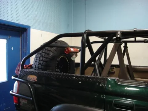

I acomplished quite a bit this weekend. I got the front axle re-installed (again!), hopefully for the last time. I finished the rear cage extension over the "bed" and finished plumming the fuel system. I had one leak in the system and what do you know, it wasn't something I did. One of the bulkheads on the fuel sump leaked badly and it ate up some time fixing it. I took a little gas from my old tank and yes the engine came to life!:clap: Rear brake calipers finally got mounted and a few other things that have been bothering me got cleaned up.

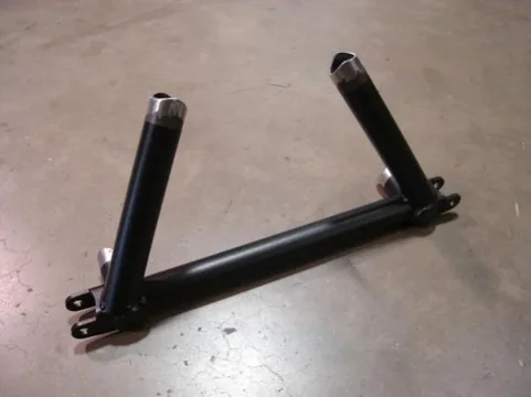

This weekend I built the truss for mounting the coilovers in the rear. Here it is ready to be burned in.
And installed. It is setup for 16" coilovers, same as the front.
I thought I'd include a picture of how the back hoops turned out too.
