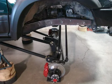

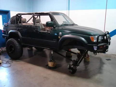

I was able to get some testing done on the front end tonight. Despite my reservations it looks as though this thing is going to flex nicey.;)
I ran both sides up to full stuff and cycled the steering both ways without finding any binding or contact issues. Almost ready to start burning it all in!

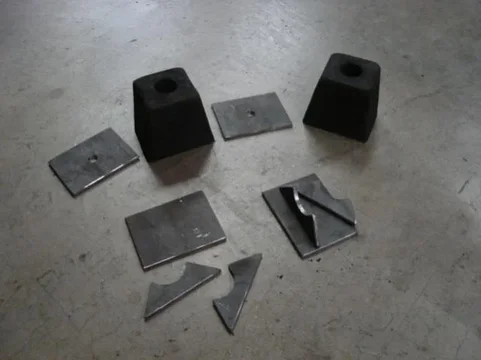

I started working on the front bump stops tonight. I made my own out of some SBR rubber left over from an expansion joint I made for a bridge. If it proves to be too hard I'll be able to swap in some urethane ones from Energy. I wish I could afford air bumps but at this point they are out of the question. These will weld to the frame and the plates will weld on to the lower links close to the axle.
