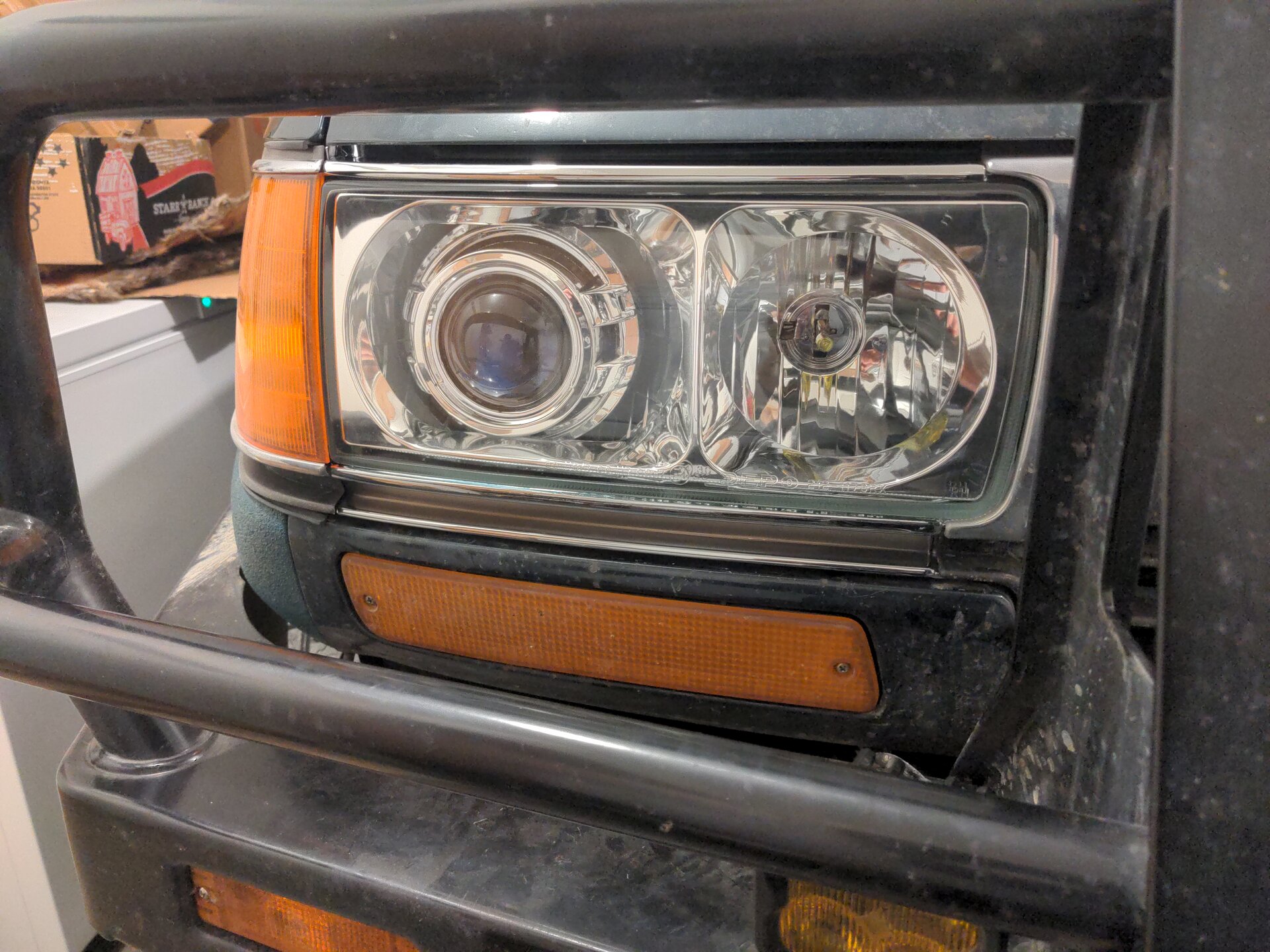

Depo's + bi-xenon projector retrofit is legit.
I did quad, bi-xenon thinking (more light = more good) but I literally haven't used the bi-xenon's in the high beam location. It was a PITA to get them to fit (required cutting reflector and epoxy) and wasn't worth the effort. You can throw some bright ass halogens in there.
Retrofit Source usually does a Black Friday sale (I think it was like 20% off)
I just finished my depo + bi-xenon retrofit yesterday. The difference is truly incredible. I should have done it ages ago. I highly recommend it.
