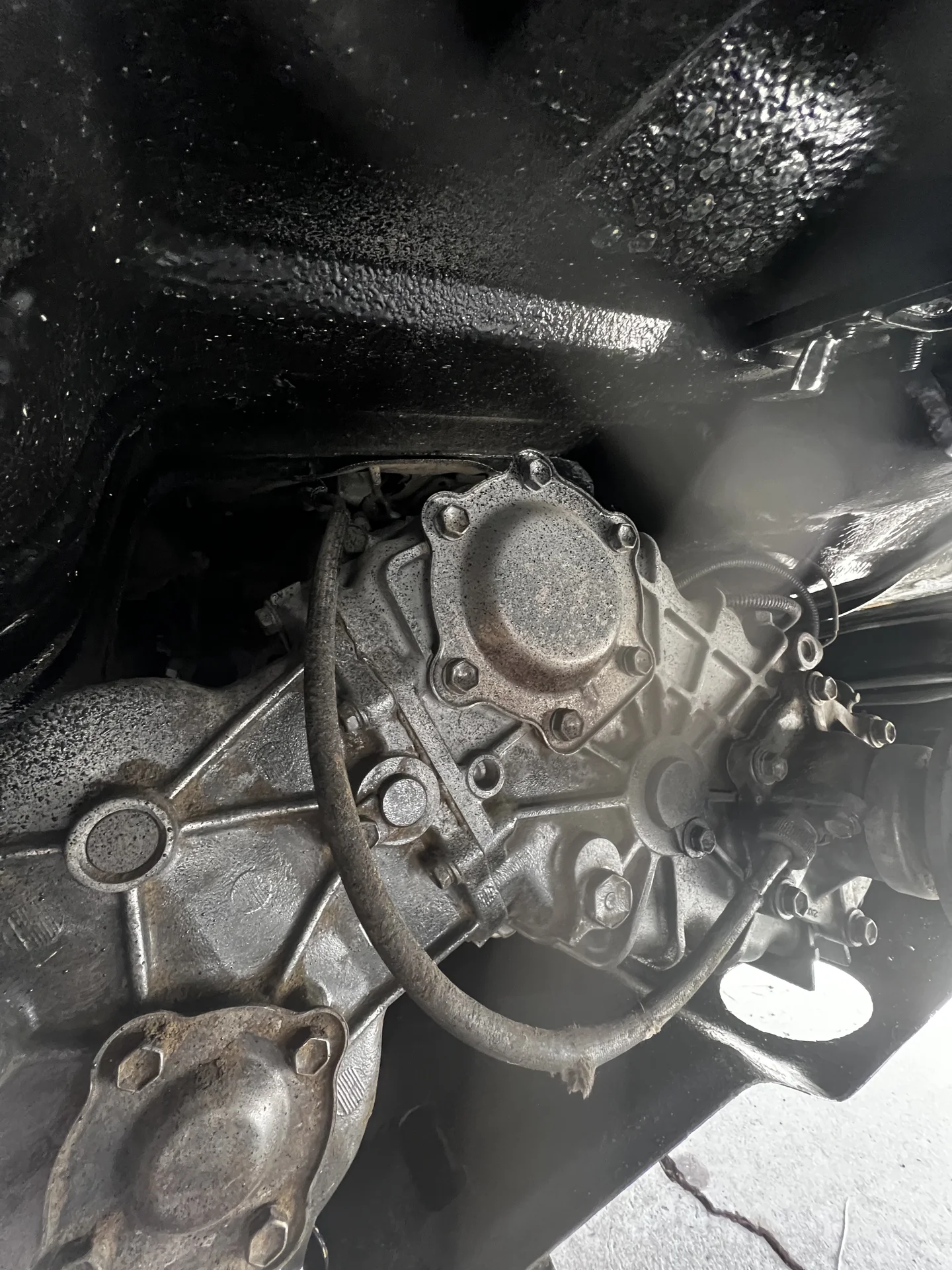

I could be wrong about this—I have little to no experience with transmissions/xfer cases, but I believe it has the equalizer hose installed. Would that mean that the oils could mix, or am I misunderstanding (or misidentifying) the purpose of this hose?
I could be wrong about this—I have little to no experience with transmissions/xfer cases, but I believe it has the equalizer hose installed. Would that mean that the oils could mix, or am I misunderstanding (or misidentifying) the purpose of this hose?View attachment 3277785
That's the speedometer cable. You don't have an equalizer hose, if you did it would be plugged into the fill plug on t-case and run up to the fill plug in the transmission.

One fairly quick thing I'd check before pulling it is to remove the 6-bolt cover on the back of the transfercase (near top of transfer in your pic in post 6) and make sure the stake nut behind it hasn't backed off.
I've seen once where the mainshaft on a H55F walked forward, binding with the input shaft. That made the transmission act like it was constantly partially engaging 4th (ie one-to-one). In that case the threaded tail of the mainshaft shaft had been cut off to suit a doubler and there was nothing but a friction fit holding the shaft from walking forward under load.
Failing that, my money is on an issue with the countershaft as @cruisermatt suggests.
