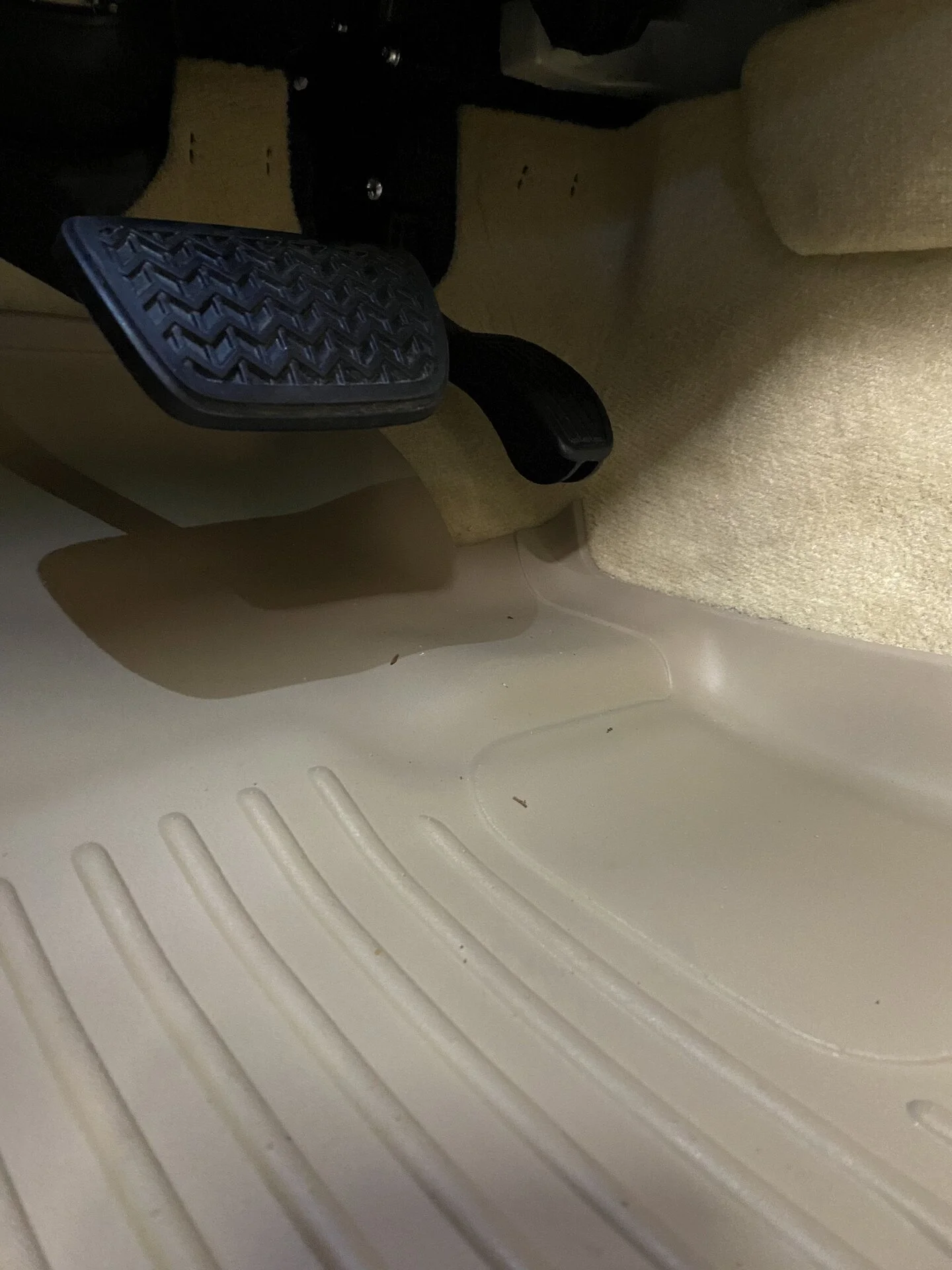

I'm in Red River, NM with my family. LX has been great all week, supposed to leave today. LX was fine this morning for a quick errand, then a couple hours later I get in and start it up and it immediately jumps to 5000 RPM. When I shift to D it drops to normal for a moment, then shoots up again. I have to mash the brakes all the way to the floor to keep the vehicle from moving.
No idea what would have caused it.
Any thoughts? I'm desperate!

OMG.
Thank you MUD and I’m a moron.
Took my Husky floor mat out to clean it and apparently when I put it back in I covered the pedal.
So I’m a moron, but thankfully an easy and cheap fix. I’ll take the egg on my face.

I cut out the section of my husky mat under the gas pedal. It actually interferes with the pivot point of the gas pedal.. YMMV

I find it interesting the brake pressed hard does not shut the electronic controlled throttle down. I thought Toyota tweaked the ECU code on their vehicles for such situation in the ECU, after all their floor mat issues back then. Either LC200 is just too old or it's a high performance car that lets you mash both pedals however you want.
